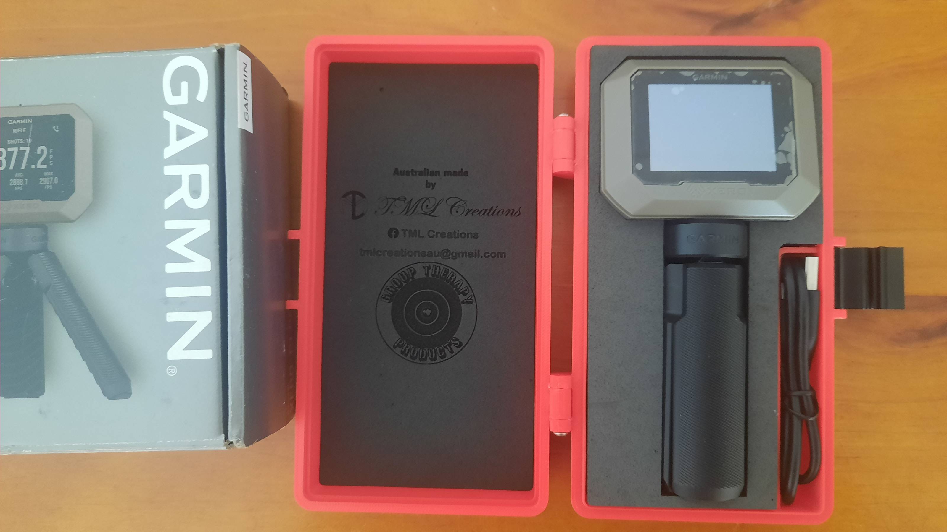

PS The pic below shows the unit in a protective box 3D printed by Tim Lane and retails for $30 plus postage. He can be found on ozfclass.

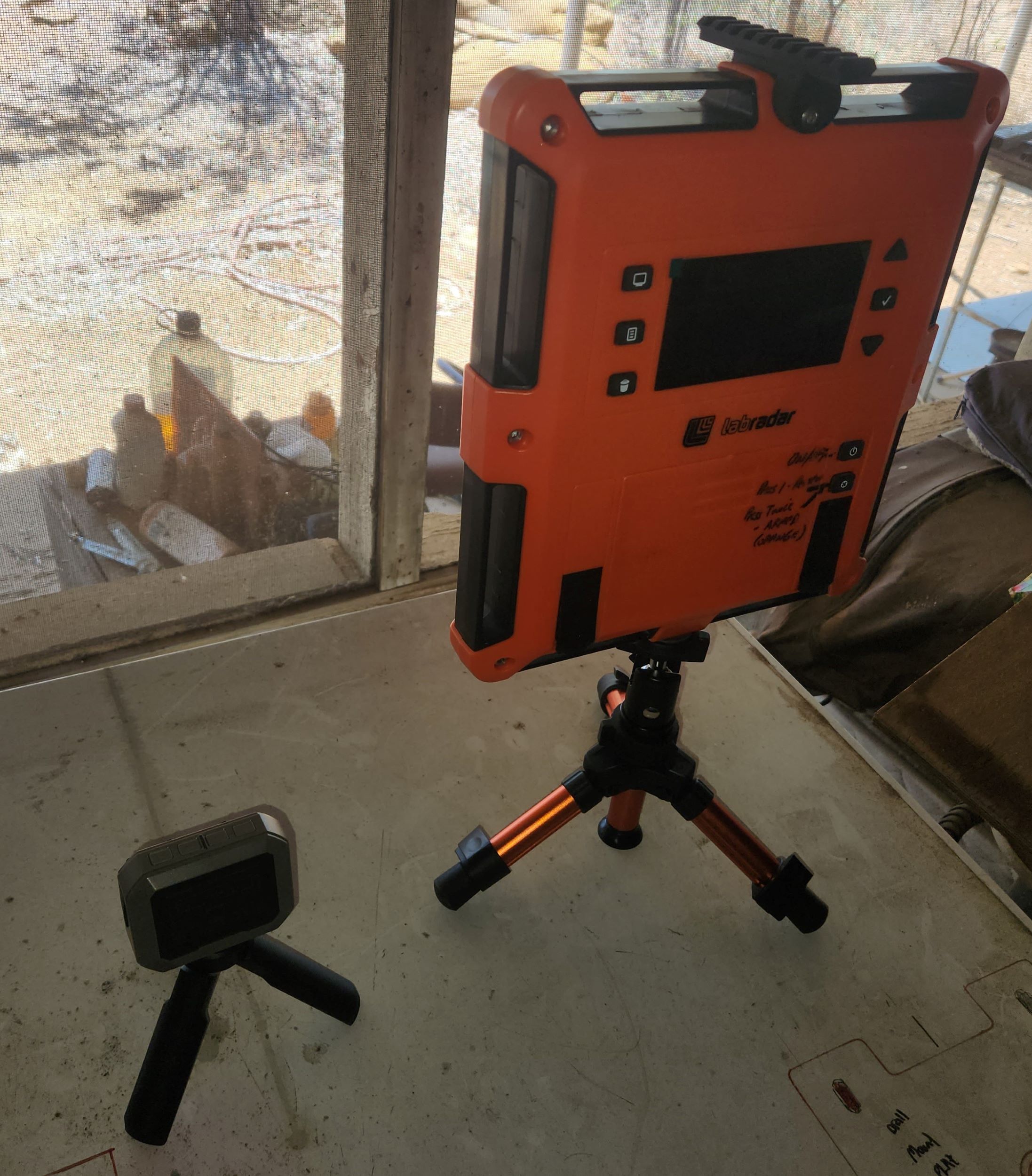

Took the plunge and bought one of these units last week; Garmin C1 Xero Chronograph.
It is TINY!
Unit itself would barely be larger than a cigarette pack; the tripod probably takes up as much volume as the chrono itself.
Total of 4 buttons on it; doesnt take long to work your way through the menus, even if you dont bother to read the book in detail.
Flashed it up for the first time yesterday arvo, while running the waters.
Put a set of 10 rounds through the .22 handgun, and then another session where I put 5 rounds from the .223 rifle through it.
Firstly, the unit was simple to operate, and read EVERY shot from each session.
The [POXED!!] LabRadar I had previously, was much more Hit & Miss as to whether it would record a complete session without errors.
The small size of the Garmin meant it was simple to prep and use.
[I just keep mine in a spare handgun soft-case, which is about 2 times too large for it, but protects it fine.]
Secondly, in comparison to LabRadar, the Garmin only records the MV, and if you have dialed in the bullet weight, will also give you KE and Power factor readings.
LabRadar used to record up to 5 readings(Think it was out to 100 metres?), so a bit more info recorded there.
But to be honest, I'm only really looking for the MV, and none of my previous chronos ever recorded anything more than the MV, so no real loss(to me at least).
Thirdly, the extracting of the data from the Garmin, is more fiddly than what the LabRadar offered.
If you dont want to pair it with a phone, you need a conversion program to convert .FIT files to .CSV files, which can then be imported into a spreadsheet.
Garmin make a conversion tool, but have made it in Java, which has been losing support for some years, for a range of reasons(security being one?).
Also, Garmin have made the pairing of the phone to be way too fiddly for what should be much more simple and streamlined.
It uses Bluetooth, but it's not a standard Bluetooth protocol, and so MUST have the 'ShotView' app to act as the interface.
And there is a defined sequence as to how you pair them up, and it will sit there pairing forever, if you havent confirmed the 'Create Account' email.
[Learned this last one the hard way last night...Sigh]
Thats a rather clunky solution.
And now, I find that it seems any sessions that were conducted without having the phone paired beforehand, arent visible by the app(suggests it needs to sync them real-time), and so cant be downloaded via the app.
I'm yet to try out the Garmin since I figured out the pairing setup, but I'll be surprised if it doesnt work, and save copies of sessions onto my phone.
I cannot see why the downloading of sessions cannot be something I can simply drag & drop when I connect the USB cable to my laptop, OR by a Bluetooth file-transfer app.
Now, I havent installed the Java app, but it looks like it might allow for files to be converted to .CSV format, which can then be imported into a spreadsheet.
But why this clunky data transfer??
For all it's faults(and there are MANY), the LabRadar data is stored on a removable SD card, and it easily imported into any spreadsheet.
NO idea why Garmin couldnt do similar.
So, I see a number of people have developed conversion apps, but I see they are all running Java, so effectively a variant of what the Garmin SDK offered.
There should be a lot more user-friendly option than this.
I like this chrono, and if I can streamline the process of extracting data from it, I'll be using it a lot over the next few months.
And the size and simplicity of using it, is great.
But Garmin could have done a LOT better, for not a lot of effort on their behalf.
My 2 cents.

Anyway; my frustrations have become somewhat irrelevant; found an online tool that does the conversion, and spits it back in a similar format to my LabRadar files, so all good.

I have found one issue with the Xero. It is too light. A mate with a 375 Ruger was doing some load testing on the weekend. No matter where we placed the Xero the blast would blow it off the bench. No damage done as it fell on grass but most ranges are concrete floors.
