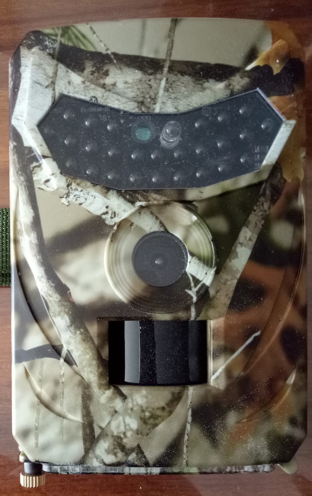

Sooo, a few weeks ago I purchased a cheap Game Trail Camera. Here it is.
52 Dollar Game Trail camera.jpg (272.92 KiB) Viewed 9453 times
So thought I'd let you know what I think of it. Not the greatest BUT will do the job if your tight with money like me. Here is a typical pic after I left it in the bush for about 2 weeks. As you can see colour and picture quality leaves a fair bit to be desired. But to be fair you can see the animals fairly clearly so it will identify whats around but forget high quality images.Notice one is having a sniff. :lol:
