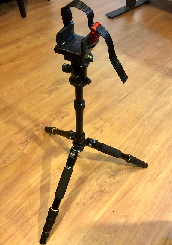

Budget Tripod build. Can tie onto the tripod or just use as a rest, also folds down for easy fitting in a daypack
Folding tripod from ebay- > 'Zomei Q666'
2x Carinya bracket to suit the size of your stock -> https://www.bunnings.com.au/our-range/brands/c/carinya
*Combine the brackets, drill a hold in the brackets and use a nut to attach them to the tripod mount
Small nylon tie down
Those foam mats from bunnings to cut up as padding
Duct tape (essential)

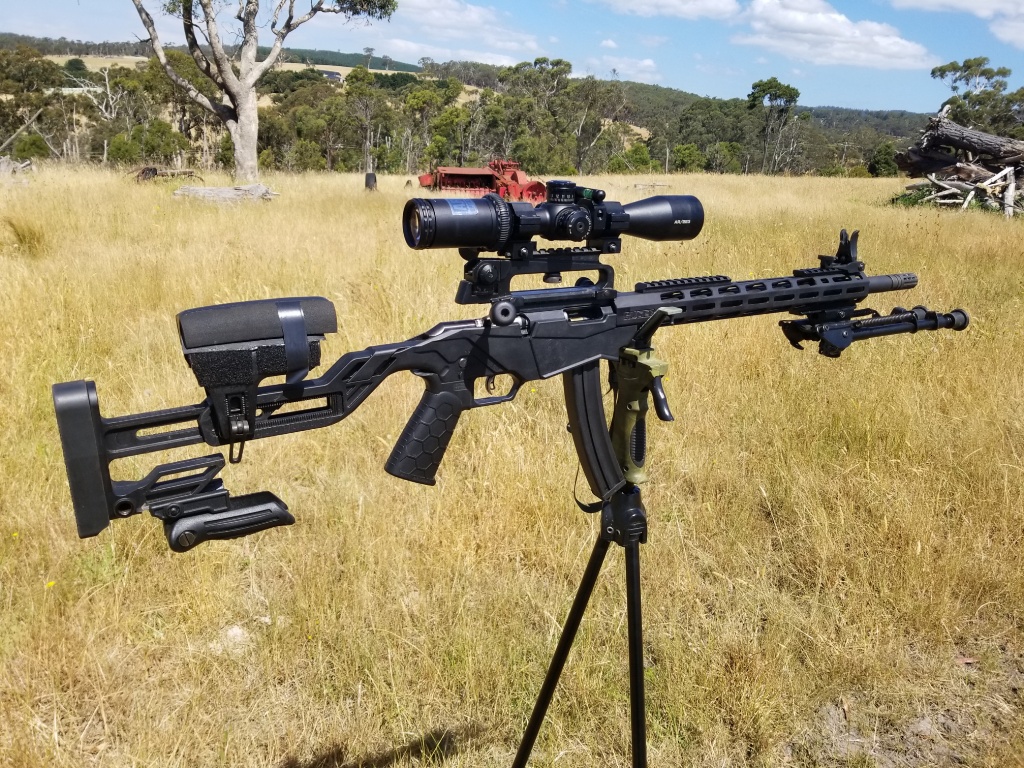

I did get out today to play with it and shot some video, but I'm no videographer and don't think it's worth uploading anywhere. To get the whole tripod in shot, means shooting from some distance, but the tripod isn't bulky enough to show up well.
I walked toward the camera from 150m, stopping at around 135m, 100m, 75m and 50m to take three shots at a 150mm gong, standing using the trigger stick, then the plan was to repeat it shooting offhand and see if there is a difference in either the time or the accuracy. There is certainly an improvement in the accuracy as I generally can't put every shot on the 150mm gong offhand from 134m, which was easy from the tripod, even with today's 6-minute wind hold. I'm quite sure the tripod makes it very significantly quicker too, but will require more testing (I have probably fired no more than a dozen rounds using this thing in the five years or so that I've had it, I don't consider it worth lugging around as I prefer to use natural supports in the field). You are essentially taking an offhand sight picture before deploying the tripod, but once the rifle is supported I can get the shot off within a few seconds easily, an unsupported offhand shot can take a lot longer to settle, especially at longer distances.
I also wanted to show how easily you can crouch into a supported shot with it. But I fired 50rds then came down the house to review the footage, decided it wasn't suitable, then got distracted with tractor maintenance :-)
Depending on the rifle, you might find that it sits atop the tripod just fine, as I found with the RPR with the 25rd magazines. The rifle is not attached to the tripod at all, if I had to immediately run to my target I can simply let go of the tripod and it'll fall to the ground.
I might have another go sometime, but with a cameraperson moving with me.

If I'm brutally honest with myself this will probably suit just fine 90% of the times I will use it. I generally run with makeshift rests if I go afield but I think this will really help in a couple of spots.
I am a fan of the design, it just doesn't suit how I hunt and shoot. As I said earlier, I hunt foxes in daylight so I stay in the shadows of treelines and fencelines, where there are plenty of convenient rests for shooting from. I do have to cross open paddocks of hundreds of meters of grass to get to tree lines, and I occasionally shoot from out there, but a 24" bipod is usually sufficient if I'm doing things right. If I screw up and find myself standing in waist-high grass with foxes cavorting around just outside comfortable offhand range then I just have to wear it and do better next time :-)
This is also far less heavy and bulky than my tripod, and my tripod doesn't automatically adjust it's legs to different lengths to suit the terrain, this does. If you're walking through high grass you already stand out, you can't be bouncing around setting a tripod up for a shot, you need to stop, slowly raise the rifle, and take the shot, which this allows you to do. And it works will the single-point sling, so I don't even have to unsling the rifle.
