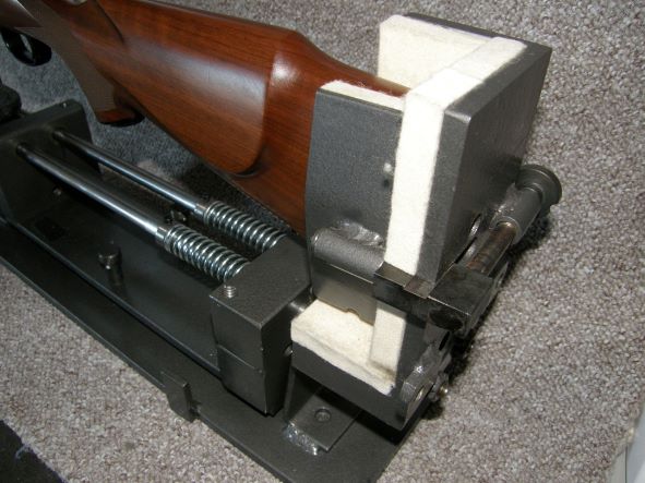

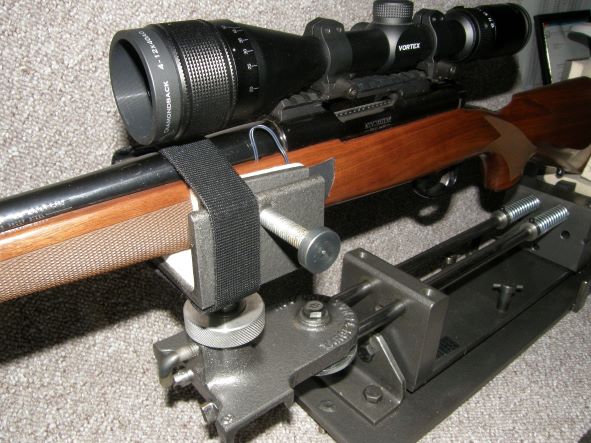

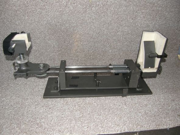

Post by niteowl » 15 Jul 2022, 12:13 pm
rest 6a cut.jpg (72.02 KiB) Viewed 3133 times
rest 5a cut.jpg (52.98 KiB) Viewed 3133 times
rest 3 a cut.jpg (61.46 KiB) Viewed 3133 times
You need to be aware that the "zero" you get may not be the same as when you actually use the firearm because of the way you hold it when in use. This works for me but not exact when my son shoots it.
Been modified a bit since the pics. Now has balanced springs, ie Springs both ways.
niteowl
