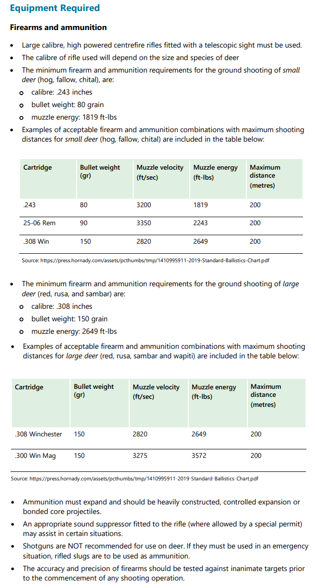

NSW have the following CoP which starts to cover velocity and energy, for Sambar it starts at a minimum of;
- Calibre: .308
- Bullet Weight: 150gr
- Muzzle Energy: 2649 ft-lbs
NSW Code of Practice and Standard Operating Procedures for the Effective and Humane Management of Feral Deer.png
NSW Code of Practice and Standard Operating Procedures for the Effective and Humane Management of Feral Deer.png (193.8 KiB) Viewed 15465 times
That's a good guide.

The NSW chart, on the other hand, takes a more practical, common sense approach, going further to eliminate these inconsistencies.
It doesn't need to mention firearm or any other device. If a firearm is not the most humane way to kill the animal then don't use one, it is then use the right one.
The NEW chart as far as I was aware is not a Code of Practice or legislation, it was just a recommendation last time I looked at it.
Which state?
Re: Minimum caliber for Samba in Victoria
Post by stihl88 » 27 Feb 2025, 3:15 pm
stihl88 wrote:You mean the the POCTA Act? It doesn't mention an iota of the word firearm or anything related to it.
It's objective is to provide for procedures conducted on animals, devices used on animals, implements and methods of capture of animals, transport of animals, restraint of animals and other related matters; and doesn't clear up the anomolies or questions posed by the OP.
Yes, the simple answer is shoot them with whatever the table allows for and you will be legally clear, your consience might not be.
It is a CoP "NSW Code of Practice and Standard Operating Procedures for the Effective and Humane Management of Feral Deer"

The Victorian one is regulated. The set of tables/chart is only how the GMA present it so it's easy to understand.
Post by stihl88 » 27 Feb 2025, 3:22 pm
Oldbloke wrote:The Victorian one is regulated. The set of tables/chart is only how the GMA present it so it's easy to understand.
The GMA simply refer to it from the Wildlife Game Regs 2012.

I wonder when that changed, must be recent.
