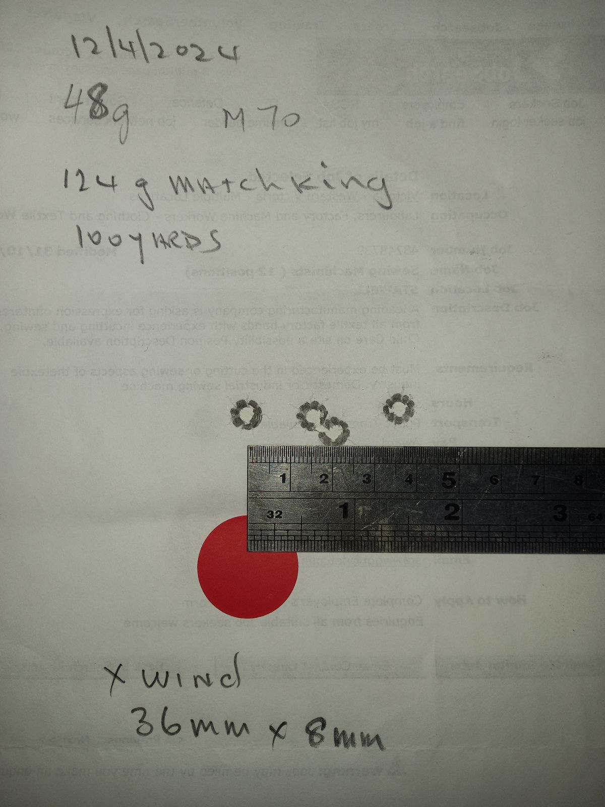

I went to the range today to test some reloads
My old Win M70
30.06
125g matching. (Modified, tip filed off. Now 124g)
3100fps (aprox)
100yards
Wind Willy weather tells me. 18 to 25kph 90deg R to L
Obviously the group is spread out left to right.
My question to the more experienced here is.
How much of that might be due to the cross wind.
I know its a bag of snakes but best guess gents.
I'm thinking perhaps the group might have been closer to 18x25mm if it was calm??

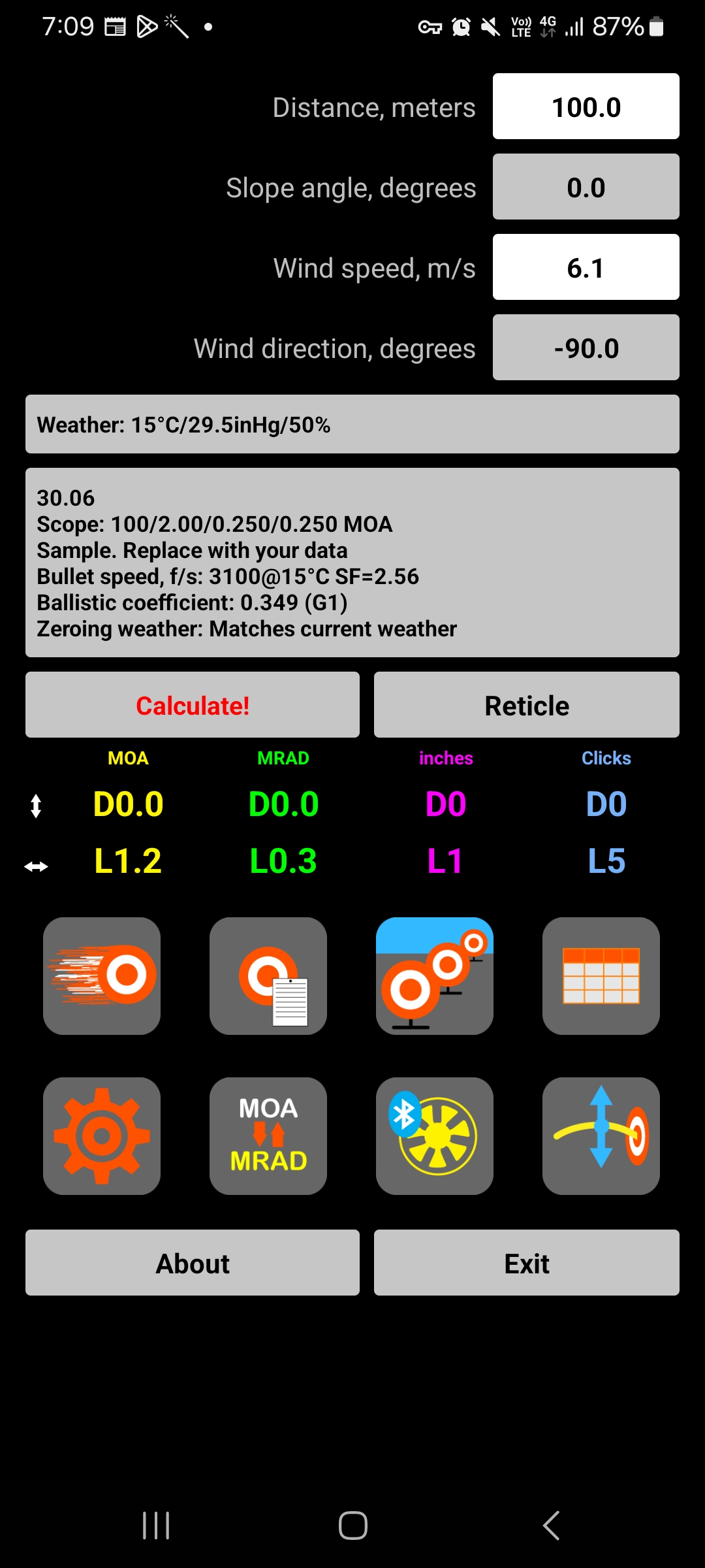

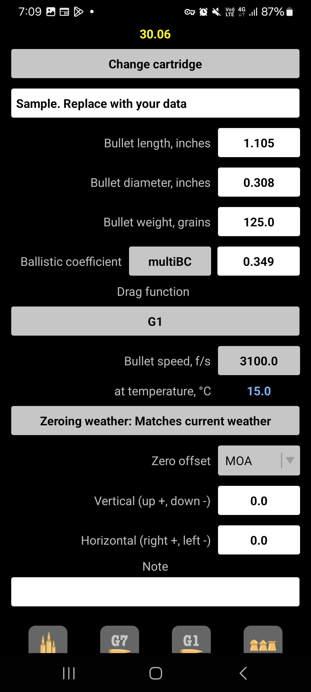

The only bits I'm missing are
Twist and Bullet length
Sierra website had most of the info I needed.but surprisingly didn't list the length.
With the number iv plugged (some guess work 1.215" long and 1 in 10) with wind speed of 6 metres / second (average ) I'm getting exactly 1" drift at 100
Without the wind, that would be a pretty tight group.

Post by Oldbloke » 12 Apr 2024, 9:40 pm
Barrel length 22"
1/10
Bullets are exactly 25mm (tip filed off)
Thx O0W. Appreciated
Great info.
Its just my old hunting rifle. Was just looking for ball park.
1" was more than I expected.
Looks like I've hit the jack pot regarding load.
:clap:

Post by on_one_wheel » 14 Apr 2024, 7:43 pm
Now you've got me second guessing if I've messed something up.
Screenshot_20240414_190920_Strelok Pro.jpg (374.2 KiB) Viewed 8863 times
Screenshot_20240414_190953_Strelok Pro.jpg (275.47 KiB) Viewed 8863 times

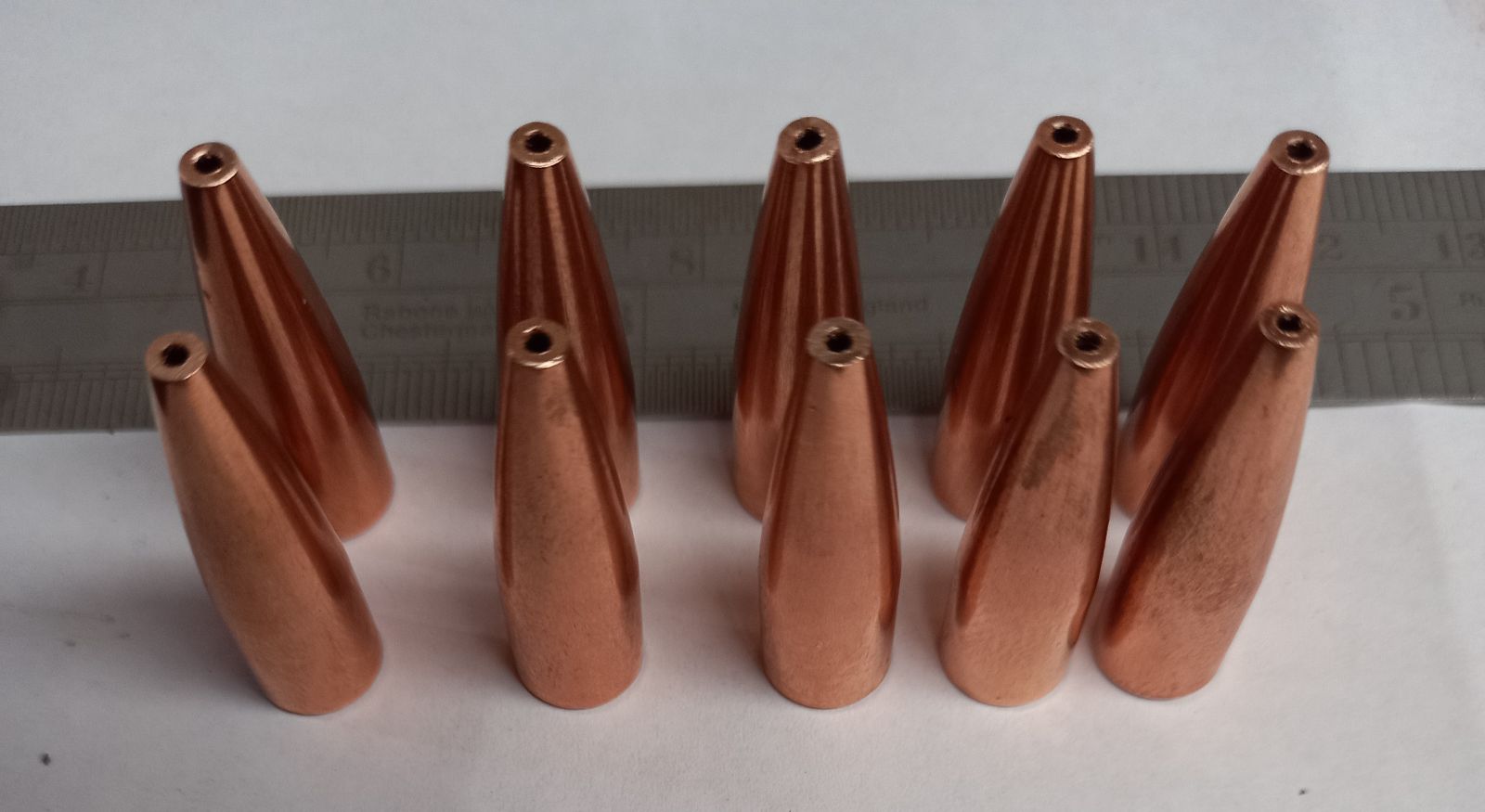

I had a look at an old cheat sheet. Slightly different data (slower fps)and wind 16kph @100 yards 1.1".
For my purpose close enough for me.
Also, regarding above qn the original intention was to push them to about 2700fps. However this the most accurate load.
They are not butchered.
Weight variation on the tiped bullets is only abt 0.1gr.
The jacket thickness is about same as many game bullets.
Lead hardness is also about same as game bullets.
Length variation is only abt 0.002"
I'm convinced they will be ok upto fallow.
BTW the ones shown are an early attempt. I have since made a jig and they are close to perfect.

Post by on_one_wheel » 14 Apr 2024, 9:06 pm
Every time I tune your numbers up that group looks better and better.
At 25kph 1.6"
At 15kph 1.0"
Perhaps straight shooter was reading MRAD ?

The finished projectiles in the picture look fairly neatly done but I suspect the much enlarged meplat may degrade the BC considerably.
If you have a drill press with a reliable depth stop you could consider using a small center drill to create a 60 degree chamfered hollow point.

Post by Oldbloke » 15 Apr 2024, 4:13 pm
Yes, BC will be effected.
They are now and the ones fired were better finished.
Yes, I'm giving them a very small counter sink.

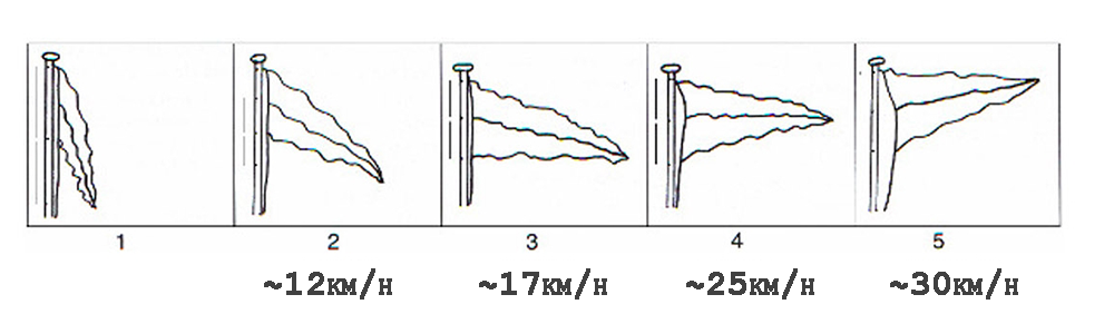

Post by in2anity » 17 Apr 2024, 11:05 am
here's our strength factors for quickly caculating windage:
(NRAA standard flag)
Going down a factor or two and then back to constant again can (and most frequently does,) happen and is precisely what the shooter monitors for during a stage. Often referred to as the "dropoffs". Similarly, going upward happens during a "gust".
Depending on the exact location and topography of the land, there is a direct correlation between wind direction and stability. For example here on the East coast, a sea breeze is mostly fairly constant. Where a South-Easter is notoriously more inconsistent, and should be monitored with a great deal more care. Such localised knowledge is the "homeground advantage"!
So given that fact, let's say your wind was dropping off from mostly a '4' to a '2' every now and again, without you noticing, that's a momentary 100m difference of 1/2" for even a bleeding edge 155gr palma load driven at 3000fps (.5bc). And I daresay you're not running a 32" barrel with HOT Berger 155gr palma handloads, so your 100m results will likely be worst than 1/2". For example a typical 55gr 223 load will be a 1" horizontal deviation in the aformentioned scenario, i.e. the wind drops to 12km/h for a moment, when it's mostly 25km/h constant.
This would perfectly explain your waterline.

Re: Wind question
Post by in2anity » 17 Apr 2024, 1:09 pm
And this is all presuming the wind direction remained constant, which will often not be the case.
Contrary to what seems intuative, a 90° crosswind (aka "full value") is often the most desirable. For full value, small fluctutations in angle have the least effect on your windage, provided the strength more or less remains the same.
In contrast, it the wind is a head or tail, a minor say 15° change in angle can result in signiifcant angular error on target. In an instant, you can go from a point one side to a point the other (or more, scaling with distance), which can easily go unoticed.

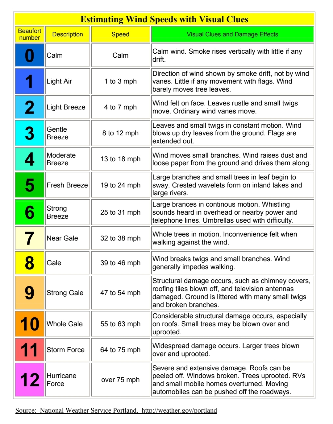

Occasionally I'll plink at 500m, I like to try and guess wind speed by kicking up dust, throwing leaves, watching mirage through the scope or just go by feel, often the guesswork isn't too bad however most of time I bust out my cheep anemometer when the battery isn't flat just to fine tune my guesswork.

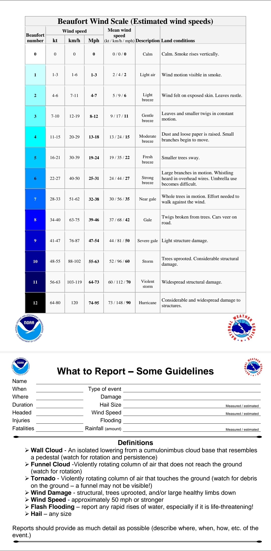

Out of interest I just found this, its some great information to completely forget about once your in the field.
Re: Wind question
Post by Oldbloke » 17 Apr 2024, 7:54 pm
That looks like the Beaufort scale.
Beaufort_Wind_Chart estimate.pdf
(126.31 KiB) Downloaded 922 times
Re: Wind question
Post by on_one_wheel » 17 Apr 2024, 8:01 pm
Oldbloke wrote:That looks like the Beaufort scale.
The attachment Beaufort_Wind_Chart estimate.pdf is no longer available
Good one, the Beaufort Wind Chart is even better :thumbsup:
