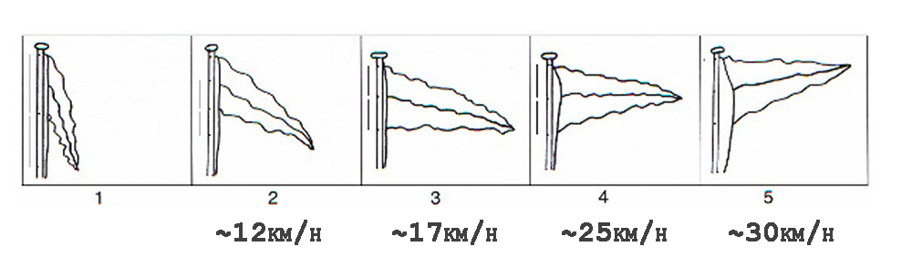

here's our strength factors for quickly caculating windage:
- (NRAA standard flag)
- wind.png (134.61 KiB) Viewed 8726 times
Going down a factor or two and then back to constant again can (and most frequently
does,) happen and is precisely what the shooter monitors for during a stage. Often referred to as the "dropoffs". Similarly, going upward happens during a "gust".
Depending on the exact location and topography of the land, there is a direct correlation between wind direction and stability. For example here on the East coast, a sea breeze is mostly fairly constant. Where a South-Easter is notoriously more inconsistent, and should be monitored with a great deal more care. Such localised knowledge is the "homeground advantage"!
So given that fact, let's say your wind was dropping off from mostly a '4' to a '2' every now and again, without you noticing, that's a momentary 100m difference of 1/2" for even a bleeding edge 155gr palma load driven at 3000fps (.5bc). And I daresay you're
not running a 32" barrel with HOT Berger 155gr palma handloads, so your 100m results will likely be worst than 1/2". For example a typical 55gr 223 load will be a 1" horizontal deviation in the aformentioned scenario, i.e. the wind drops to 12km/h for a moment, when it's mostly 25km/h constant.
This would perfectly explain your waterline.
