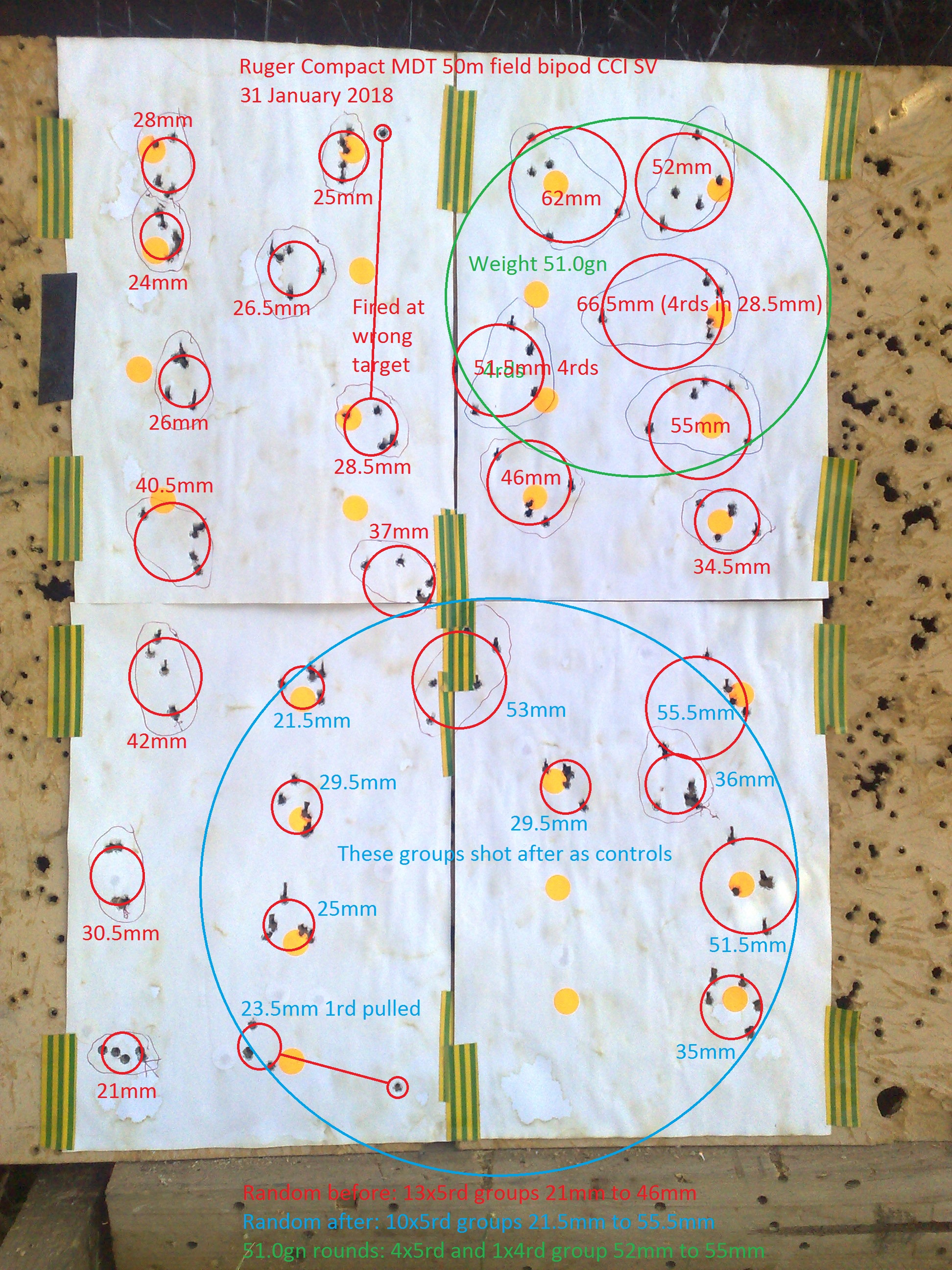

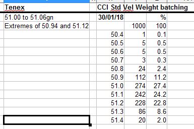

I thought I'd try an experiment and maybe learn something :-)
I weighed 1000rds of CCI Std Vel ammo and batched them in 0.1gn increments.
Weight batching .22LR.JPG (32.58 KiB) Viewed 9274 times
I weighed a box of Tenex to get an idea of their consistency - 95% of them fall within 0.1gn, with the anomalies spreading out to 0.18gn. About 70% fall within 0.06gn - 51.00gn up to 51.06gn - quiet astonishing I think for an amalgam of five different components.
I shot this in the field, laying in the grass on the bipod with no rear bag at 52m (I had to find a spot with a decent view through the grass). While I pulled very few shots (and fired one at the wrong target) it's a real possibility that at least some bullets traveled through the heads of grass, which may have affected them. There was a breeze, which is why I shot them at 50m rather than 100m, but it wasn't strong and was fairly steady, coming into my face from roughly eleven o'clock.
310120183342 b.jpg (1.53 MiB) Viewed 9365 times
I shot thirteen five-round groups to get my eye in first and zero the scope. These gave me a range from 21mm to 46mm and an average group size of 31.5mm. I shot another ten 5rd groups afterwards to confirm the rifle and myself were shooting the same as before - 21.5mm to 55.5mm and an average of 36mm.
Between these I shot 24rds in five groups (the largest batch was 274rds at 51.0gn so I used the odd 24 for this initial test). These shot very poorly I thought, very odd. Groups ranged from 51.5mm (for the 4rd group) to 66.5mm. Although I specifically noted that the very wide flier on the 66.5mm group was definitely not pulled by me, it was the first shot that made me wonder if I was hitting the grass. Without that shot, this was the best group at 28.5mm for the other four shots. The average was 57.4mm, and even dropping the "flier" they still averaged 50mm groups. Generally, these bullets were scattering very badly. Very odd as the following groups shot from a random box tightened up pretty significantly. It may be that cartridges right on 51.0gn may be the ones that become fliers when shot randomly, but it seems unlikely when more than a quarter of them make this weight.
Although the rifle was certainly able to shoot under 2MoA groups at 50m (12 groups were sub-2MoA) - both before and after shooting the 24 test rounds - I do note that, after this test, the bore has 2135rds down it since I cleaned it last. It is probably well due for a scrub. I'll give it a clean and try this again after I batch them by rim thickness as well. My intention was to batch 1000rds of CCI SV by weight and rim thickness, but I wanted to get an indication of the effect of just weight batching as well. I hope I can also have a new chronograph in time so I can record the velocity ranges as well.

Yes, I had read others that had found weight batching achieves nothing but I had to try it for myself :-)
Rim batching Remington Cyclones gave impressive improvements, but I chose the lowest quality ammo for that reason - to make any improvement really obvious. I wasn't sure I'd get such results with higher-quality ammo, but I want to find out.
What leaves me dumbfounded is how it's possible to shoot five consecutive very poor groups in the middle of 24 pretty reasonable groups, when those five were handpicked.

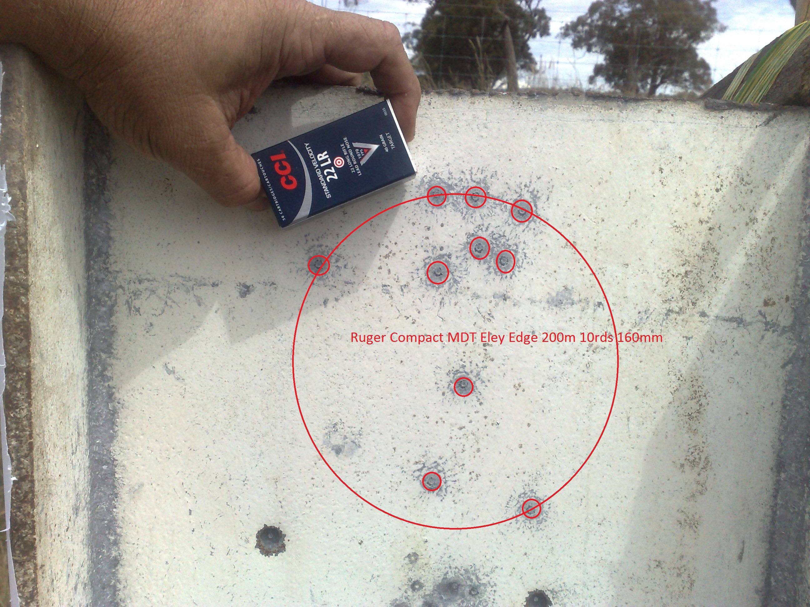

I just went out and shot a box of Eley Edge at 202m :-)
The first group (south of my fingers in the second pic) dropped five, then the wind drifted the next four off the side of the steel, but the tenth round came back. The other four groups I held along the right edge of the steel beam. The one group I put on paper is 110mm for 10rds. I didn't have a board to put behind and forgot that the shrapnel would destroy the paper :-)
The box is 72mm long.
I just held each range hash on the top right corner of the steel for each group. The topmost 160mm group was held on the top of the reticle post (15.4MoA or 900mm) - roughly 1100mm drop from a 100m zero.

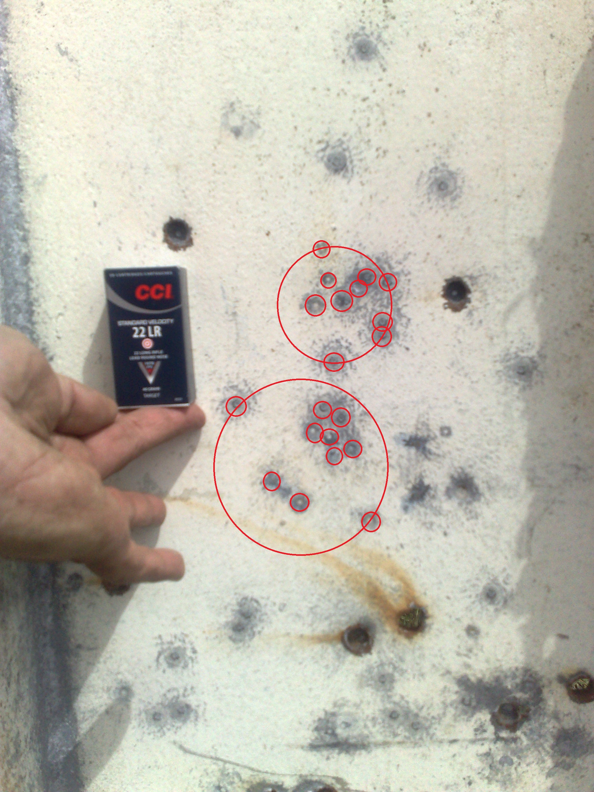

Well, I didn't get out as expected. Bit of repair work took priority. But finally got around to it today however not the best of conditions with heat, lots of mirage even at 50 metres and unfortunately with a storm brewing a bit of wind.
Decided last night to give the old Brno Model 2 a thorough clean, maybe I should have waited as I know it doesn't shoot that great from a clean bore but after a dozen rounds it started to look reasonable except for the not so great conditions.
So, here we go... Two 5 Shot Groups. On the left not so bad but mirage was the problem with the aiming point wandering around. Then on the right a tad worse when the wind came up and blew a couple to the right.
Overall, this is why I batch .22LR Ammo by Rim Size and why I like this Brno Model 2. This batch lot was just a fresh packet and a quick batch not the typical 1,000 rounds I should have done.
Was going to move to 100m then 200yards but the wind is even worse with a thunderstorm about to happen very soon so I packed up and will continue another day.
