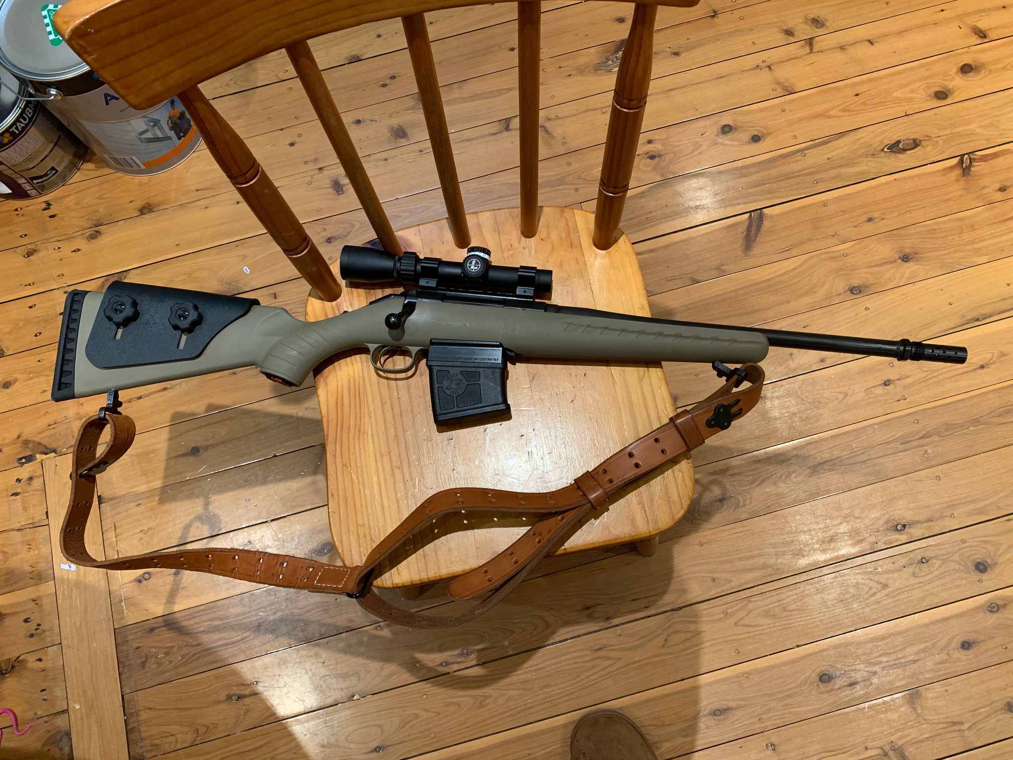

how about a 300blk like the ruger ranch? or the new howa mini 300blk? 1:7 handles up to 220gr.

in2anity wrote:how about a 300blk like the ruger ranch? or the new howa mini 300blk? 1:7 handles up to 220gr.
Certainly doable and fun. For what I am after, 300blk needs heavier charges and is a smaller calibre than most pistol calibres. Also the pistol calibres generally have bullets that expand at very low pistol velocities, aka getting a .45 up to 70cal mushroom at 875fps and decent 12-14" penetration. With rifles or solid cast loaded down you are usually left with bullet diametre holes, and while a 30cal will kill( a 22 LR will probably kill after all), 357 is my minimum for non- expansion.
A lot of the US hunters who shoot a lot more stuff than us with pistols( since they can hunt with them directly) generally concur. 38 for small/medium, and 40+ for medium/large. A lot of it is armchair BS, but hey thats what we post for right :)
A quick google search will reveal 30cal jacketed pills actually designed for subsonic expansion for example https://projectilewarehouse.com.au/prod ... 2154239619. In reality they will perform just as well on game as any medium-weight, slow moving lead projectile, with the added benefit of a higher bc (and obviously inherently better accuracy spitting from an acceptably bedded bolt gun). And in my personal experience hard lead projectiles punch holes instead of stopping.
Don't let me talk you out of your build however - I'm a huge lever fan (and always will be) - I'm just playing devil's advocate. You could most definitely achieve your goals out of a lever, just in a less efficient manner (the way i see it). In any case, new projects are fun :drinks:
With respect to powder economy, the powder cavity of a 300blk seems about on par with the 357 - I don't understand your statement "300blk needs heavier charges". Just tip in full case of TB and be done with it. TB is cheap. Basically, any straight-wall with a larger powder cavity than these will eat more powder will it not?
Its all good mate and I appreciate people searching options to check out :thumbsup:
The nosler I doubt expands at the low powered pistol speeds aka the 800-875fps range mentioned. Theres a difference between subsonic and low powered subsonic ,I should have clarified this is my main aim. Only a few things work this low. several pistol bullets get 50,60, 70cal mushroom at 850fps with the advantage of less powder/noise.
Stopping game- at these speeds not the aim, its more like archery kills, which is still valid. Personal preference for me if the bullet wont expand is drill vitals with 357 and up.The yanks tend to concur,- whether its a proven difference between 357 and 30, hard to say.
BC doesnt matter too much at these velocities, even a pistol bullet only loses about 1fps per yard, or 80-120fps over 100 yards. As such they are all making it to hunting ranges of 75-80 yards without much difference. The short stubby bullet with better calibre/expansion characteristics and less bore drag( less powder needed) has more advantages for me.
The 300 BLK is a bit less capacity than 357 and probably similar to 38sp yes. However as mentioned bore friction from its long bearing surface bullets and the less efficient case means its starting loads are going to be higher. I don't think you will get as low as you can with a 38, 357( eg 2.2 grain loads) and probably even 44 and get reliable exits. A moot point for general shooting, but keep in mind for quitest shooting 'filling up a case with trailboss' could be twice the powder I am aiming for. I will clarify I have not looked deeply into 'micro loads' for the blackout. Its more the low calibre, I discarded geting a 25-20 and 32-20 for the same reasons.
