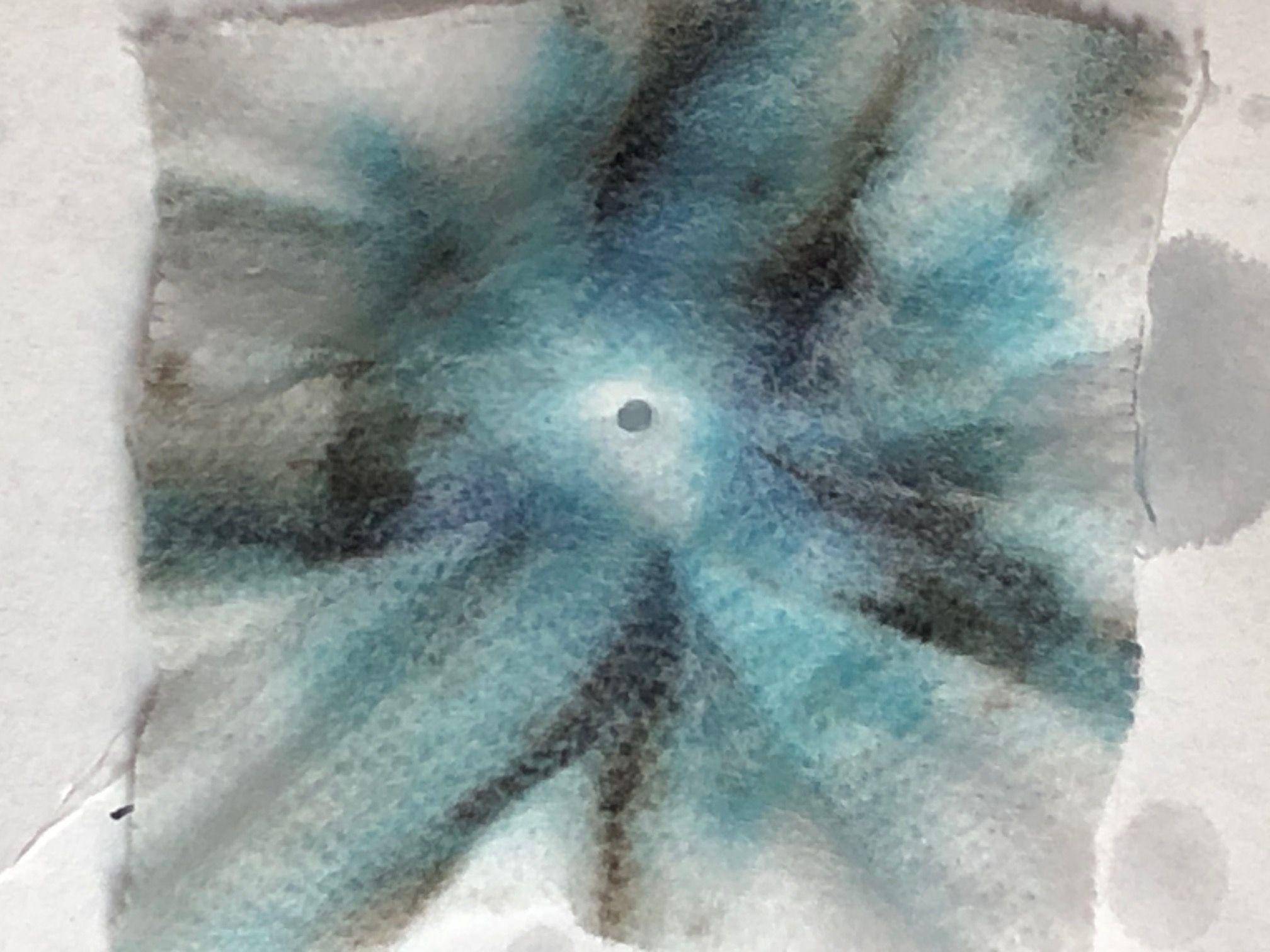

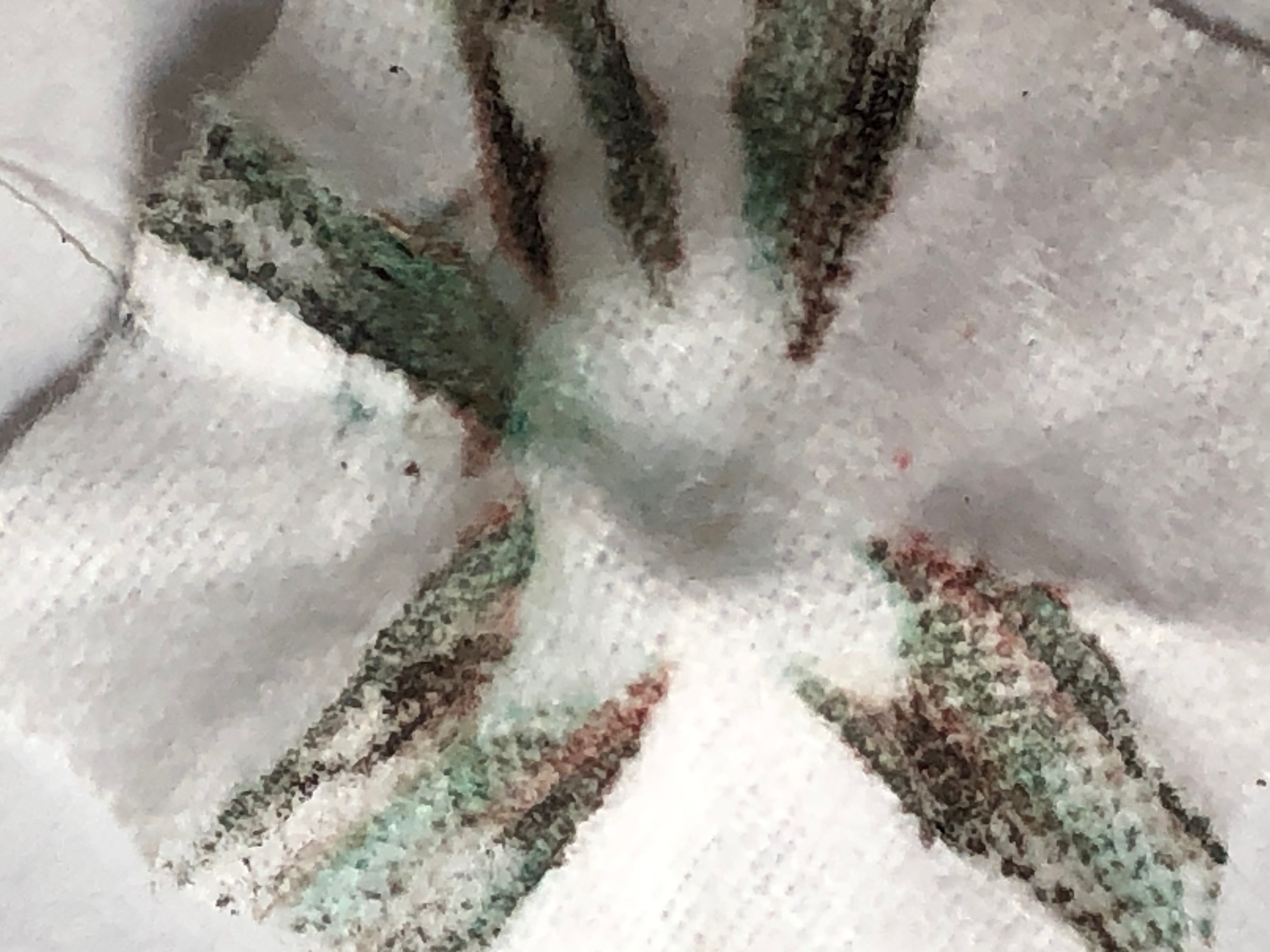

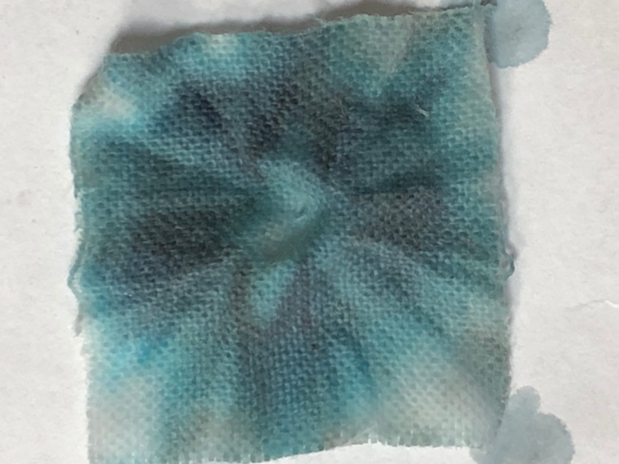

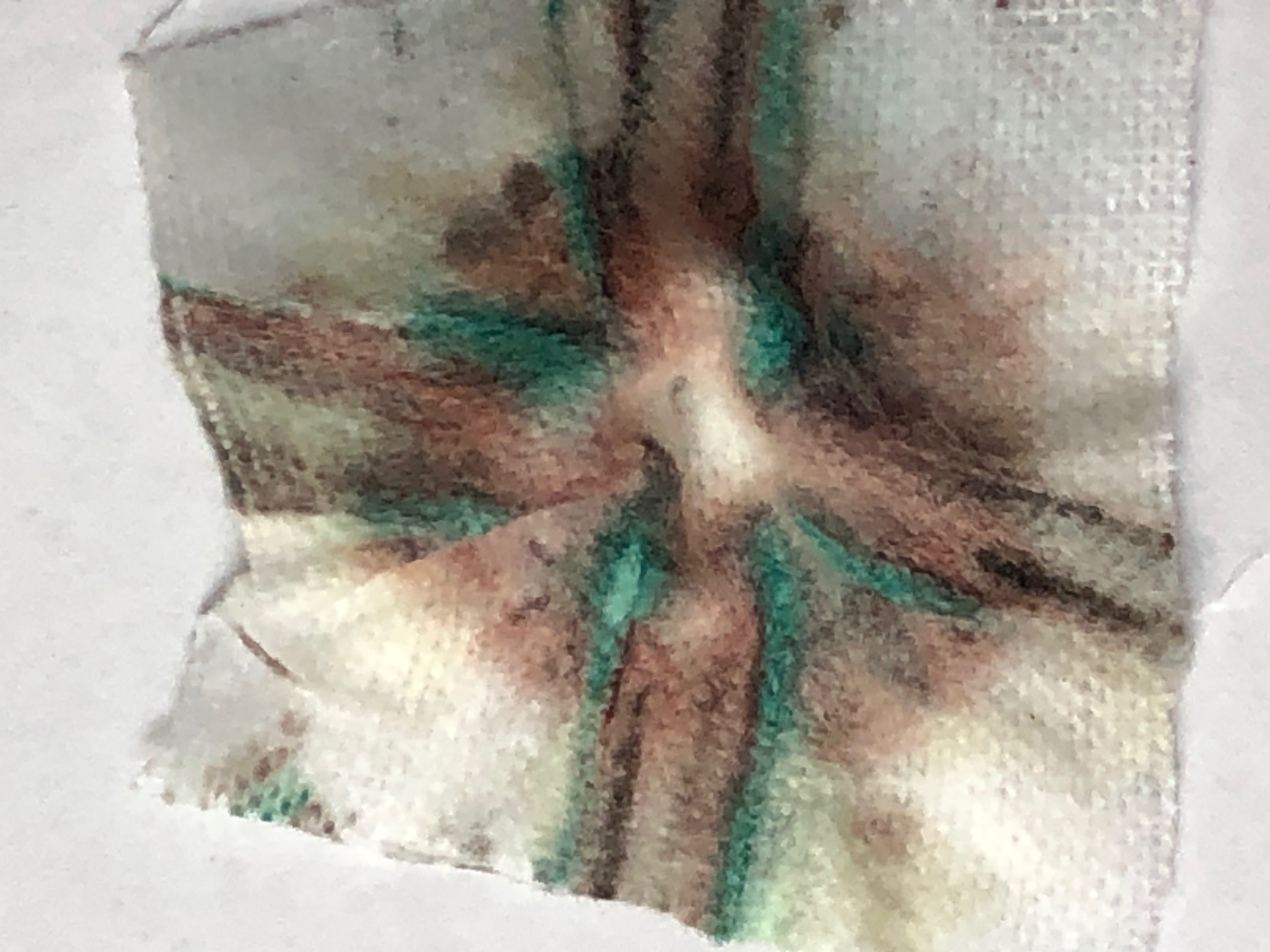

reading about your copper troubles here got me looking at my CZ. The last range trip 2 weeks ago saw groups go to crap. Looking down the muzzle, I had noticeable copper streaks like yours.
It has fired about 200 rounds total, and like you, I've used Sweets leaving it from anywhere from 15 minutes to 1 hour, and typically got one or two blue patches and then clean ones. I thought I was on top of things.
I bought some Boretech Cu+2 copper remover on Friday on the recommendation of some of the fellas on this site.
2 wet patches then a wet nylon brush, 10-15 vigorous strokes, wait a few minutes, 2 more wet patches then patched out with some Hoppes #9.
Could not believe the junk that came out, on the aluminium jag. It looks clean now. One day soon hopefully, I'll get to see if the accuracy has returned

Bloody hell bbss...that looks familiar and I’ve got chills...AGAIN.
I wouldn’t mind to much if it was settling down - but my last outing I only shot 5 quick ones thru, solely for the purpose of checking copper and it was horrendous.
