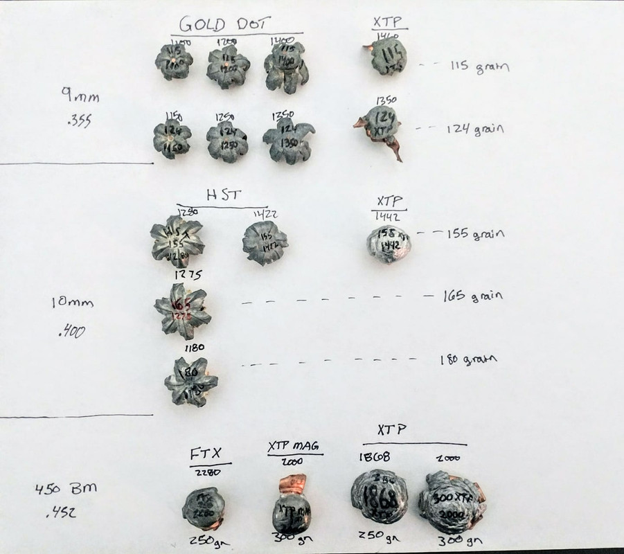

Just posting someone elses result for the 300XTP mag. These bullets are too hard for normal game I reckon.1444fps impact, failed to expand. Thats a very hard bullet in pistol calibres.Even with the casulls starting speed these will be pencilling through a lot of game at 100 yards. Still kill obviously but a bit meh if some bloke with a 44mag can drop game faster.

Post by mickb » 20 Feb 2025, 3:46 am
Better bullet is the 300XTP regular version. 2000fps impact below, she flattened a lot, much like a 240XTP at the same speed, but doesnt fragment, thats still a killer.
