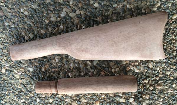

Post by Combat_Wombat » 06 Dec 2014, 10:10 am
So I've taken the stock back with 240 and 500 grit sandpaper to remove the old dodgy stain

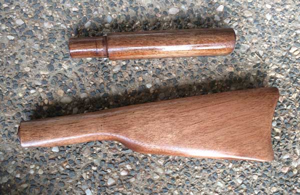

Post by Combat_Wombat » 06 Dec 2014, 10:11 am
I put 5 coats of tru oil on which sealed the timber nicely but didn't get as dark as I had hoped

Post by Combat_Wombat » 06 Dec 2014, 10:13 am
So I lightly sanded the stock and added two coats of redgum stain and another 5 coats of tru oil over the top and I'm pretty impressed with the outcome

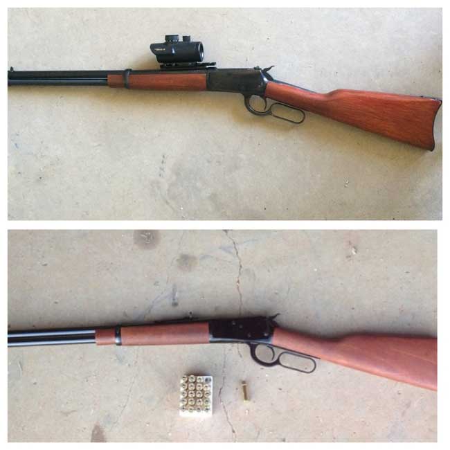

Post by Combat_Wombat » 06 Dec 2014, 10:15 am
Here's the before and after.
The Brazillian timber is no American walnut and doesn't have a distinctive grain pattern due to the tropical climate not having a large temperature difference so the timber doesn't shrink or swell much.

Post by Monty » 12 Dec 2014, 9:34 am
Pics received and updated to your original posts CW
Monty
Re: Stripping down a Rossi
Post by puffnstuff » 12 Dec 2014, 9:36 am
That's better.
