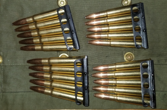

Has anybody trialled both methods of loading the chargers for a long enough time to determine if one consistently works better?

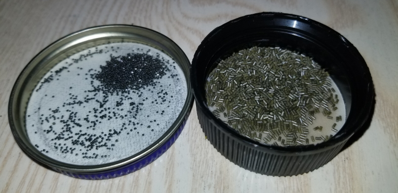

My mate got his reloading gear today, as well as powders and primers, so he came over this arvo and had a crash course in making .303 ammo.
I got a surprise when I opened the Winchester W748 powder as it's so fine, almost looks like iron filings compared to the extruded ADI powders I'm used to.
I jumped on Google and found some pics on various forums that do confirm it should look like this, but it'd be nice to have it confirmed by somebody that is using it themselves. If this is how fine their rifle powders are what do their pistol powders look like?
Load data (via PM from a member here, thanks for that!) has AR2206H (H4895) loads as well as W748 loads, which makes for a nice comparison. The data list AR2206H with a 174gn FMJBT on 33.6gn at 2200fps, 35.5gn at 2300fps, 37.4gn at 2400fps. I'm using 36gn making 2200fps and 38gn making 2282fps. For W748 they list 36.4gn at 2200fps, 38.2gn at 2300fps, 40.0gn at 2400fps.
So we made three rounds on 38gn of W748 to measure the velocity. We went and set up but I decided it was far too overcast to get any chrono data. He's left me his rifle so I can shoot them tomorrow to get the velocity, but I think we'll have to up it to 40gn.

Post by Gun-nut » 30 Jun 2022, 8:26 pm
bladeracer wrote:Has anybody trialled both methods of loading the chargers for a long enough time to determine if one consistently works better?
From experience and what I've read online, loading the chargers symmetrically (down, up, down, up, down) works with military brass as the rim is bevelled to alleviate rim-lock. With modern brass, loading the chargers staggered works best as they don't have the bevelled rims of the military mkVII stuff.

Post by bladeracer » 30 Jun 2022, 9:25 pm
I've read and seen that S&B has a reputation for rim-lock in .303. I have had an occasional one but I don't think I've had significant problems with it as yet. We did compare PPU with S&B today and the S&B brass does have a sharper top edge. If it is a problem I might chuck them in a drill and give them a touch with a file perhaps. I load them conventionally, down-up-down-up-down.

Post by bladeracer » 30 Jun 2022, 9:41 pm
Today's test of the three rounds of W748 was disappointing :-)
Round one was fine, three-inches high at 50m, but no velocity reading.
Round two was fine, an inch and a half higher, and a reading of 2048fps, more than 150fps less than the load data suggested.
Round three went fffttt, and pushed the bullet about 7mm into the rifling. The back of the bullet is still just over .311", the front of the bullet got swaged down to just under .311", about half a thou.
Extracted the case and it was still full of powder.
Some of it has burned but a large lump was just melted together, very strange. No gas out around the case either, usually when I have a squibbed bullet I can hear the gas pressure bleeding out of the action - this had no pressure at all.
I can't work out if the powder is bad, or perhaps just a dud primer with not enough flame. I would've expected even a poor flame would ignite the powder though, and even bad powder should've still burned away.
We're going to load some with 40gn and try again, maybe we just got a bad primer.

Post by N.Field » 02 Jul 2022, 1:44 pm
I've only ever done it like this - it's always worked fine for me.

Post by bladeracer » 02 Jul 2022, 4:29 pm
Yep, that's how I load and use them as well.
I'm not that bothered but I was loading up thirty of them the other night and thought I'd ask the question.

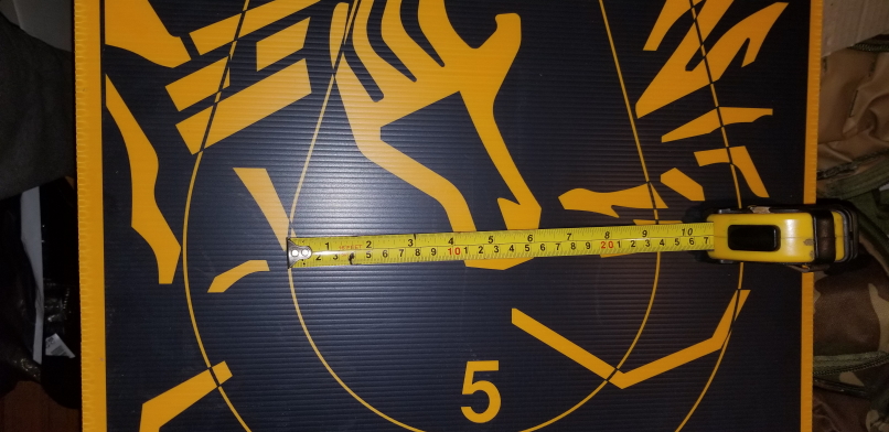

Post by Vince24 » 02 Jul 2022, 9:26 pm
I am still pretty new in reloading, so it would not come to my mind not to properly do the ladder test and go bold on any random load!
Especially that so far I have seen the best loads were generally not in the "super mild" area.
As a next stage I want to start using the OAL gauge but it's more out of curiosity.
The P14 has a no drill x6 scope, with the cheapest ring. It came with the rifle at a good price ($500 with dies and cases!). I will remove it and replace it with the military sight once I will be finished with load testings (which may take a while given the number of rifles I need to reload for!).
So the below is the pictures of the 2 five shot groups at 100m - a few clicks between the 2 groups to go down and left (but not enough cliks on the left)

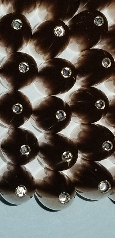

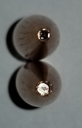

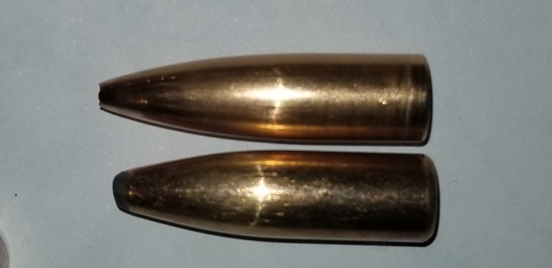

Post by bladeracer » 12 Aug 2022, 5:52 pm

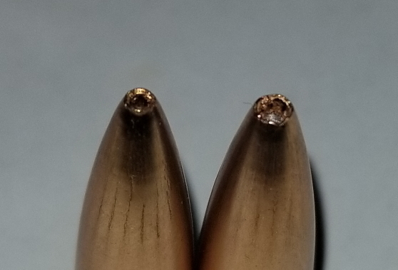

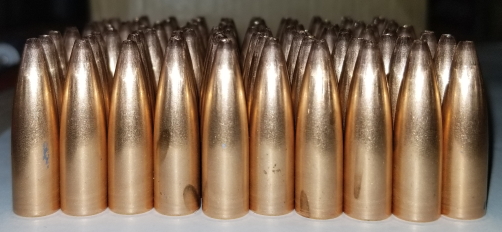

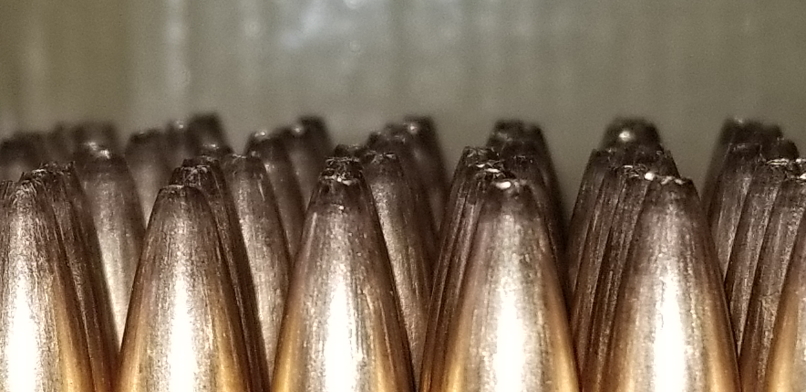

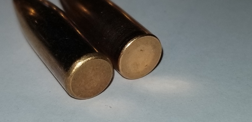

After a very long wait I have 500 174gn bullets from Scott Driver.
My initial impression is that they look good :-) I transferred them into plastic boxes (exactly 500) and kept 100 aside for measuring, which I'll hopefully get to over the weekend.
And a quick comparison with Bruce's bullet.
The base is a sharper edge which may require some extra care during seating, we'll see.
There is some variation in the depth of the hollow points, a few are full to within 1mm of the tip, others are up to 4mm deep.
And there is some variation in the size of the point.
Can't wait to get out and see how they shoot. I'll load them on the same 38gn AR2206H charge to start with.

Post by in2anity » 12 Aug 2022, 6:44 pm
174 gr flat base - that’s kinda different blade. That’ll be a nice low recoil load.
Re: .303 shooting
Post by dnedative » 12 Aug 2022, 7:59 pm
I like those, should shoot very well in just about any barrel.

Post by bladeracer » 01 Sep 2022, 4:26 pm
I finally have targets I can shoot at :-)
Huge thanks to G-Swiss!
He made the adjustments to the graphics and printed these for me on a plastic of some kind, looks to be weather resistant and should last a very long time.
I'm over the moon!
He also sent me files to print the middle section of the Figure 11 myself on four sheets of orange A4 pages to replace the middle as it gets shot out.
He's also threatened to do me some stickers of the Metallic Silhouettes at various scales for practicing on when he finds time :-)
And, Hornady .303 174gn FMJ's are back on shelves so I have 500 of those coming as well.
