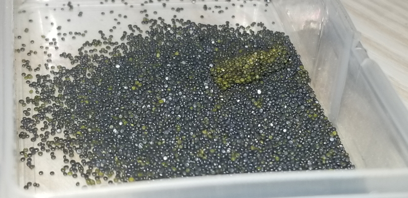

I got a surprise when I opened the Winchester W748 powder as it's so fine, almost looks like iron filings compared to the extruded ADI powders I'm used to.
I jumped on Google and found some pics on various forums that do confirm it should look like this, but it'd be nice to have it confirmed by somebody that is using it themselves. If this is how fine their rifle powders are what do their pistol powders look like?

Today's test of the three rounds of W748 was disappointing :-)
Round one was fine, three-inches high at 50m, but no velocity reading.
Round two was fine, an inch and a half higher, and a reading of 2048fps, more than 150fps less than the load data suggested.
Round three went fffttt, and pushed the bullet about 7mm into the rifling. The back of the bullet is still just over .311", the front of the bullet got swaged down to just under .311", about half a thou.
Extracted the case and it was still full of powder.
Some of it has burned but a large lump was just melted together, very strange. No gas out around the case either, usually when I have a squibbed bullet I can hear the gas pressure bleeding out of the action - this had no pressure at all.
I can't work out if the powder is bad, or perhaps just a dud primer with not enough flame. I would've expected even a poor flame would ignite the powder though, and even bad powder should've still burned away.

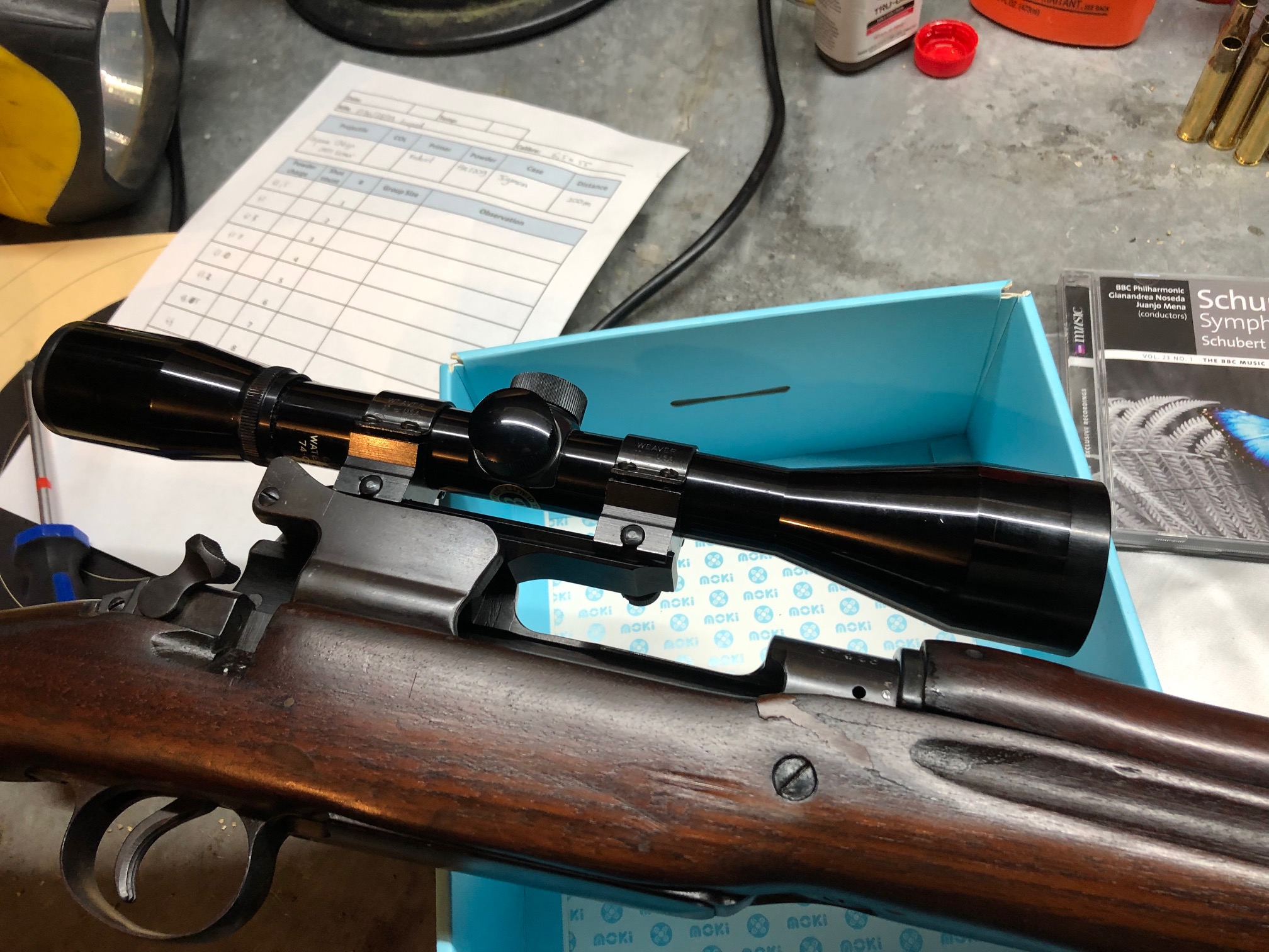

Is your P14 drilled and tapped or are you using a non-drill mount on it?

Your groups are in the right ballpark. Military competitions use bulls around two to three minutes so you don't need sub-minute accuracy. The 200m target for example is 475mm wide with a 240mm 5-ring. There is no V-ring.

The P14 has a no drill x6 scope, with the cheapest ring. It came with the rifle at a good price ($500 with dies and cases!). I will remove it and replace it with the military sight once I will be finished with load testings (which may take a while given the number of rifles I need to reload for!).

So the below is the pictures of the 2 five shot groups at 100m - a few clicks between the 2 groups to go down and left (but not enough cliks on the left)
Some awful flyers (??) but also some very well grouped impacts - 4 and 3 respectively.

One of the next rifles I need to do a ladder for is a 303 SMLE sporter. Think given this one is very light, I may give a go to 2206H to reduce recoild coupled with my remainings 174gn. I will be back to 2208 for my Long Branch, but I think I will just test the 39.5-41 grain area.
