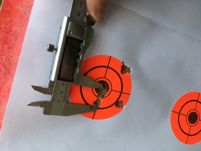

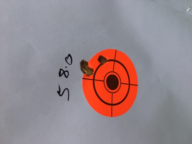

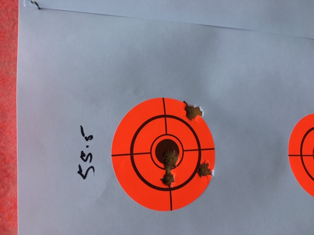

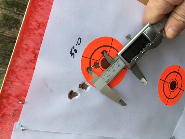

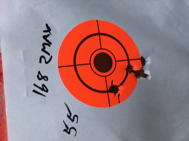

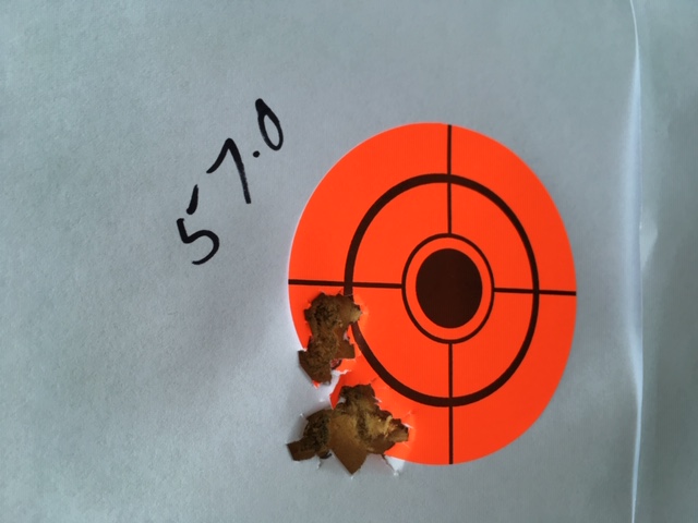

Post by TassieTiger » 10 May 2019, 2:48 pm

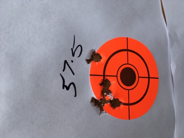

This has been coming for a long time for me...for a variety of reasons including a crappy steyr pro hunter that wouldn’t shoot for crap.
Anyway - got couple hours today after reloading a few last night.
Set up my desk at just on 170m.
Used AR2209 - started at 55.0gns in .5gn increments up to 58.0gns.
Shooting zmax 168gn projectiles from lapua brass.
Was shooting 5 shot groups and waiting 10-15mins between shots, with carefully monitored barrel temp. This is a hunting rifle at 2.9kg so this is kinda pointless to be target shooting with it but it’s a lot of fun and I’d like to push it and see how far it can go.
The little sauer only has a bushnell 3-9x40 $90 scope and I’m definitely at the limits of range for that scope for target type shooting.
First was 55.0gns which was kind of better that I thought it would be...
Then each 0.5gn progression as I went - the last group being 58.0gns.
I’d be interested in hearing comments on what more experienced shooters would develop next based on the evidence.
Because of my lack of skill / bench set up - you’d almost have to excuse at least the worst of each group...so....the 58’s look good yeah? But so does 55.0 with an excused flyer...

You appear to reduce vertical the faster they went. I would reshoot 57 to 58 grains in 0.3 grain increments. If you could get a chronograph for this testing all the better.

Fark - Your on it SC - I adjusted the scope 3 clicks to the right and 3 clicks down after shooting the 57.0 group...you don’t miss much.
The Harvey booklet says 59.0 is upper end for the 168’s but I was compressing the load at that, so thought I’d set my limit just under compression - 58...maybe 58.5.
Would you go to .2gn on a larger caliber rifle? A chrono would answer that I guess...
Re: 30-06 charge testing Sauer xt100
Post by SCJ429 » 10 May 2019, 9:28 pm
No, I don't think you need to have 0.2 grain increments. You will not miss the node with 0.3 increases, you can then fine tune with some jump testing.

if I can say anything from what you have written I would suggest not using a test that the rifle sits in but a set of bags so that the rifle can recoil freely
I do like your 58gr load and would rest that after fowling the barrel with a few
I cant remember off my head and it's to cold out in the shed at the moment but I'm sure I had another sweet spot at 58gr
because I am using win brass with this load I can use more powder without pressure because I have more volume
are you getting any pressure signs? my loads were worked up with quickload for my rifle so I went over what the book says
IMHO I recon you are doing alright :thumbsup: :drinks:

I ve never experienced pressure signs so don’t exactly know what I’m looking at - other than IT primer pics etc. bolt opens without any trouble - i “feel” I could go further as the 58’s are being handled easily.
I’m almost convinced I need to better the scope now to improve on this - and am looking at a Leo 4-12 to replace the bushy...
I know all rifles are different but I might do as SC and you’ve mentioned and bump up slowly now by .3 and see if I can sneak to 60gns...
I take your point re the rest - I have some bags and also a bi pod. I simply found the rest a fraction easier (more consistent) to hold the cross hairs with 4 equal quarters of the target decal in the scope - but given the recoil was so painful on that bloody thing, I’d not be surprised if I developed a small flinch.

Tassie the best way to check for pressure is by measuring the case head after the case has been fireformed in your chamber with a mid range load
the reason for fireforming first is all cases will expand when new, you want to see expansion after the case fits your chamber
