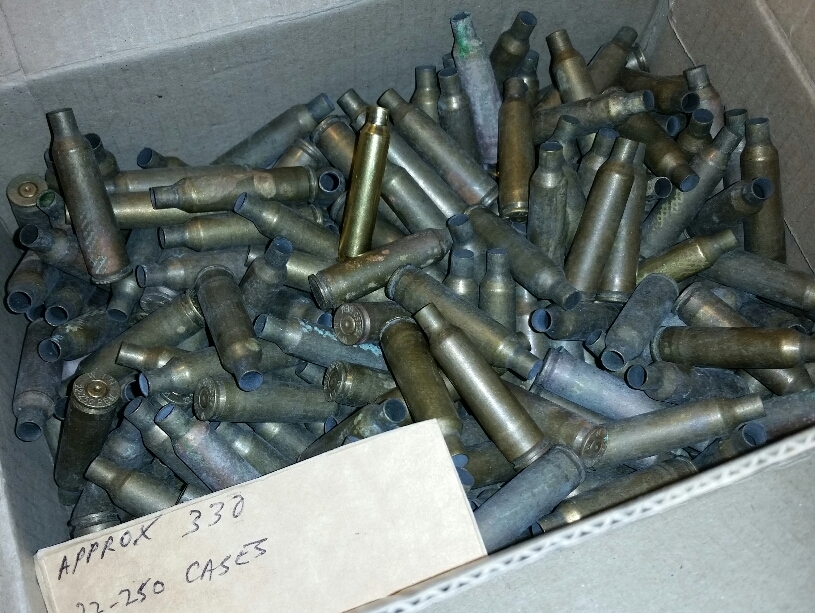

So...the cases im gonna try...
Its my best guess theyve all been once fired in the same rifle...
All within a thou of each other at the shoulder, & all look like factory primers...
From this...(there's a shiny 204 case sitting in there for comparison).

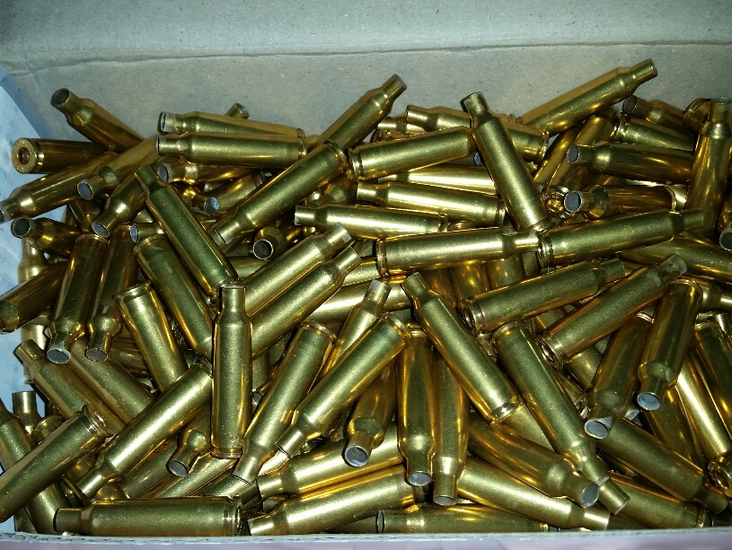

A quick toss in a bucket with detergent to get some furry stuff off...

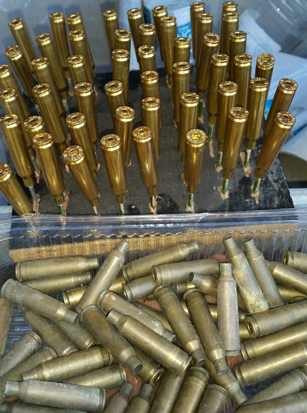

Some out the tumbler drying, & others about to go in...

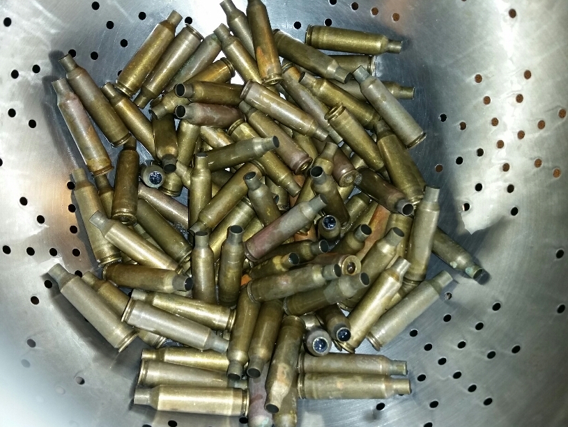

Gotta love these wet tumblers eh...!!
2019-12-28 23.19.03.jpg (514.35 KiB) Viewed 8394 times
Now, if only the rest of the case prep ahead were so easy... :thumbsdown:

Post by Blr243 » 29 Dec 2019, 1:38 am
Do u neck turn ? Could your necks be getting thicker
Re: Tikka T# 22-250 wont shoot
Post by perentie » 29 Dec 2019, 6:25 am
Inside the necks dont look so good. Might be why you get a different feel when seating. I give mine a spin with some copper wool wrapped around a brush in the battery drill. For target shooting my wifes 6.5-284 I neck turn to get consistant wall thickness. Its surprising how out of round some cases are.

Post by Strikey » 29 Dec 2019, 6:45 am
You are having a guess about that s**ty looking brass has been once fired in the rifle??? Even though your tumbler has cleaned those cases up they haven't been stored real well beforehand, I think this is the cause of your accuracy problem, bin those cases and start with some new ones before you waste any more time, money and barrel life.

Post by Stix » 29 Dec 2019, 11:51 am
Ok...so just for clarity... that brass in the pics is NOT the brass ive used in the rifle previously...
This is brass id intended to try...
Ive planned on inspecting & prepping a number of them, until i get 20 or so good ones, & try them...
Also, ive only given them a tumble to get the bulk of the crud off for prepping & inspection...
The ones i use will be tumbled again...
I agree new brass would be better, but not an option at the moment... :thumbsdown:
