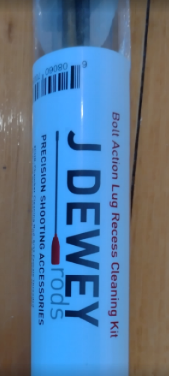

Post by MontyShooter » 06 Oct 2021, 9:45 am
I've got a J dewy lug recess cleaning kit but as above I tend to just use a 12g brush. The short dewy rod is handy though.

Re: Cleaning bolt lug cavities
Post by MontyShooter » 07 Oct 2021, 6:12 pm
Here's my one.
MontyShooter
