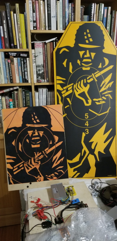

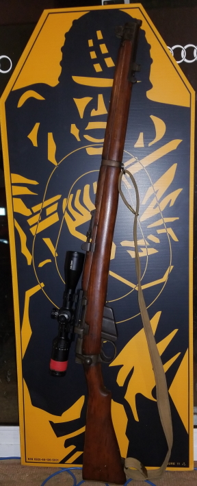

I've been hunting for copies of the Military training targets used in military competition shoots since last year. I finally have the last one, the large Figure 11, hand delivered to me by a guy that lives ten minutes away who goes up to NSW to do the LERA shoots at Rankins Springs. Thanks heaps, G :-)
The Figure 11 is 1160mm high by 475mm wide, printed on Corflute, making postage difficult.
I spent hours this week visiting and talking to printers and signwriters trying to get copies made - it seems it's too hard for professionals. So a neighbour scanned it in six A3 sections and built the pdf from that, which was my original plan before I had the bright idea that professionals might be able to save me all that effort :-)
So, I finally have a pdf version of it...and discovered it's a long weekend, so I don't expect to hear anything back from the printer before Tuesday at least. The pdf is not perfect though, my neighbour basically offered to show me how to do it myself and in ten minutes had it up on his screen :-) It'll do for a trial run to see how they print. If they come out nice I'll do it again with A4 scans and concentrate on getting everything perfectly square and ensuring light doesn't get in to keep the colours consistent.
I'm fairly confident we can keep our shots within the middle third of the target at 180m with our SMLE's, so I think it'd be a waste to replace the whole target. I've split the pdf into three, the upper 420mm (width of A2 paper), the lower 420mm, and the middle - also 420mm, so it'll have a 50mm overlap on the top and bottom sections. Then I can just swap out the middle when it gets too shot-up. If we do drop any wild ones into the top and bottom I'll just patch them with black and orange dots as I already do. So, targets are sorted at last.

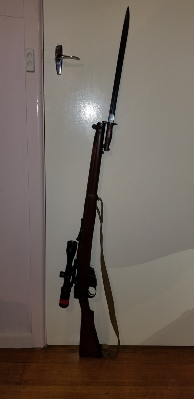

For load development I've mounted an Arctic Fox scope mount to the rifle. I'm fairly impressed with the fitment, but not entirely convinced it'll stay in place. I'll put a few mags of 150gn loads down range to test it out. It would've been very nice if they'd cut a groove down the middle so you could still use the sights with the mount in place (you can still use the sights when they're set to about 750m or more). And it would be nice if they'd grooved it like a picatinny rail instead of a Weaver to give more options for ring placement to suit a variety of scopes. But I'm hoping it'll be fine for my temporary use. Mounting it is quite fiddly (the 2mm Allen Key is a clue) so it's not something you want to mess with in the field. It relies on a small screw hanging out the bottom of the mount hard up against the front of the receiver ring. Then a pair of similar screws are tightened horizontally at the rear to put pressure against the charger bridge, forcing the front screw to bite into the receiver ring. Keep in mind that a 2mm Allen Key does not give you very much torque on these screws at all before you round out the sockethead grub screws.
I was hoping to get a chance to test the mount and get a rough zero this arvo but didn't manage it.

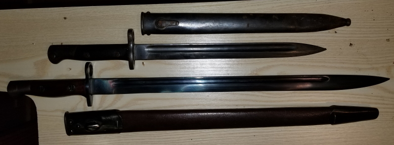

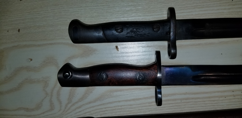

Oh, I forgot, LERA also do bayonet shoots and I don't have an M1907 bayonet. So I have a replica coming, and while looking for that I found an M1904 Portugeuse bayonet as well :-)

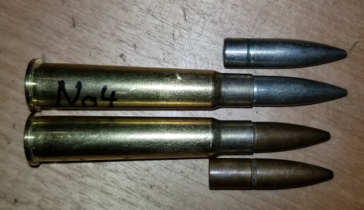

Anybody know the BC of the 174gn MkVII bullet?
I have some MkVII pulls - comparing them with other bullets I'm guessing they'll be around .450?
I don't think Bruce or Scott have published BC for their bullets so I'll have to shoot them to see.

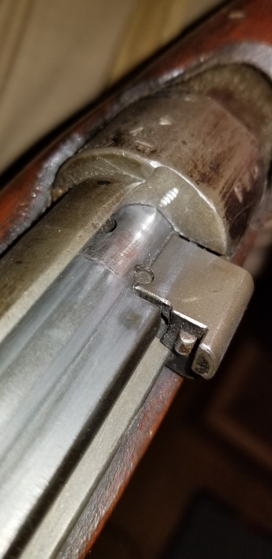

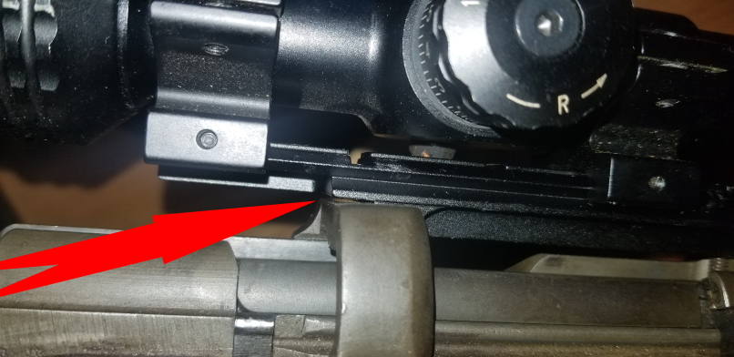

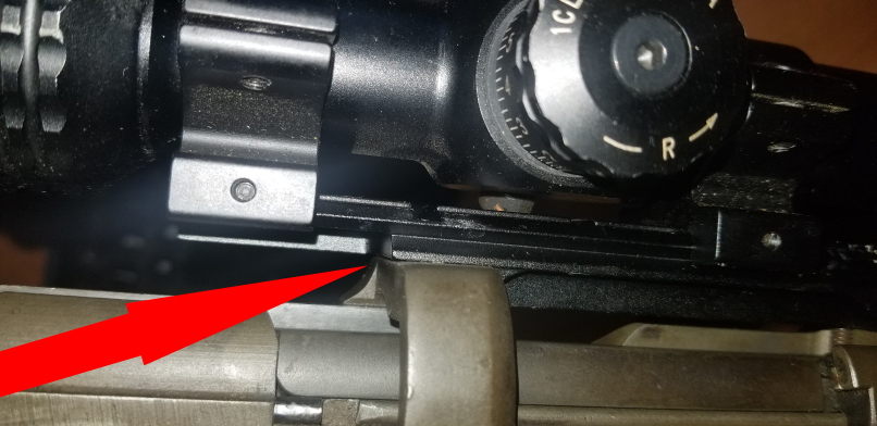

Just been out in the rain and wind to test the scope mount.
I boresighted at 50m and fired a shot - 12mm below and 6mm left of my aim point so no further adjustment made.
Second shot was only 20mm high, pretty impressive so far.
Shot three was 105mm high and 80mm left...hmmm...probably just me?
Shot four was another 70mm high and 20mm left...definitely not me.
Had a look at the mount, seemed tight enough but had a 1mm gap under the rear over the charger bridge.
Thump the scope back into place.
Shot five is right back where it should be, shot six goes through the previous hole 20mm high, but shot seven goes 90mm high and 30mm left - bugger.
I finished the mag by thumping the scope back down after every shot and all three dropped right where they should be.
Gave me a 50m group of 5rds in exactly one-inch, very nice, but hardly practical.
These were only 150gn bullets on 15gn of Trailboss. I don't recall the velocity but I think about 1500fps, making just 2.6ft-lb of recoil. I finished off with three hotter loads of 174gn Super bullets on 36gn of AR2206H making just under 2200fps, and 9.13ft-lb of recoil (and requiring hearing protection). Thumping the scope after each shot they dropped into 1.48", again not terrible, but 85mm low and 110mm left of point of aim.
I just checked the mount screws. the left screw was just very slightly loose, less than a twentieth of a turn on the allen key, the right screw wouldn't tighten any more, and both are already stripping the sockets. The mount may work, but the hardware is certainly not up to the job. I've ordered some stainless screws. I have found titanium screws but at $15 apiece I'll try the SS first :-)
I may have to use a file to under-cut the face of the receiver bridge as well, but I'll try harder screws first.

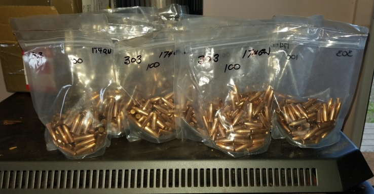

Post by bladeracer » 17 Jun 2022, 11:31 pm

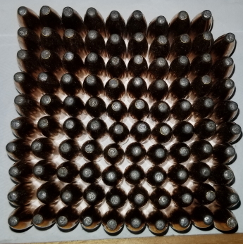

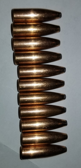

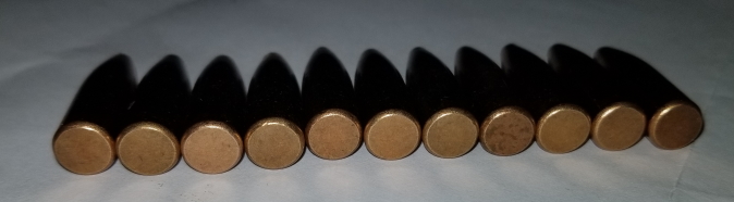

Received 1000 174gn bullets from Bruce Bertram today.

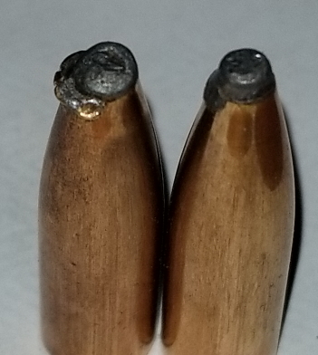

I grabbed a bag and started weighing and measuring bullets. Overall, they don't look too bad.
A couple of nasty lookers in the bag, but the count is 101, so 99 decent bullets, and the two bad ones will likely dress up with a few strokes of a file.
Bertram 174gn weights.jpg (12.1 KiB) Viewed 13013 times
Although the extreme spread is 1.2gn, or 0.7% variation, the curve is good. 48% are within .3gn, 66% within .5gn. These are soft-point hunting bullets, not match-grade competition bullets.
Bullet length averages 1.098". Again, being exposed soft lead points, there is some variation in length - .063" from 1.074" to 1.137" - 75% of them are from 1.088" to 1.108", or 0.5mm. The three longest are extreme anomalies. Excluding those three drops the ES to .042", not too bad for SP's more than an inch long.
I also measured bullet lengths at two points on the ogive, at .300" and .216" diameters, just to see how precisely they've been swaged. At the .300" point the ES in length is .014", which I would consider quite a lot of variation. If you happened to draw a couple of short bullets when measuring the lands, and only seated 10-thou short, you would then get a few loaded rounds jamming into the lands. 76% vary by just .003" though, and 90% vary by .008". For serious competition use it wood be worthwhile batching them to ogive length, as with any bullet.
At the .22-caliber point on the ogive the ES is .011", with the lowest being an anomaly by two-thousandths. 75% of them are within .002" and 87% are within .004" length variation. I think .009" variation this close to the point is not bad. I didn't bother measuring 101 meplats, but the meplat is roughly .130" diameter, it's quite a flat point.
Accuracy comes from the uniformity of the base, and these are beautiful in that regard.
I'm pretty happy with them so far, but the proof will be in the shooting, which I'm hoping I can make a start on over the weekend, with some luck.
Price was $50/100 if anybody is chasing .303 bullets.
Contact Bruce directly - [email protected]

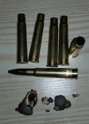

mickb wrote:Impressive haul. Will you test these on game as well mate?
It'd be nice but I think very unlikely. If there were pigs around here it might be feasible, but I'm not aware of any. I don't see these having the accuracy to head-shoot deer, even with an optic.
The bullet is heavier than I think is needed, except on big sambar perhaps, and I wouldn't much enjoy lugging a Lee Enfield rifle around in the bush :-)
I have a sporterised Turk Mauser (8x57mm) that is quite viable for bush work, so if I found a nicely sporterised No4 Rifle I'd be inclined to try these, but I think the Hornady 150gn is likely to be more accurate. It might be possible to take a Lee out and put some bullets through a dead one, if I managed to drag a complete animal up the hill.

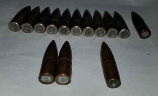

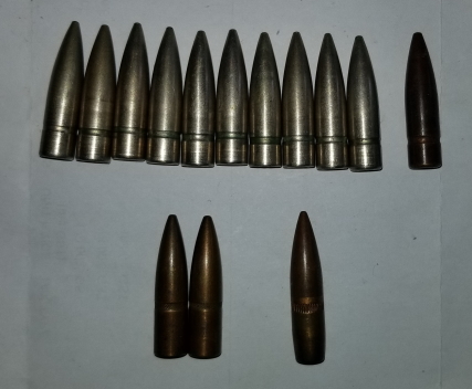

I also took some weights and measurements on some old FMJ bullets I have.
Ten cupro-nickel bullets vary in weight from 172.4gn to 173.4gn with no anomalies (two at 172.4gn, and one each at 173.2gn, 173.3gn and 173.4gn), in length from 1.267" to 1.289" (the shortest is anomalous being .007" shorter than the next shortest), and the .300" ogive varies by .018" in length. The shortest ogive is anomalous by .004" and the longest by .008", so eight of the ten sampled only vary by .006". They measure .3105" in diameter. As a sample of 100 (rather than ten) would expect to increase the variation significantly, I'd say Bertram's are pretty close to being as good as mil-spec. These cupro-nickel bullets seated to the cannelure give a 3.220" CoAL - well over-length, so I'm guessing these are early MkVII that were crimped inside the case neck rather than at the case mouth.
Two more are similar but not identical, measuring .3100" diameter, 173.0gn and 173.7gn, 1.280" and 1.284" long, but the ogive is .155" higher up the bullet. These two bullets would give a 3.045" CoAL, making then standard MkVII as far as I can determine.
I also have a copper-jacketed bullet that appears to be early MkVII, 173.9gn, .3110" and 1.289" long.
And I have a 203.2 gn, 1.394" bullet that I'm guessing is a 7.7x58mm Arisaka bullet.

As for the Arctic Fox mount, I tightened the screws as far as possible after the first firing, to the point that both 2mm sockethead screws were already stripping. My first shot was where my last shots were, 115mm left and 55mm low, nice. I forgot about having to punch the scope down and my second shot was 450mm high. I thumped the scope into place and shot number three was still 300mm high. I went back and got the 2mm allen key to tighten the screws. No chance, the allen key was just going in circles. Luckily the sockets still had enough bite in reverse to be able to undo them and take the thing off. For $120 I can't recommend it at all. I'm hoping some harder screws _might_ allow me to tighten it more, but I still can't believe it'll stay on the rifle once I start shooting, just a crap design, made worse by using rubbish hardware. It should have actual clamping blocks at each end and much larger screws that you can actually put some torque into. They do suggest undercutting the charger bridge with a file to give it some bite, but that defeats the entire point of buying a mount that avoids having to alter the rifle - I might as well just drill and tap a pair of holes in the charger bridge and do it properly. I did manage to find a scout mount in my box of bits, but as it means removing the rear sight whenever I want to do load development I'm not sure I'll bother with it.
I went up and made a larger aiming point that I could actually see at 50m.
The front sight was totally invisible to my right eye, but I bore-sighted it using the sight protector ears and it looked close enough. The sight ears worked well, keeping all eight shots on point of aim and within a 45mm horizontal spread, but the vertical was 90mm tall, plus one shot 110mm above point of aim. Not too bad at all. If I assume the vertical is simply because I don't have a front sight blade I can probably work okay with this until I come up with a fix for my eye. I'll try these in the competition rifle with the Parker Hale aperture, and then I'll have to see how I get on at 200m and 300m with the OEM sight.

Test fired five rounds today in yesterday's fire-formed brass to see if it loses much velocity from the new brass.
Nope, 3fps difference between new and fire-formed. So I'll make a couple hundred rounds for practicing and see how I like them. Surprisingly, they stretched another .004" after firing and another .002" after neck-sizing. I don't think I'm going to get many firings out of these at full-noise :-)
I also found a couple of the bullets on the ground.
Received the stainless screws today and re-mounted the scope. With the OEM screws the allen key was stripping out the sockets with virtually no torque at all, with these screws I was able to actually bend the allen key. The mount is nice and tight now so I'll try it again tomorrow if I get a chance and see if it stays in place. I was surprised to see that the front screw leaves a very obvious mark at the receiver ring.
And received a very nice replica bayonet for the old girl, as well as an original M1904 Portuguese bayonet.

Post by in2anity » 22 Jun 2022, 9:14 pm
So you’re finding verticality in the Arctic Fox are you Blade? Considering the pivot is at the back, and group is climbing, how is this explained do you imagine?
Re: .303 shooting
Post by bladeracer » 22 Jun 2022, 9:29 pm
in2anity wrote:So you’re finding verticality in the Arctic Fox are you Blade? Considering the pivot is at the back, and group is climbing, how is this explained do you imagine?
Not quite, I'm finding the scope coming loose with each shot :-)
It's lifting at the rear, the front tends to stay in place.
The bullets then go high, as you'd expect.
I thought these were generally highly regarded but I'm not seeing it. Even if the new screws fix it, it's still not suitable for most shooters that simply want to mount a scope on their rifle.
Re: .303 shooting
Post by in2anity » 22 Jun 2022, 9:36 pm
The scope’s coming loose at the back? Isn’t it picatiny?
Re: .303 shooting
Post by bladeracer » 22 Jun 2022, 10:26 pm
No, it's a Weaver, but the mount is coming loose, the scope is firmly attached to the rail.

It occurred to me to price these up to compare with the factory ammo.
The Bertram 174gn bullets were $535 with post for 1000, or 53.5c apiece.
PPU brass was $249 for 500 pieces (July 2020) - free postage as it was part of a larger order.
I'm assuming I can get ten loads out of them at this pressure - I'm using ten pieces for testing to try to suss out the case life.
Remington 9-1/2 primers I paid $80/1000 for.
And AR2206H I paid $375/4kg for.
Current prices on powders and primers are too volatile to try to work out current rates.
So, for a single shot, then toss the brass, they're costing $1.35 apiece.
If I can get ten loads out of them then they're costing me 90c apiece.
If they'd let me use cast bullets they be costing me about 37c apiece :-)
