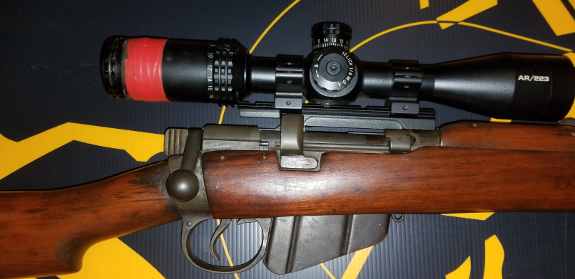

For load development I've mounted an Arctic Fox scope mount to the rifle. I'm fairly impressed with the fitment, but not entirely convinced it'll stay in place. I'll put a few mags of 150gn loads down range to test it out. It would've been very nice if they'd cut a groove down the middle so you could still use the sights with the mount in place (you can still use the sights when they're set to about 750m or more). And it would be nice if they'd grooved it like a picatinny rail instead of a Weaver to give more options for ring placement to suit a variety of scopes. But I'm hoping it'll be fine for my temporary use. Mounting it is quite fiddly (the 2mm Allen Key is a clue) so it's not something you want to mess with in the field. It relies on a small screw hanging out the bottom of the mount hard up against the front of the receiver ring. Then a pair of similar screws are tightened horizontally at the rear to put pressure against the charger bridge, forcing the front screw to bite into the receiver ring. Keep in mind that a 2mm Allen Key does not give you very much torque on these screws at all before you round out the sockethead grub screws.
I was hoping to get a chance to test the mount and get a rough zero this arvo but didn't manage it.

Just been out in the rain and wind to test the scope mount.
I boresighted at 50m and fired a shot - 12mm below and 6mm left of my aim point so no further adjustment made.
Second shot was only 20mm high, pretty impressive so far.
Shot three was 105mm high and 80mm left...hmmm...probably just me?
Shot four was another 70mm high and 20mm left...definitely not me.
Had a look at the mount, seemed tight enough but had a 1mm gap under the rear over the charger bridge.
Thump the scope back into place.
Shot five is right back where it should be, shot six goes through the previous hole 20mm high, but shot seven goes 90mm high and 30mm left - bugger.
I finished the mag by thumping the scope back down after every shot and all three dropped right where they should be.
Gave me a 50m group of 5rds in exactly one-inch, very nice, but hardly practical.
These were only 150gn bullets on 15gn of Trailboss. I don't recall the velocity but I think about 1500fps, making just 2.6ft-lb of recoil. I finished off with three hotter loads of 174gn Super bullets on 36gn of AR2206H making just under 2200fps, and 9.13ft-lb of recoil (and requiring hearing protection). Thumping the scope after each shot they dropped into 1.48", again not terrible, but 85mm low and 110mm left of point of aim.
I just checked the mount screws. the left screw was just very slightly loose, less than a twentieth of a turn on the allen key, the right screw wouldn't tighten any more, and both are already stripping the sockets. The mount may work, but the hardware is certainly not up to the job. I've ordered some stainless screws. I have found titanium screws but at $15 apiece I'll try the SS first :-)
I may have to use a file to under-cut the face of the receiver bridge as well, but I'll try harder screws first.

As for the Arctic Fox mount, I tightened the screws as far as possible after the first firing, to the point that both 2mm sockethead screws were already stripping. My first shot was where my last shots were, 115mm left and 55mm low, nice. I forgot about having to punch the scope down and my second shot was 450mm high. I thumped the scope into place and shot number three was still 300mm high. I went back and got the 2mm allen key to tighten the screws. No chance, the allen key was just going in circles. Luckily the sockets still had enough bite in reverse to be able to undo them and take the thing off. For $120 I can't recommend it at all. I'm hoping some harder screws _might_ allow me to tighten it more, but I still can't believe it'll stay on the rifle once I start shooting, just a crap design, made worse by using rubbish hardware. It should have actual clamping blocks at each end and much larger screws that you can actually put some torque into. They do suggest undercutting the charger bridge with a file to give it some bite, but that defeats the entire point of buying a mount that avoids having to alter the rifle - I might as well just drill and tap a pair of holes in the charger bridge and do it properly. I did manage to find a scout mount in my box of bits, but as it means removing the rear sight whenever I want to do load development I'm not sure I'll bother with it.

Received the stainless screws today and re-mounted the scope. With the OEM screws the allen key was stripping out the sockets with virtually no torque at all, with these screws I was able to actually bend the allen key. The mount is nice and tight now so I'll try it again tomorrow if I get a chance and see if it stays in place. I was surprised to see that the front screw leaves a very obvious mark at the receiver ring.

So you’re finding verticality in the Arctic Fox are you Blade? Considering the pivot is at the back, and group is climbing, how is this explained do you imagine?
Re: .303 shooting
Post by bladeracer » 22 Jun 2022, 9:29 pm
in2anity wrote:So you’re finding verticality in the Arctic Fox are you Blade? Considering the pivot is at the back, and group is climbing, how is this explained do you imagine?
Not quite, I'm finding the scope coming loose with each shot :-)
It's lifting at the rear, the front tends to stay in place.
The bullets then go high, as you'd expect.
I thought these were generally highly regarded but I'm not seeing it. Even if the new screws fix it, it's still not suitable for most shooters that simply want to mount a scope on their rifle.

Post by in2anity » 22 Jun 2022, 9:36 pm
The scope’s coming loose at the back? Isn’t it picatiny?
Re: .303 shooting
Post by bladeracer » 22 Jun 2022, 10:26 pm
No, it's a Weaver, but the mount is coming loose, the scope is firmly attached to the rail.
