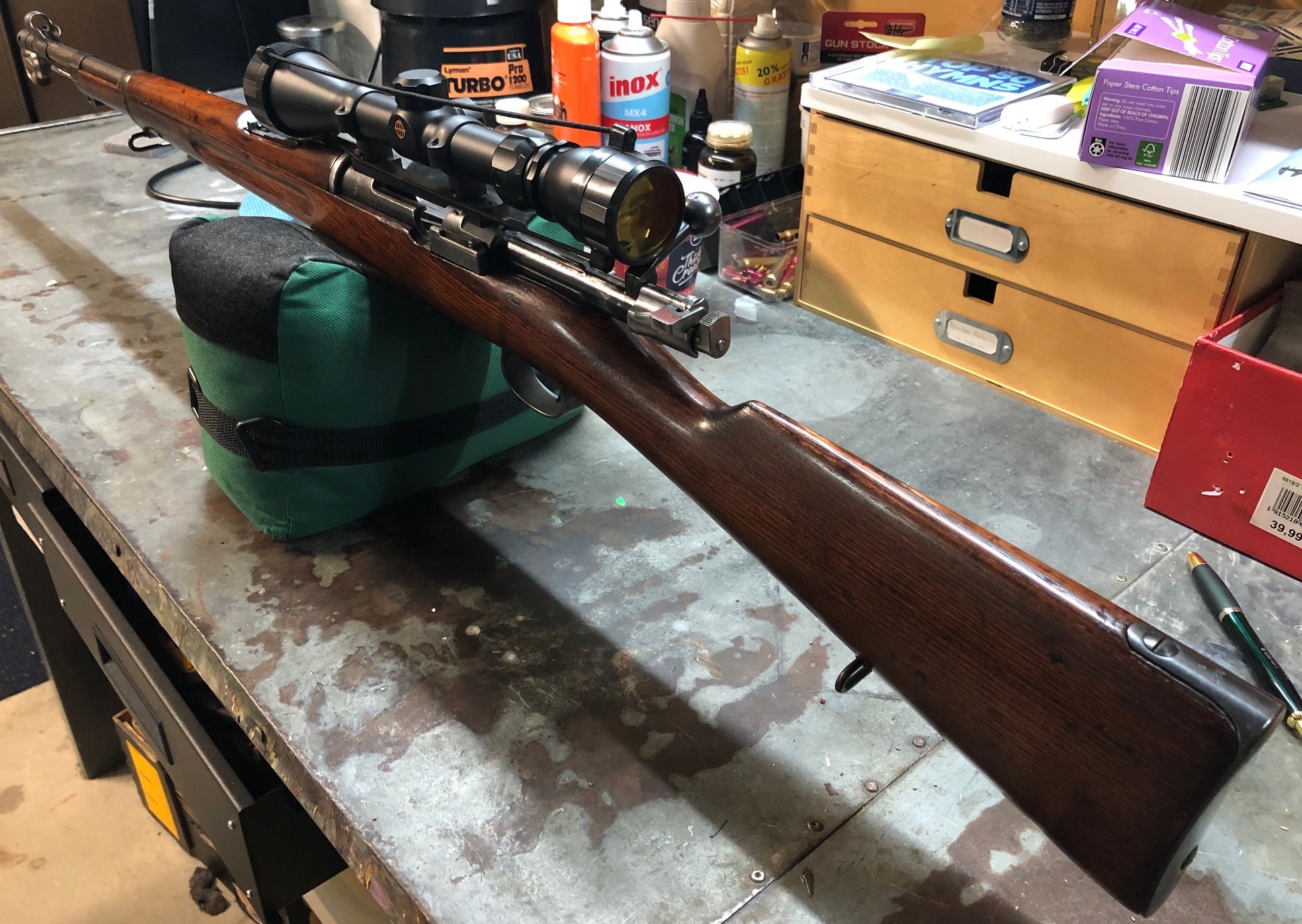

So I was doing a ladder test with this Carl Gustav.
Noting the old toy is from... 1899, so a very early Carl Gustav, very very uncommon. The early ones were often produced by Mauser Oberndorf.
It used to be in an ugly green plastick stock for hunting :wtf: , but I managed to convince his dear owner (my in-law!) to put it back in the original configuration.
IMG_4171 (1).jpg (701.84 KiB) Viewed 8847 times
