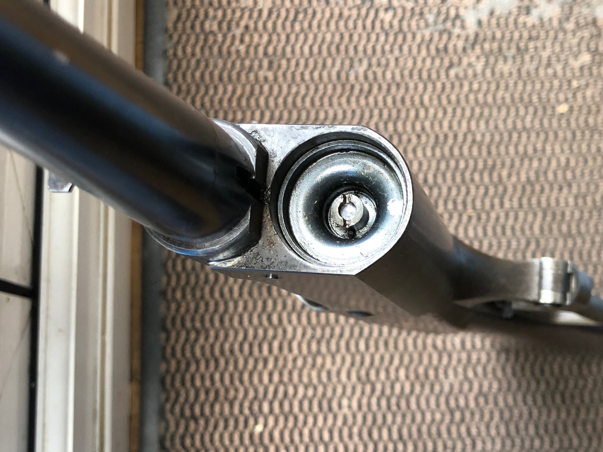

Whilst I'm on the computer, I'll tell you about the bloody magazine.
If you're familiar with 99s (the gun not the ice-cream cone) one of the features is a rotary magazine that holds,in my case, 5 rounds. If you want a six shooter depress the top round whilst slightly moving the bolt toward battery then hand feed the 6th one and then close the bolt (I need this if I go cowboy action shooting, FWIW)
Anyway if you read American forums they advise one to take the gun to a gunsmith to get the mag to work correctly. Absolute bull s**t, it's easy peasy.whether or not the gun is takedown or fixed barrel.
The first image below shows the adjust ment screw, the second image shows the locking screw ( and the stupid magazine indicator) Remove this locking screw before adjustment, it doesn't have to be removed completely just enough to let the mag roto spin back to no pressure. Turn the adjustment screw anti clockwise, mine took between 1/2 and 3/4 of a turn then continue turning whilst pressing on the locking screw, which will enter a groove on the steel drum, push the screw in and screw it home if you must then load the magazine, each round right up to the 5th should go in dead easy, if too tight slack that adjustment screw back a 1/4 of a turn as aove and try again, keep at it until you are happy.
If the gun is a takedown and you've removed the barrel, you can feed the rouds through and pull them out of the receiver, if it ain't a take down model, take care :? .
Adjustment screw in centre, anti clockwise to add tension, try 1/4 from start at a time.
mag adjustment 1.jpg (683.96 KiB) Viewed 7736 times
mag adjustment 2.jpg (480.88 KiB) Viewed 7736 times
