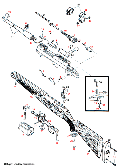

Anybody got an opinion on the Ruger 77/44 bolt action?????

They have a following but the reality is the split bolt design means accuracy can be hit and miss and unlike regular bolt actions any remedial procedures, bedding etc dont necessarily improve it. Its a long lamented subject that we dont have the Remington 788 still available which was a much better 44 mag bolt gun. Again, quite a few blokes like their ruger 77/44 so take a chance if they appeal to you. I personally never liked the short barrel and low capacity.

with the split bolt rugers they put shims in them to get good headspace for better/consistent accuracy . they can be good accurate guns , but it's not my idea of a good design . the new cz 457 rimfires can have the same issues. rem 788's in 44 and 30-30 would be good , but are rare , and people want stupid money for them :thumbsup:

Bigrich if yours worked okay I wont disdain it but Ive seen threads with blokes having trouble even after shimming. This thread the bloke says trying 4 different shims got his 77/357 finally to be able to hit 4" targets at 65 yards lol.
https://www.rugerforum.net/threads/77-3 ... ed.109124/
Thats probably a worst case example admittedly,. Its worth the O.P searching up on it though, see what his level of DIY tolerance is.

i've not had a ruger 44/357 myself , i learnt this from researching various rifles before purchase, having to shim bolts doesn't sound like it's a good action to start with in the first place to me . i've had early rossi 357's , pre bolt mounted safety, that shot really, really well . best accuracy i ever got was a 357 marlin that i slicked up and did some work to , with 158xtp's and lil gun , also the best 22 hornet powder i came across . more speed than other powder and outstanding accuracy . the fact that i can't get ADI pistol powders or lil gun has put me off pistol cartridges . but having said that , pre covid 357mag was very reasonably priced for factory ammo in my neck of the woods . talking to a fella i knew with 44mag and 357mag Rossi's, he was off the opinion 357 worked better on pigs than the 44. that might be different with BIG pigs in the north of OZ :unknown:
