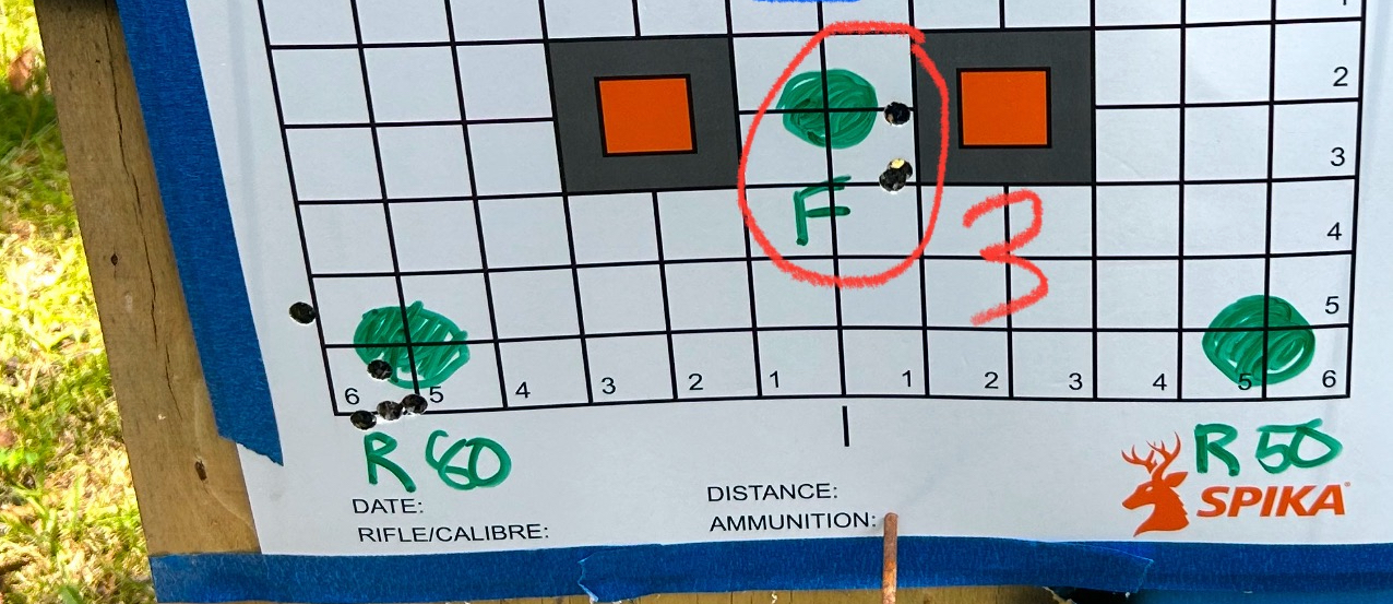

Here is a target with 5 shots with Remington Core Lokt 180g and 3 shots with Federal 180g at 100m which appear to be right on the 1 MOA mark (1 shot out with the Remington')

Post by geoff » 28 May 2025, 3:55 pm
Three shots just isn't enough information to reliably tell you what your rifle or your load is doing. You cannot determine if that's a true reflection of how it performs or if you just got lucky. This goes on for a little while, and contains some discussion that is reasonably technical on statistics etc, but should be mandatory learning for anyone wanting to discuss accuracy and precision:
https://youtu.be/QwumAGRmz2I?si=TjMFJ-Qz4c_vWtCo
The short version: go do some 10 or 15 shot groups and then come back to us, you just don't know how accurate it is now. A 3 shot group can indicate to you that a given is load is not going to be sufficiently precise (because it'll never improve with more shots) but cannot reliably indicate that a load is precise.

Post by MG5150 » 28 May 2025, 5:38 pm
geoff wrote:Three shots just isn't enough information to reliably tell you what your rifle or your load is doing. You cannot determine if that's a true reflection of how it performs or if you just got lucky. This goes on for a little while, and contains some discussion that is reasonably technical on statistics etc, but should be mandatory learning for anyone wanting to discuss accuracy and precision:
thanks for such a detailed response. This was from an ammo grouping test when I was trying to figure out what it likes. I think I settled on the Remington 150g which was done on a separate target in the end.
How long do you recommend waiting between shots for the barrel to cool
Do you fire 3-5 shots then wait, or do you fire, wait, fire wait, fire wait...?

And on trigger pull, it is the design of the trigger itself that dictates at what pull weight it becomes dangerous, not the number itself. Another half accurate statement.
I've seen plenty of very crack shots that have a rifle next to them every day handle standard 5lb triggers like nothing. And then there are the arguments raging about some ideal number from the opposite of that expectation.
The most accurate answer above I've seen is the best yet, that's adjusting your expectations. Most of these expectations are bulls**t.
And from the pics and info you've put up with bog-standard factory ammo, you've bought well.
Adjusting expectations is indeed great advice and I appreciate your additional input.
I think time spent practicing is going to be the biggest pay off. I could go down lots of gear and modification rabbit holes but at the end of the day, the buck stops with me and my skill level.
Prior to posting those more recent groupings I had a few weeks in a row of bad shooting. I was flinching and anticipating the shot which caused me to pull it to the right. I used double hearing protection and worked on my breathing to eliminate the flinch and that made a big difference.
How much of a step up does reloading make with the rounds? What makes them 'bog-awful'? (not being a smartass I am relativly green and want to learn)

Post by Die Judicii » 28 May 2025, 11:30 pm
Oldbloke wrote:"What counts as 'too light?'"
How long is a piece of string.
All my rifles are used hunting. All are abt 2.8lbs. Happy with that.
IMO 2lb - 3lb for hunting. Target a lot lower.
Geoff is right about groups and statistics,,,but, for hunting IMO if you can reliably put 3 shots into 35mm it's plenty good enough. (If on target) But that depends on how far you shooting and at what game size? 100 or 300yards?
Reloading is probably the most reliable way of improving accuracy. More experience may not agree.
Well mercy me,,,,, On a Sambar that would be even better (with a 35mm grouping)
So why cast dispersions on the OP by saying "depends on how far you shooting and at what game size ?"
Spend some energy and give the OP a pat on the back instead of being pedantic.

Lots of good points here, some great discussion. Some kinda spurious advice and getting bogged down in the weeds but I think that's obvious enough to filter out
Perhaps some key takeaways:
Expectations are important - set them accordingly.....realistically and with humility.
What is an acceptable or unacceptable level of accuracy differs depending on the purpose.
It's important to separate the capability of the shooter and the capability of the rifle system. They both work together to achieve the real world precision result. It is hard for a lot of shooters to be humble here - but always remember that the shooter is the least consistent part of the equation. Until you can confidently isolate that variable, it's hard to really tell what the rifle is or isn't doing.
If you really want to understand whether a load meets your needs, you need to understand what the rifle is actually capable of in order to make that assessment. The only way to do that is by gathering a statistically significant amount of data.
Things like bedding a stock, adjusting a trigger and reloading can be good steps to improving upon a rifle system, but are all predicated on executing them well. A poor job at any of these will make things quite a bit worse, but the upside is that it's easy to learn how to do them properly.
