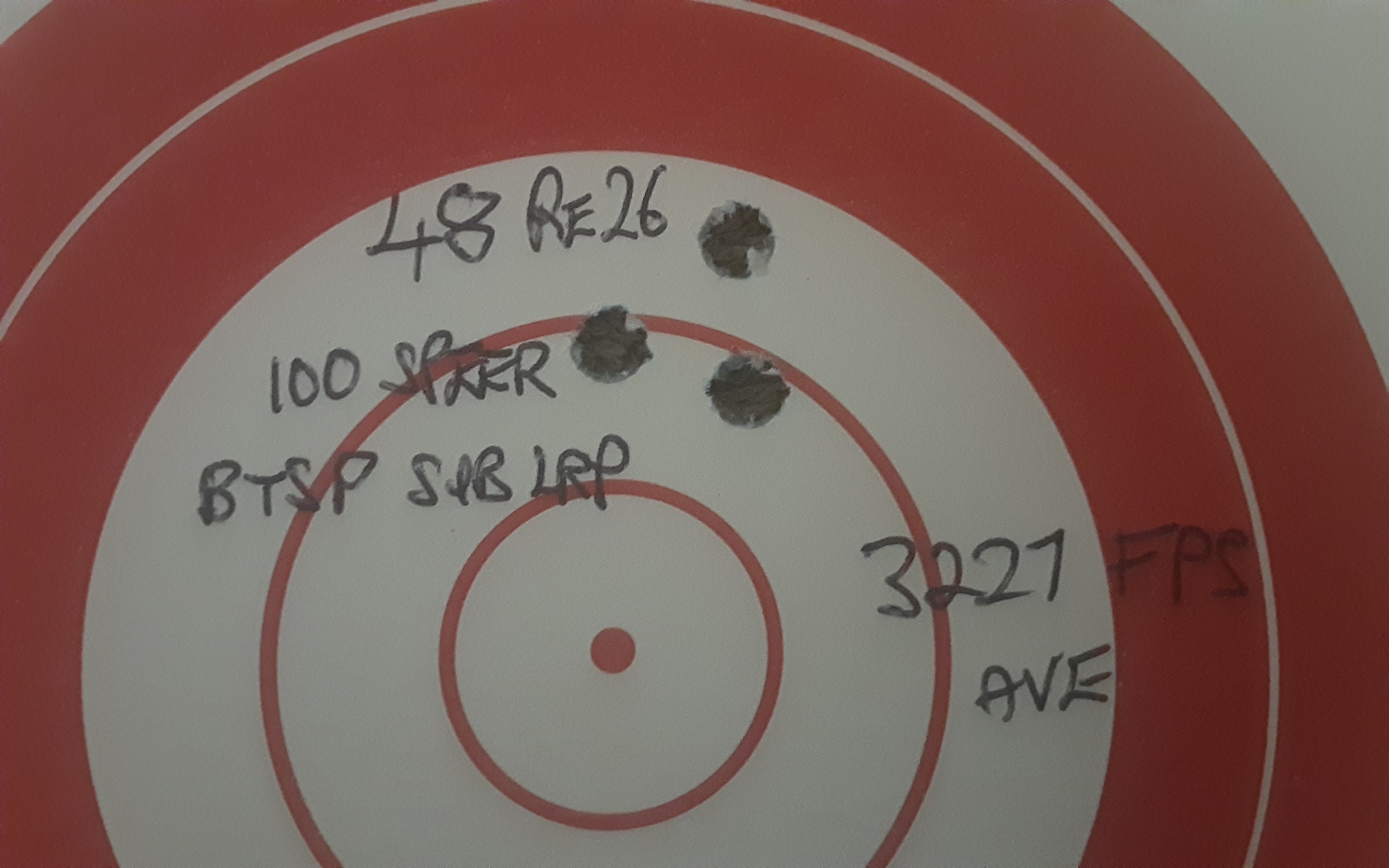

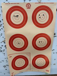

I sit on under 5 SD, never break in a barrel, did notice speed changes but not POI or SD or accuracy
I clean my rifle every time I get home, if it was fired once, it will get cleaned with G96, if it got fired over 100 times it will get clean with G96 then the chamber cleaned with CLR and re primed with G96
I don't weight bullets or brass or do anything silly with the primer pocket, just a quick clean to remove carbon new primer done, my rifles shoot lights out
here is a new LA102 in 6.5, took 3 goes at powder charge to get to .3 MOA, under 30 rounds through the rifle

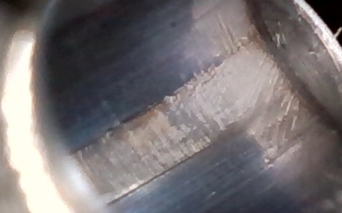

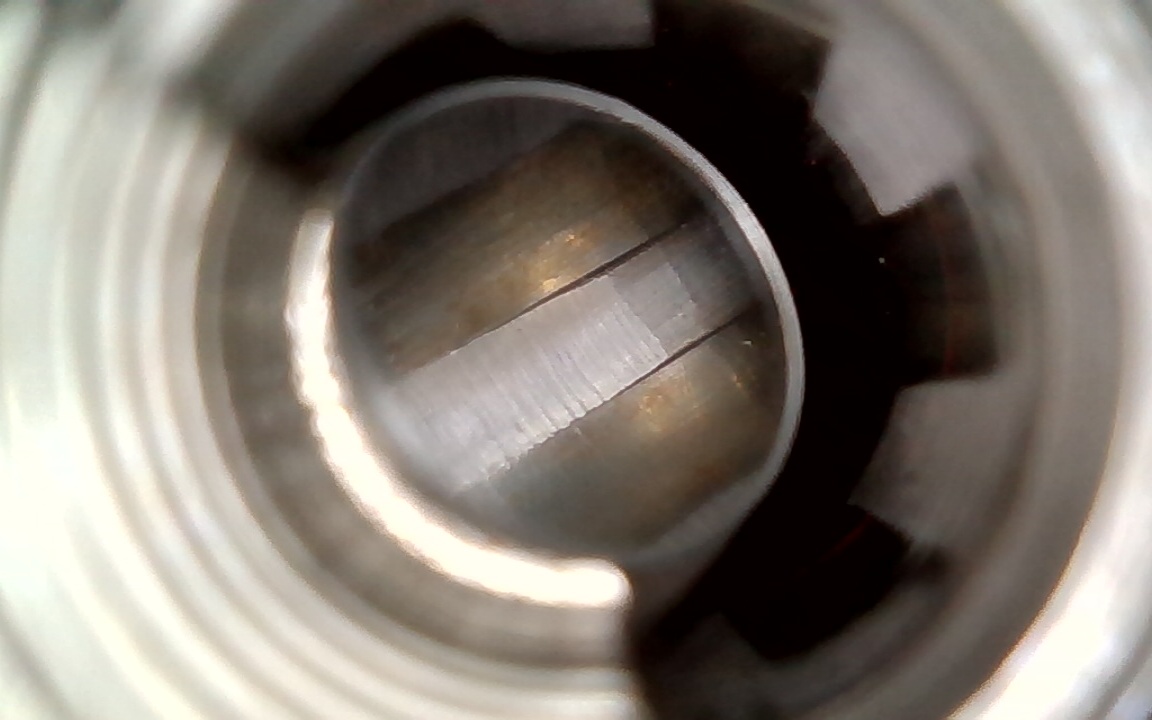

These two pics are of Tikka T3x's, one a 243, the other a 223. Neither have been fired as of yet but both are good candidates for a break in procedure. While both pics might look like an outback corrigated track, the burrs and high spots do disappear in fifty or so shots. Barrels as such don't need a break in process but throats in my experience most certainly do benefit from close viewing and a good polish, especially if it's a 22lr.. The bottom pic is of the 223 throat and is untouched, the 243, top pic, has been lapped with JB paste and will be fired tomorrow. The 223 will be fired tomorrow also I believe but the throat is being left as is as I feel there is nothing deep enough there for copper to stick to. There are a few tool marks and scratches to be seen but this is one of the better 223 throats I have seen from Tikka/Sako. The 243 throat was a real train wreck before the JB cut and polish.

Duramax wrote:These two pics are of Tikka T3x's, one a 243, the other a 223. Neither have been fired as of yet but both are good candidates for a break in procedure. While both pics might look like an outback corrigated track, the burrs and high spots do disappear in fifty or so shots. Barrels as such don't need a break in process but throats in my experience most certainly do benefit from close viewing and a good polish, especially if it's a 22lr.. The bottom pic is of the 223 throat and is untouched, the 243, top pic, has been lapped with JB paste and will be fired tomorrow. The 223 will be fired tomorrow also I believe but the throat is being left as is as I feel there is nothing deep enough there for copper to stick to. There are a few tool marks and scratches to be seen but this is one of the better 223 throats I have seen from Tikka/Sako. The 243 throat was a real train wreck before the JB cut and polish.
Jb bore paste is fantastic if used correctly, I use it to give my barrels a deep clean and then just maintain it with bore bright, lots of opinion out there about abrasives :silent:

Post by Duramax » 21 Jan 2026, 5:31 pm
Well both rifles were shot over the weekend. The 243 shot quite well for a sporter and the throat looks pretty good after16 shots. The 223 is a problem. For a medium weight barrel it should have done better with 80 grain ELDMs as 1.5 to 2 MOA groups when running through powder charges from 23 to 24 grains of 2206H is not acceptable. The throat was collecting substantial deposits of copper as can be seen in the pic below during the process and is still looking average. It puzzles me why Tikka uses a short throat on an 8 twist barrel suited to VLDs. It also restricts the powder column in the case when having to seat the bullets so deep. So I'm going to run my match throating reamer through it and try again this weekend.
Both barrels were clean of copper for their entire length so they are good to go. As per my first post, chamber throats are where accuracy starts and ends so I will reiterate that barrels these days don't need breaking in, but throats most certainly do. The pic below clearly shows it.
