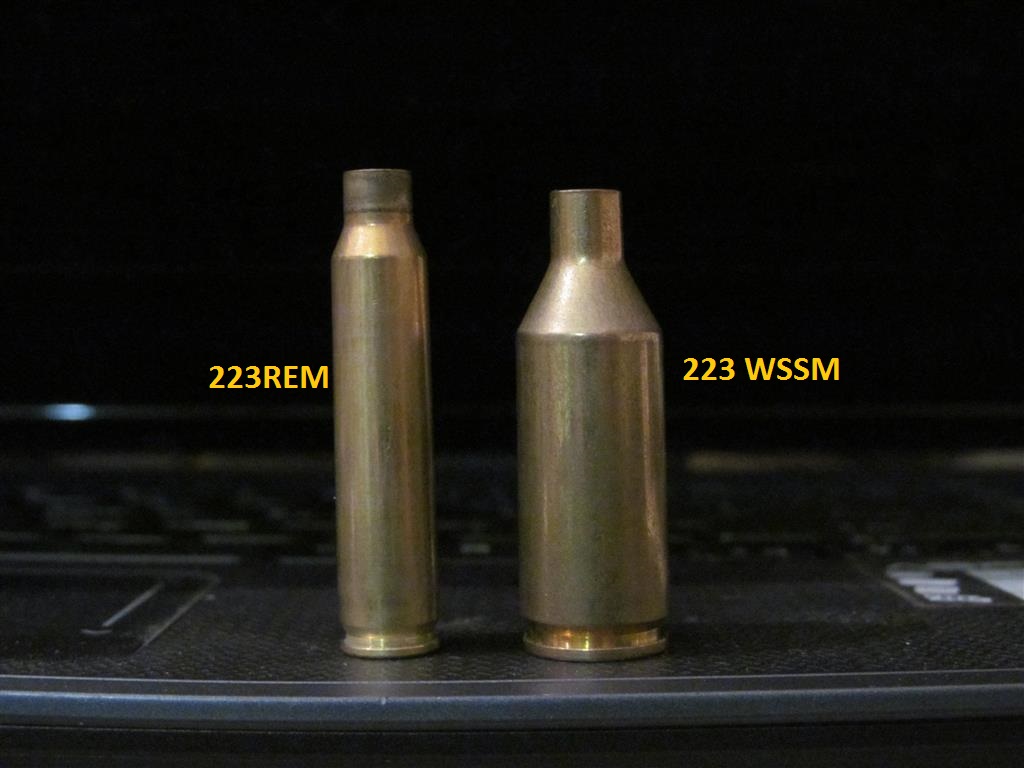

Hey I recently bought a Tikka t3 in 223 and I also recently heard about this round called the 223 wssm can anyone break it down for me also can i run it through it my tikka. Thanks

wssm- winchester, super, short, magnum. It is exactly that a short, fat, .223 magnum.
It won't fit in your .223. Only use ammo that corresponds to what's stamped on your rifle, like .223rem.

Yeah, different case all together, 2mm shorter than the Rem, 2mm longer overall.
Based on a magnum sized rim/bolt face a opposed to the mini rim size of the rem..
Very hot for a 22 cal, early production rifles burnt barrels out apparently and required chrome lining.

Nope, different round altogether. The 223 WSSM is a necked down 300WSM case to accept a 224 projectile and shortened to case length of 1.670", twist 1-7" to 1-9" and M/V of around 4,600 fps.
The big draw back was the barrel life, around 300 rounds.
I think most if not all of the WSSM cartridges have just slipped out of fashion.

Post by deye243 » 25 Apr 2015, 8:03 pm
The pic says it all . the mag will push a 50g NOSLER BT at over 4000fps
