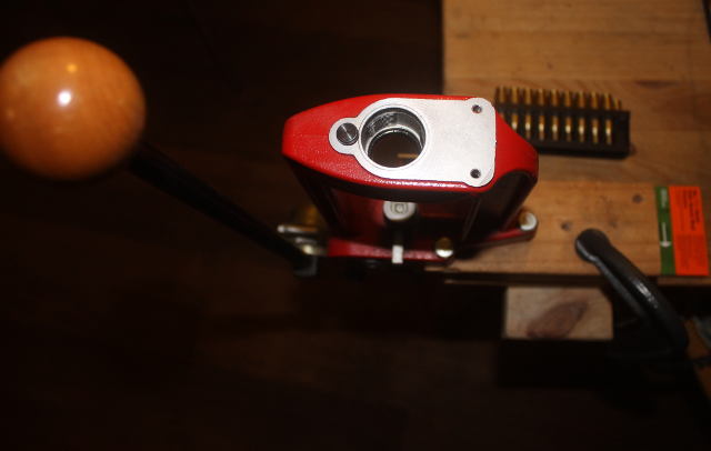

The Lee Reloading kit is good value for money. Just set one up for a mate on a piece of 200 x 40 timber about 500 long. Press at one end, powder thrower at the other. A decent 4 inch G-clamp holds it solid on any bench/ table.
Re: Mobile Reloading
Post by happyhunter » 12 Aug 2016, 7:38 pm
Gamerancher wrote:The Lee Reloading kit is good value for money. Just set one up for a mate on a piece of 200 x 40 timber about 500 long. Press at one end, powder thrower at the other. A decent 4 inch G-clamp holds it solid on any bench/ table.
Something like this?

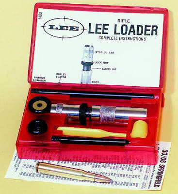

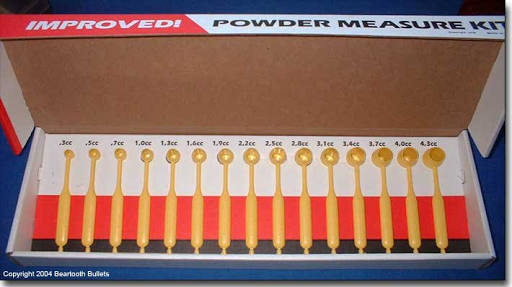

I'm a big fan of lee loaders.
If you get the right size powder dipper and practice using the dipper with some scales you can dip some reasonably accurate powder chargers.
Or just pack the scales.
