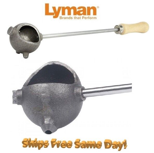

Lee bullet moulds are about $70 I think. CBE do really nice brass moulds but are very expensive compared to Lee.
https://www.castbulletengineering.com.au/products/pistol-moulds/35-and-9mm-cal
I started with a stainless steel ladle and a gas torch but Lyman do a very nice ladle with a pour spout that I use with a MAP gas torch when doing small batches of bullets for testing.

You'll also need some Lee Alox lube or powdercoat if you'd rather PC your bullets. Some of the Lee sizing die sets come with Alox or dealers should have it for about $15.
https://www.ebay.com.au/itm/185038280547
To powercoat instead you'll need a toaster oven, but they're pretty cheap.
