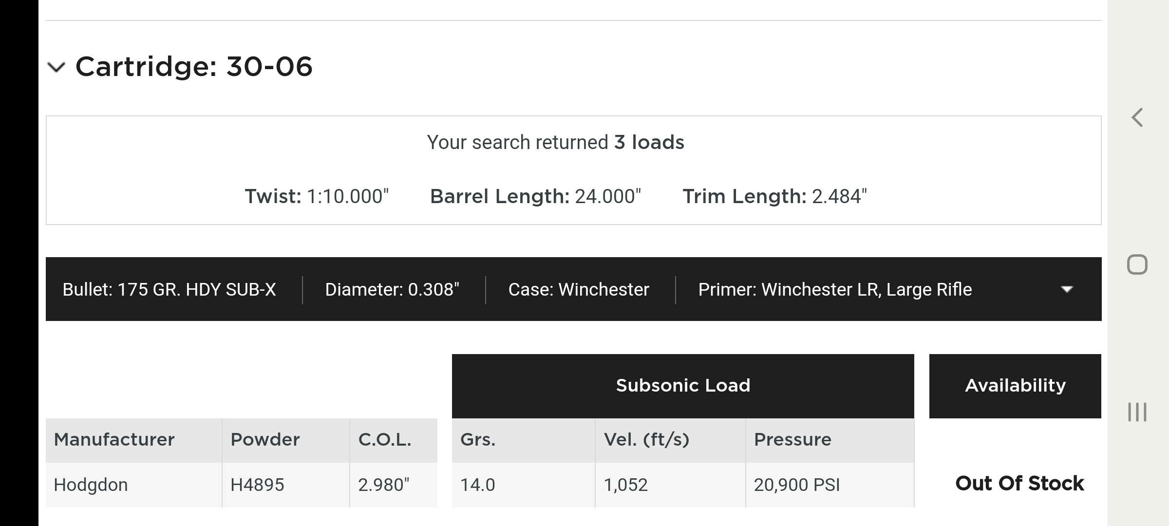

Re: 300wm subsonic with 2213sc
Post by Oldbloke » 20 Jul 2024, 3:36 pm
Go to the Hodgdon Web site.
Thet list 2206H as being able to load subsonic with larger chamberings, unlike ADI.
2206H = H4895
Screenshot_20240720-153123_Samsung Internet.jpg (233.25 KiB) Viewed 6105 times

Post by bladeracer » 20 Jul 2024, 5:03 pm
Oldbloke wrote:Go to the Hodgdon Web site.
They list 2206H as being able to load subsonic with larger chamberings, unlike ADI.
2206H = H4895
Yep, I used AR2206H (H4895) to go subsonic with 180gn 8x57mm and 150gn .30-06 (with "max" loads around 48gn and 51gn with AR2206H these are the largest cartridges I load for). It works very well but Trailboss is (or was, since it's no longer made) much better, and way more efficient. Depending on barrel length, around 18gn gets me subsonic with 180gn bullets in 8x57mm. The .300WM is about 50% larger (depending on your brass dimensions) so I would think you'll find subsonic around the 30gn area with AR2206H and 180gn bullets.
I reckon AR2207 (H4198) might also be a good choice if you can't get AR2206H.
Going subsonic with heavier bullets tends to work better as the larger bullet reduces case capacity and requires more powder for the same velocity but you can load light bullets for subsonic enjoyment as well.
You could consider making some chamber adapters to allow you to fire subsonic 300BLK, but if you plan to shoot a lot of them it gets fiddly punching the empties out of the adapters to reload them.
