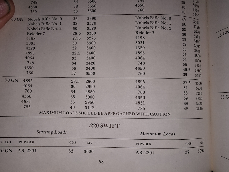

I have been gifted some W785 and IMR 8431 powder!!
Does anyone have load data for Howa 1500 in .22-250 in 50-55gn sps !
It’s only center fire I own and would love the powder not to go to waste!

Both powders are not suitable for the 250 the imr 8431 is slower than 2209 and the 785 is more for mag rifle cases and heavier pills in 30 06 .

Do you mean IMR4831?
As Deye243 already points out, both are very slow magnum powders.
The only .22-250 load data I can find are in Nick Harvey's First Edition manual and only for 70gn bullets. It will work with lighter bullets but I would think it would be less than optimal, you'd have to do your own experimenting. I would think if you have a 26" barrel that would help to burn the powder as well.
35gn up to 39gn of IMR4831 making 2950fps to 3280fps,
40gn up to 42gn of W785 making 3142fps to 3240fps.

Thanks I will let my mates use for their bigger caliber instead. Thanks again
