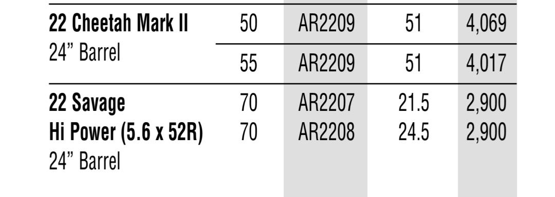

Thoughts on a straight swap from 2206 to 2206H? yes I would reduce a bit but i'm thinking starting load for 2206 would be a straight swap even though 2206H is a bit slower.

You have load data there for 4895, which _is_ AR2206H. You really don't need data though. Put about 25gn of AR2206H in there, seat the bullet, shoot it and see if you like it. Even better, fire it across a chronograph and get some actual data you can work with. If it goes bang and doesn't give you any pressure signs, load five up and see if they group. Then work up or down from there until you get where you want to be.
Blade is right, but I would do 24gr. :violin:

I found this.
Screenshot_20241216-114918_Samsung Notes.jpg (87.91 KiB) Viewed 5121 times
