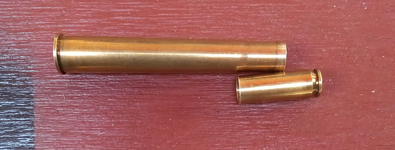

Post by Oldbloke » 03 Nov 2023, 2:33 pm
Poor mans bump guage.
A cut off case unbelievable.

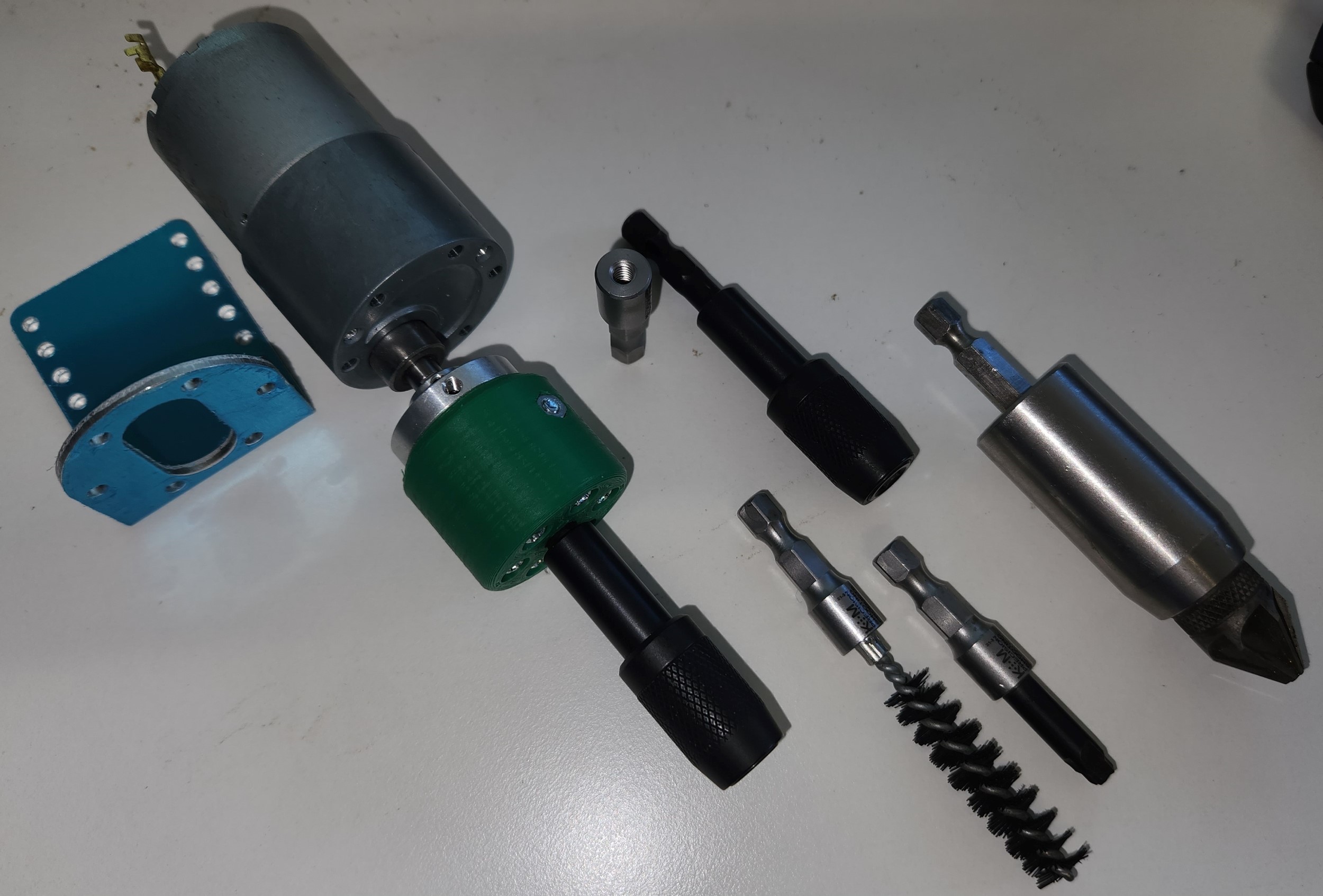

My latest foray in the DIY Reloading Tools..
I've eyed off the powered Case-Prep stations for some years; get a bit tired of using an assortment of Cordless drivers to do the same job.
I have nearly all my case-prep tools fitted to Hex drives(BRT sell them - great pieces of kit).
But I'd prefer a station where I'm only needing to hold the case in position, rather than the case and the tool at the same time.
The past 5 years, I've been messing around with a 3D printer, and last year, came up with an adapter design to make use of a number of "Pololu - 37D" 12vDC Gearmotors I have on hand here.
Not long before I finished the design, the damned 3D printer took a dive, and it's taken many months for me to man up and fix the damn thing.
Anyway; now that I have the printer resolved(Surprisingly, with NO axe-holes through the front panel!), I have been working through a back-log of projects that I wanted to print to test them in the real world.
In the list, was this adapter(Green part in the pic).
Printed in ASA(evolution of ABS), this plastic should be plenty strong enough for the job.
All my adapter does, is to adapt from a 6mm 'D' shaft hub, to a 1/4" hex socket.
But I couldnt find anyone selling something similar; adapt from a 6mm shaft to (preferably) a 1/4" QD hex socket.
So it became simpler to design my own..
The Robot/Electronics sites have the hubs to fit the 6mm D-shafts of these motors, as well as the gearmotors themselves.
This one is a 100:1 reduction on the gearbox, which gives me a 100rpm No-Load speed.
There is a 131:1 and a 150:1 version available of the same gearmotor; giving around 67-75rpm.
There are six 3x25mm bolts that hold the green adapter onto the hub.
The hub has two grub screws to lock the hub onto the shaft.
There is also a 3x25mm crossbolt going through to hold the QD hex socket into the green adapter.
I used a Milwaukee QD hex socket, but any of them should fit.
I plan to mount this up in a box, and have the shaft coming out the top.
Next on the design, will be a motor mount that allows for a height-adjustable vertical mount.
[The blue factory metal one is a bit limiting in placement.]
Being a QD hex drive changing out the various bits is quick, though I am tempted to make up a dual one.
I've included a heap of the other bits and pieces to show it off a bit.
I have a good mate who's just delving into the deep, dark world of reloading, and I thought I might make him up one of these to help him out.
I've previously printed things like individual caps for the RCBS powder dispenser(one for each powder type I use), as well as wall-brackets for hanging the RCBS priming tools.
There are a few other DIY tools in the pipeline, but this is the latest..

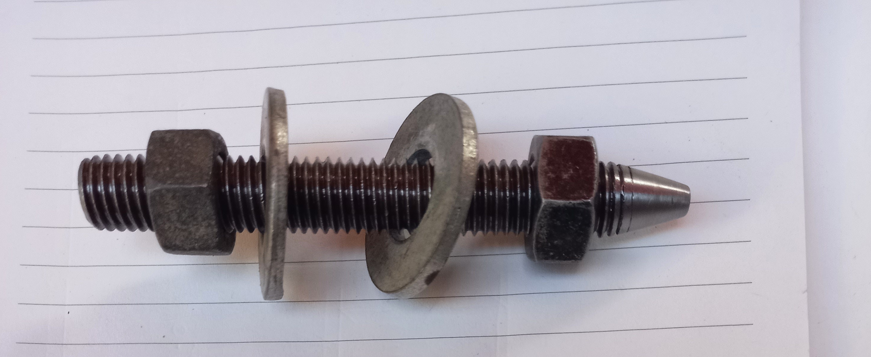

Sooo been loading cast for yonks but just on off occassional thing.
Loaded a few test rounds the other day and needed to flare the neck. Don't have one and got away with working the deburring tool a bit to create a chamfer in the neck. (223)
The dies are abt $50 and since I don't do a lot was thinking what can a DIY. A new die would never pay for its self.
First thought was buy a 7/8"-14 UNF bolt and have the SIL machine a point on it as he has an old lathe.
Well, I don't think that's going to happen. :unknown:
Anyway to cut the story short had a rethink.
Found about 4" of 1/2" all thread, bit of grinding and 400 wet and dry in the drill I ended up with this. (See pic)
Centred it in the press, it works fine.
Just slip a case in the holder, and raise the ram and give it a gentle bump. So, a bit fineness required.
Down side, normal flare die has a "stop".
Back in business. :drinks:

Post by Oldbloke » 03 Jan 2025, 1:43 pm
Yes, about as basic/old school as you can get. If it needs it, later I'll grind a tad more to make the angle a bit shallower/pointy.
Got away without one for years for the 30.06. But discovered pretty quickly I need one for the 223.
I wonder what they did 100 years ago? I'm guessing a punch.

Another powder trickler. Found it elsewhere. This is my version.
This is a 9.3x74R case with the primer removed and drilled out the flash hole to 2mm. The cut off 223 case is just used as a cork, primer intact. Any small container will do though.
If you use it like a salt shaker just 1 or 2 granules of AR2208 come out at a time. I guess other powders will vary.
