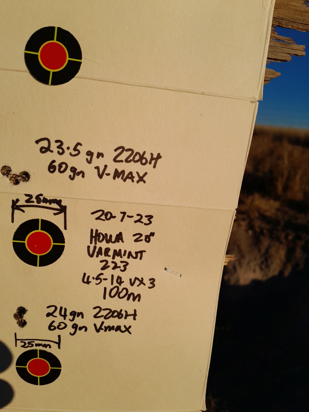

nah, looked but can't find a pic of a 55gn load test.
But if it helps, I found one using a 60gn VMax, which hangs together a little bit better.

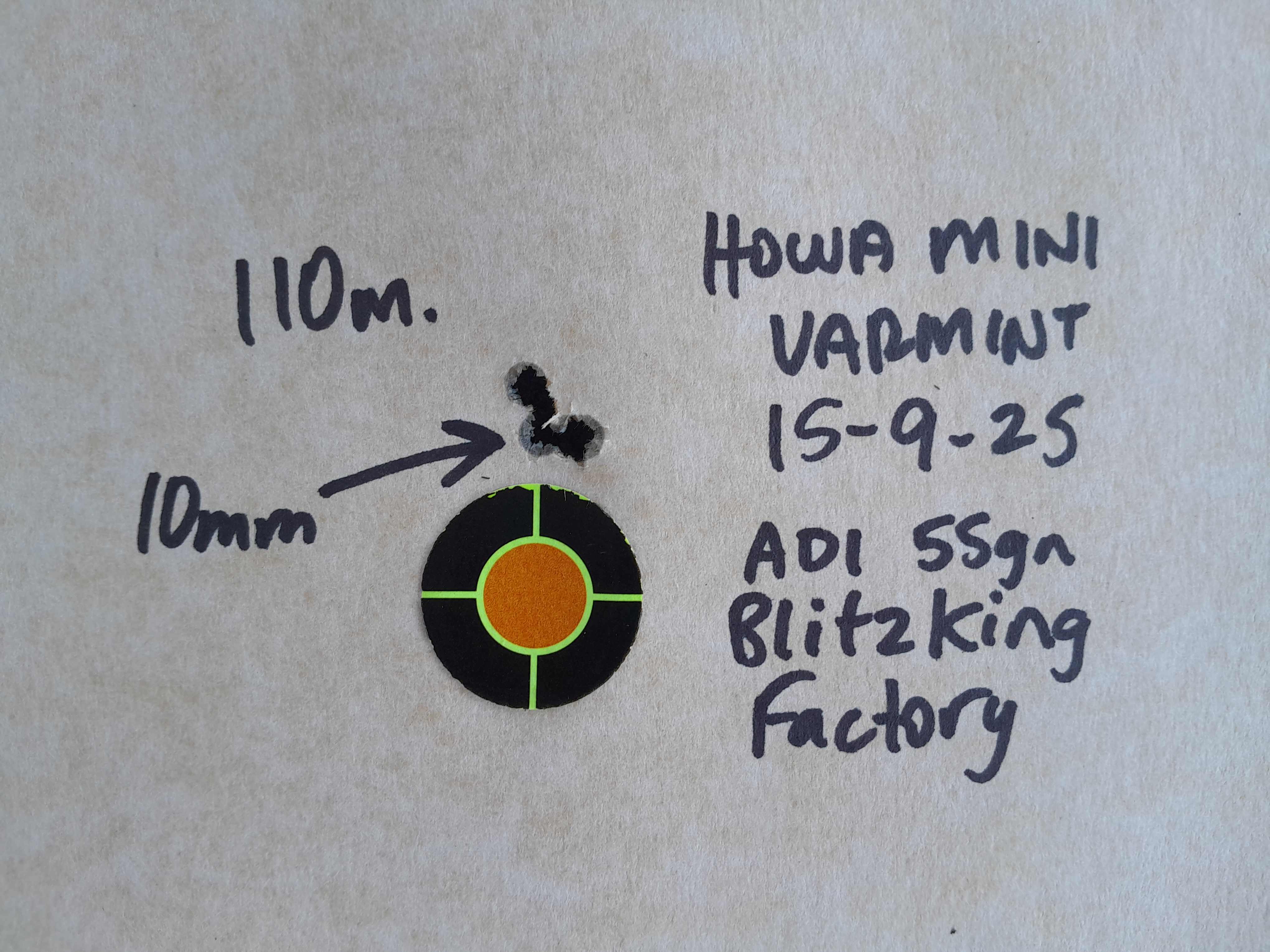

Post by Wapiti » 06 Nov 2025, 1:57 pm
Comparable to the below, and helpfully same POI swapping from reloads to factories available at our local Pursehouse farm supplies depot.
ADI factory 223.jpg (690.87 KiB) Viewed 6913 times
