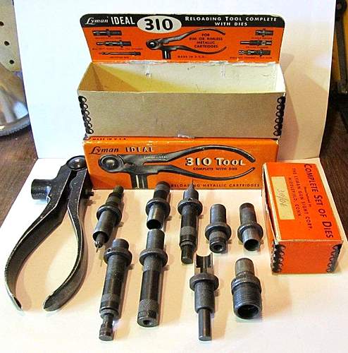

It is a lot cheaper than buying factory in most cases, as wanneroo states it allows you to tailor a load to a specific firearm to improve performance, it is easy for newcomers to try, just make sure you buy a manual from a known name such as Speer, Norma, Hornady, Nick Harvey etc and stick to it, don't experiment or vary the data until you are well versed and experienced yourself in reloading which takes time. Equipment can be as basic and cheap or as expensive and complex as you like but I would recommend starting at the most basic set that requires each stage to be completed in order so as to learn, understand and master those elements before even thinking of progressive reloading presses. I started with an $11 kit which comprised a set of glorified pliers into which a die was screwed and a set of powder dippers and made perfectly acceptable hunting ammo for a couple of years in 30-30, 303 and 8x57 plus a Lee kit which needed a mallet to use to make 308. Scales are nice but not necessary to make good usable ammo, but as you progress they will become essential for chasing accuracy and consistency.

Post by No1Mk3 » 04 Mar 2026, 1:08 pm
Lee Dippers.jpg (7.44 KiB) Viewed 123 times
Lyman 310.jpg (42.57 KiB) Viewed 123 times
What I used to reload for about 2 years. The powder dippers worked fine without a scale however most powders listed with them are no longer available to us and a scale may be needed these days, a balance scale is very accurate and well priced but even the cheaper digitals will suffice with some mucking about with having to constantly re-zero.
