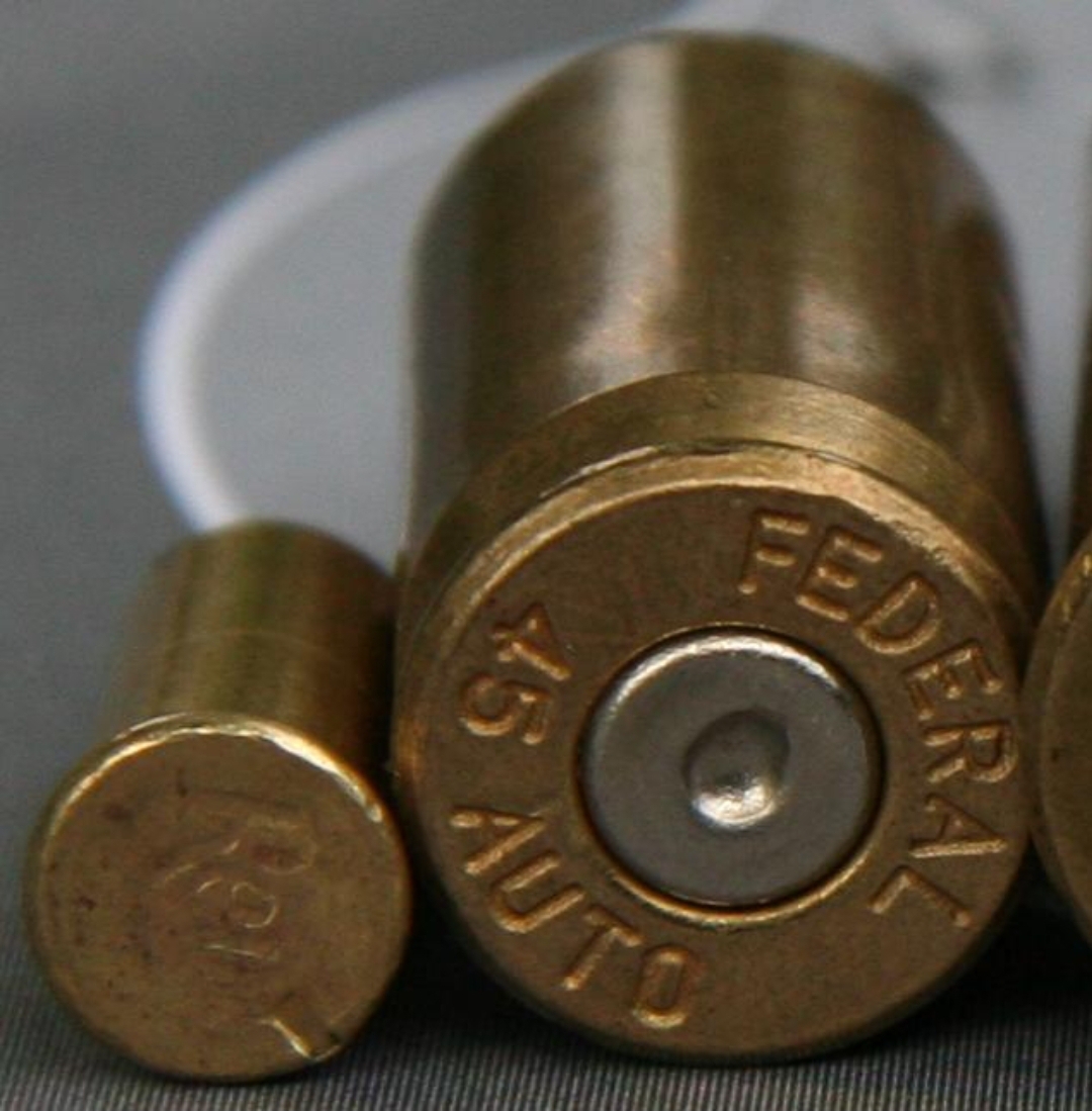

Post by Oldbloke » 18 Feb 2021, 9:19 pm
Off another forum. I would consider this an overload.
Re: Starting weight for load development please?
Post by boingk » 18 Feb 2021, 9:31 pm
For someone who may not know what they're looking at with that picture, the dead-flush-and-filled primer pocket coupled with the slightly cratered firing pin indent is a good indication its overloaded.
That round may or may not have also had a hard extraction - you would likely feel something different if extracting a round similar to the above, a sticky/hard bolt turn or hard pull to the rear for example. You also may not.
Post by Col » 18 Feb 2021, 9:34 pm
Oldbloke wrote:Off another forum. I would consider this an overload.
Oldbloke this is a very useful photo, especially for those starting out, as it shows overpressure signs really well. Thank you for posting.

boingk wrote:For someone who may not know what they're looking at with that picture, the dead-flush-and-filled primer pocket coupled with the slightly cratered firing pin indent is a good indication its overloaded.
It could also be due to a case with excessive headspace.
The only reliable way to know would have been to accurately measure case head diameter before and after firing.
