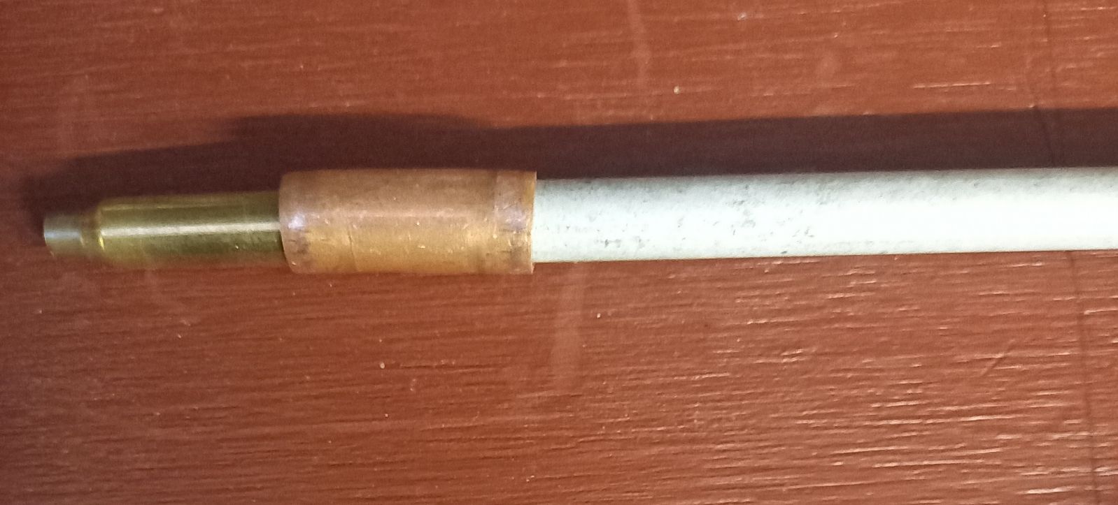

Post by Oldbloke » 27 Nov 2024, 11:02 am
WmT,
If you don't anneal fairly often you will get this "bounce back" effect. Has caused me no end of problems.
If your loading a lot by all means buy the gauge. But with a bit of fiddling you can get away with a pistol case. Your only trying to compare. I'm using a DIY my SIL made on lathe and it works fine.
I put this together, might help.

Oldbloke wrote:WmT,
Yes Oldbloke, I will be annealing, for the first time in my long life :lol: and thank you for your input.
BTW, I cobbled up a gizmo out of scrap wood and made a device that holds my hand drill, which is used to rotate cases :D

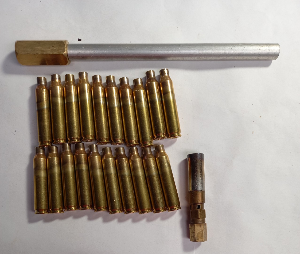

Wm.Traynor wrote:
Oldbloke wrote:WmT,
The attachment IMG_20241127_115546.jpg is no longer available
Honestly you don't need a drill.
I just have a bit of brass that has been drilled on a lathe to hold a 223 case, got one for 30.06 too. Handle is ally tube about 8mm.(smaller the better)
Slowly rotate the shoulder in gas flame for 5-6 seconds till its blue/dull red, Job done. My first one was a bit of drilled down.
You get the idea.
I do get the idea you clever rascal. That would simplify things markedly :D :clap:

About as basic as if gets.
1/2" water pipe for 233 case with a handle jammed in one end.
