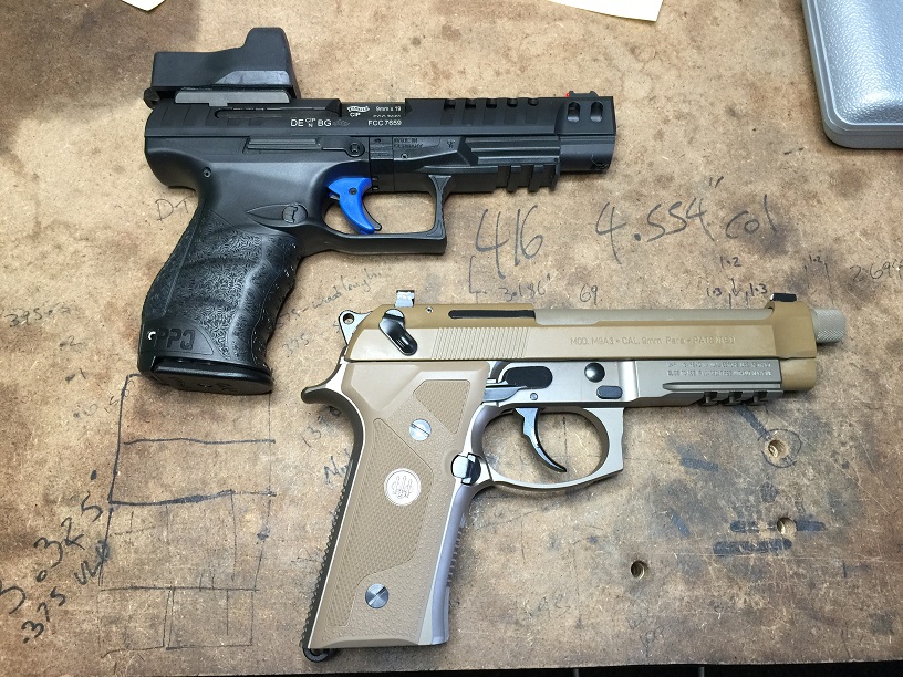

Post by brett1868 » 14 May 2016, 5:30 pm
Slight hijack...sorry.
Here's the Walther PPQ Q5 with the DeltaPoint Pro mounted (Just saw that the cover is on), I like that the slide is pre-milled and there's 3 bases in the box to accommodate a variety of sights. Below it is the M9A3 that I was planning to shoot tonight but have to wait till tomorrow due to interference by executive management.

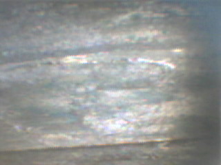

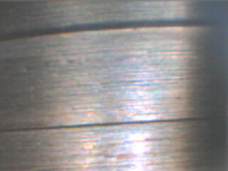

While I'm here, what's the best way you've found to get the lead out of the barrel. This is my barrel after todays effort. These copper coated projectiles aren't too bad but the straight lead ones I've used in the past were terrible, after 200rounds I couldn't even see the rifling in the barrel!
Hollywood
Posts: 64
Re: Dirty 9mm reloads, what am I doing wrong?
Post by brett1868 » 18 May 2016, 9:31 am
A good swabbing with solvent, let it sit for 10-15 mins to soak in then hit it with the brush and repeat 2-3 times if required. Alternatively, after shooting lead try and finish off with a mag of JHP or FMJ ammo to clean the lead out. On the big rifles I have some brass VLD rounds that I use to clean out copper fouling. Same principle applies to handguns, use a harder metal to remove the softer one. Copper is easy enough to clean with a good copper solvent.

Post by Hollywood » 18 May 2016, 12:47 pm
Thanks brett1868, appreciate the advice on this thread. I'm struggling to get the fouling out of the concave sections of the rifling without physically scraping it out from the muzzle end. What solvent are you using?
Hollywood
Posts: 64
Post by brett1868 » 18 May 2016, 1:09 pm
Hollywood wrote:Thanks brett1868, appreciate the advice on this thread. I'm struggling to get the fouling out of the concave sections of the rifling without physically scraping it out from the muzzle end. What solvent are you using?
I start with Birchwood Casey Bore Scrubber which comes in a big spray can, liberal spray in the chamber / bore and let it sit for 10-15min before giving it a good scrubbing with a bronze brush, I do this a couple times if required. Any of the better bore solvents will work just as well, Hoppe's No.9 is good and can be purchased in 500ml bottles. If my OCD kicks in I'll put the barrel into a plastic bottle filled with No.9 and then put that in the big ultrasonic cleaner. Set the temp to 35c and give it a 20min bath...give it a wipe down and oiling brings it up like new. I've got a dirty barrel at home so if I get time tonight I'll do some before and after pictures using a bore cam so you can see the results up close.
Post by Hollywood » 18 May 2016, 2:56 pm
I'm using Hoppe's No.9 but still struggling to remove the stuff in the grooves.

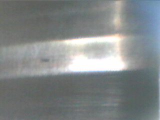

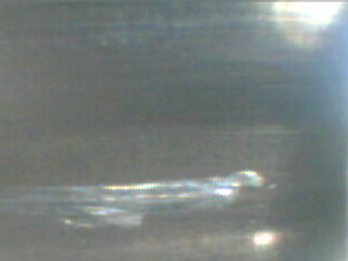

Post by brett1868 » 18 May 2016, 10:33 pm
Spent the best part of the past 2 hours scrubbing 3 pistol barrels and took some before and after pictures. Both the barrels below were using the same load of TopScore 122gr coated LRN pushed by 4.4Gr of AP70. Both barrels showed similar amounts of lead fouling and took different amounts of scrubbing to get clean. A shot of bore scrubber followed by a bronze brushing then patched dry to get the rough off. Several mopping's of Hoppe's No.9 with a good scrubbing in between. A bore scope is both good and bad, it's good at showing how bad you clean a barrel.
Beretta M9A3 Before
Beretta M9A3 After
Walther PPQ Q5 Before
Walther PPQ Q5 After
Post by Hollywood » 18 May 2016, 10:56 pm
Maybe I need to spend some more time on my barrels. I just can't seem to move the fouling that is in the photo I posted above. I can pick it up with a jewellers screwdriver but a bronze brush just seems to pass over it.
Hollywood
Posts: 64
Post by brett1868 » 18 May 2016, 11:18 pm
Don't be afraid to soak the barrel in Hoppe's for an hour or 2 before brushing, maybe time for a new brush?
