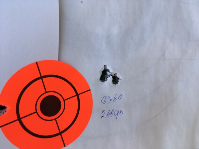

I tested 2 x 3 shot groupings for each length bullet.
The longest was just touching the lands at 83.93 (absolute max in this is 83.95).
I went down .3 each load to 79.7 - I just didn’t put up 20 photos.
The 83.60 was clearly the best of the bunch but, there was significant vertical stringing as can be seen from a fellow shooter in last photo.
The cases are all once fired hunting (fusion) cases - full length resized.
That being said - neck tension WAS different per load, I could feel it as I was seating some bullets - some would almost fall in and others were a little extra...which didn’t overly concern me.
I guess my question now - if you bought a hunting rifle, brand new and grabbed some middle of the road counter ammo, went out and tried to zero your scope but couldn’t get better than 2-3 inch groups, would you return said rifle or it is what it is? There must be a LOT of hunters who don’t reload and based on my groupings - they’d be missing a shed load...
Yes - the 83.60 groupings look like getting better and there is now more development needed (up in charge I suspect based on advice) but how many ppl would not be happy / would be happy with this performance? (Assuming of course I am not a half wit and can pull a trigger now and again lol)

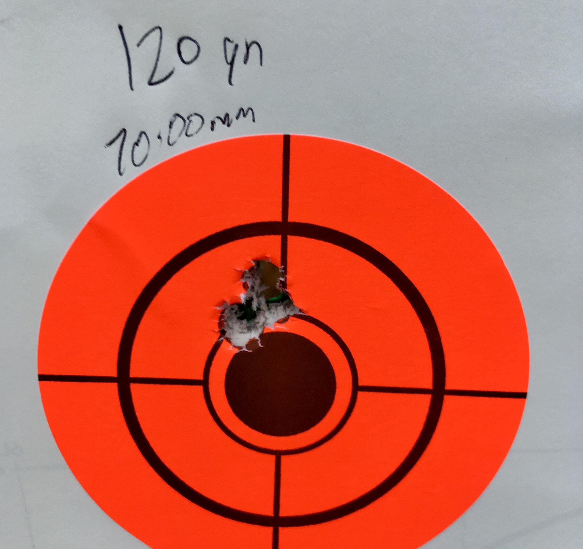

Here’s another pic - Warmed up with my .260, but it has much more powerful scope 6.5-20.
The 06 shoots a M8 6 x fixed.

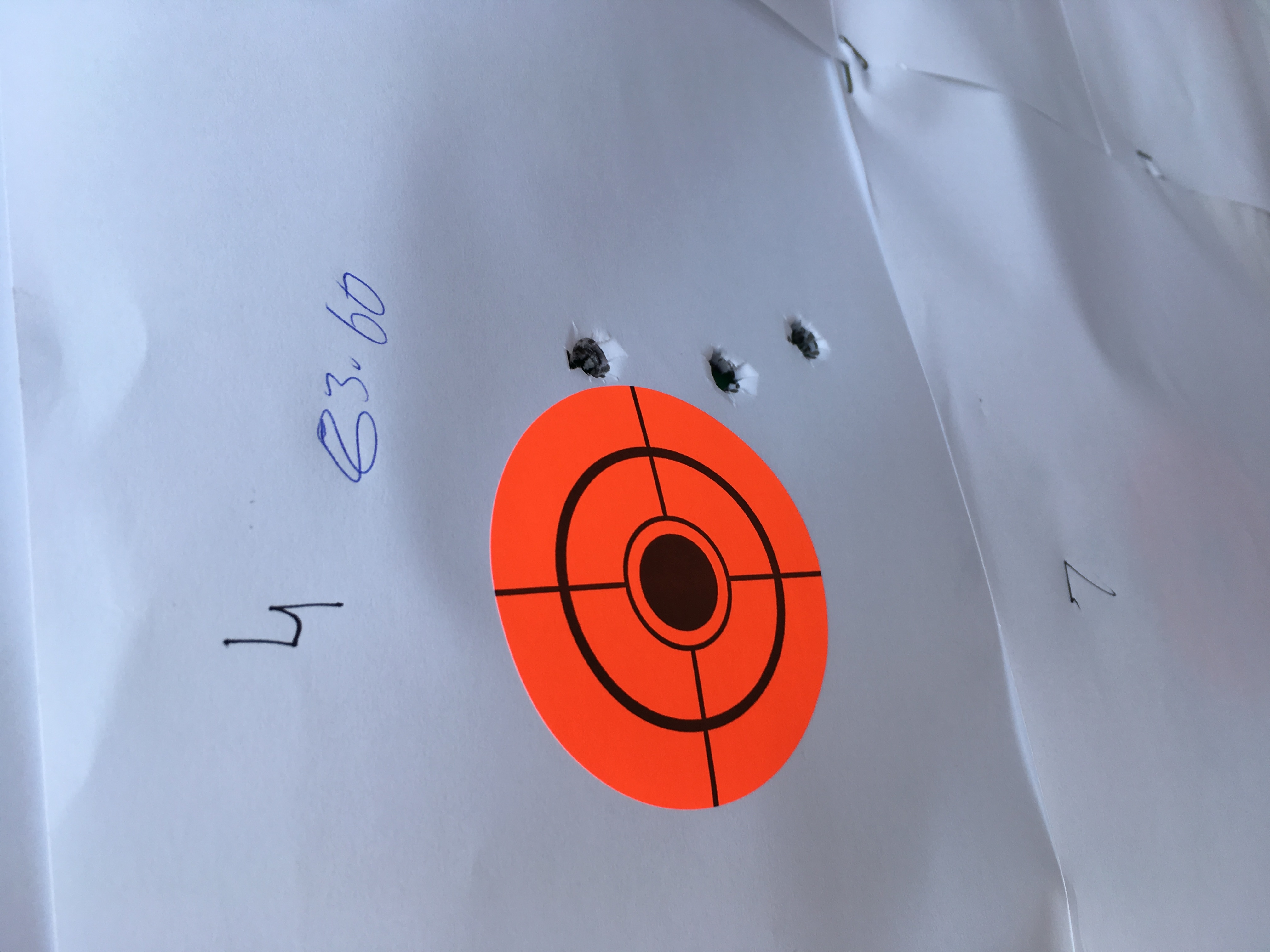

If you look at the 3rd photo - 83.60, that group measured 21mm. Good enough for deer and roo as long as it will be consistent.
The issue for me, especially early in, was the 3+ inch spreads from some of the other ammo - in particular some of the factory ammo that is 2-3mm shorter in length was spraying.
I’ve now fired 3 types of factory ammo through this rifle and cannot better 2.5 inch groupings. Hand loading - yes, i’m getting there...I will make it shoot darn the world!!!
Now, if you weren’t a hand loader and bought a brand new (yes - light weight, carry around sporting gun with fluted barrel) rifle for $1400 that was shooting 60-75mm groupings - would you be content? Serious question...

Post by TassieTiger » 14 Dec 2018, 2:32 pm
Bill wrote:tassy tiger quit full length sizing ya brass, its generally not need and certainly doesnt aid accuracy
SCJ429 yes I suspect this 6.5 grendel has more in it but with the current stock and plastic bottom metal are holding it back.
I hear ya. Neck sizing from now on only. It was the way I was shown early on but I now understand adjustments of the dies so can control better.
Went back to lgs from whence I bought rifle (I do enjoy a good / candid relationship their) and discussed the outcomes / findings with the steyr 06...their opinion was that the200gn’s eldx - whilst okay to shoot for x large animals, is far from optimum when testing up a load in this barrel - because of the heat generated by the larger projectile.
This might account for the vertical stringing - because 2 shots seemed good, 3 rd shot always the flyer on at least majority of loads.
They said if the rifle is sent back for verification and they can make it shoot as claimed, Then the company (steyr) oncharge range time, ammunition (should only be 3 bullets lol), post costs, marksman time, etc could be $4-600.
He said - this is the case with 99.9% of rifles that he has sent away to be checked...in their opinion, you just don’t get poorly shooting rifles in that price bracket anywhere as near as much as people think.
He did discuss expectations with light weight hunter barrels vs heavy weight varmint styles but agreed that a consistent 1 to 1.5 Moa should be achievable at least 80% of the time.
Their recommendation was to try some SST 150gns - redo the load testing and use .3 under Max coal as a start point. If these SST’s don’t group better then they want rifle back to check locally - (suspect they’ll range test) and then if same results...she will be posted away for factory checking.
I honestly do not think it will come to that - I did get some decent groupings with the 200’s but will see how we go with 25% lighter loads and neck sized cases only.

TassieTiger wrote:I tested 2 x 3 shot groupings for each length bullet.
If I wasn't a reloader I would probably return any new bolt-action centrefire rifle that didn't shoot consistent 100m MoA straight out of the box.
As a reloader that doesn't put any factory ammo through them though I expect the same, but if they don't, I'm happy to work with them to see if they improve :-)
But, I would shoot enough rounds in a test to determine if that load has any potential or not, while ensuring I'm not making decisions based on anomaly or measuring a small part of a larger group size. If groups have fliers or are not throwing a neat pattern I just figure the consistent group size is quite large, even if I get some decent-sized clusters.
I lean toward it being more likely a problem with the rifle/scope/rest than the ammo.

Post by TassieTiger » 14 Dec 2018, 5:17 pm
I’ve only shot at my private area, not hunting with it until I understand it’s capability - this group very below measures 21mm - well better than moa at 100 (that’s the gtee, effectively 1 inch group at 100)
But then the exact same load, cool barrel, etc...shot this stringer at top (if that were a roo head shot, might have hit 1 out of 3).

TassieTiger wrote:I’ve only shot at my private area, not hunting with it until I understand it’s capability - this group very below measures 21mm - well better than moa at 100 (that’s the gtee, effectively 1 inch group at 100)
MoA is roughly one-inch at 100yds, 29mm at 100m.
That's why I don't shoot three-shot groups, it doesn't tell you how the rifle consistently groups.
If you fire thirty rounds and they all fall within a 50mm circle I would say you have found its consistent ability and can be confident that any shot you take will be within 25mm of your point of aim. Likewise, if you shoot ten three-shot groups and lay them over each other, and they all fall within a 50mm circle, then that's how accurate the rifle/load is - even if five of those groups are cloverleafs.
As already mentioned by others though, if it's not a target rifle it doesn't need to be able to shoot groups bigger than two at most. But I totally agree that tighter groups makes load development easier.
