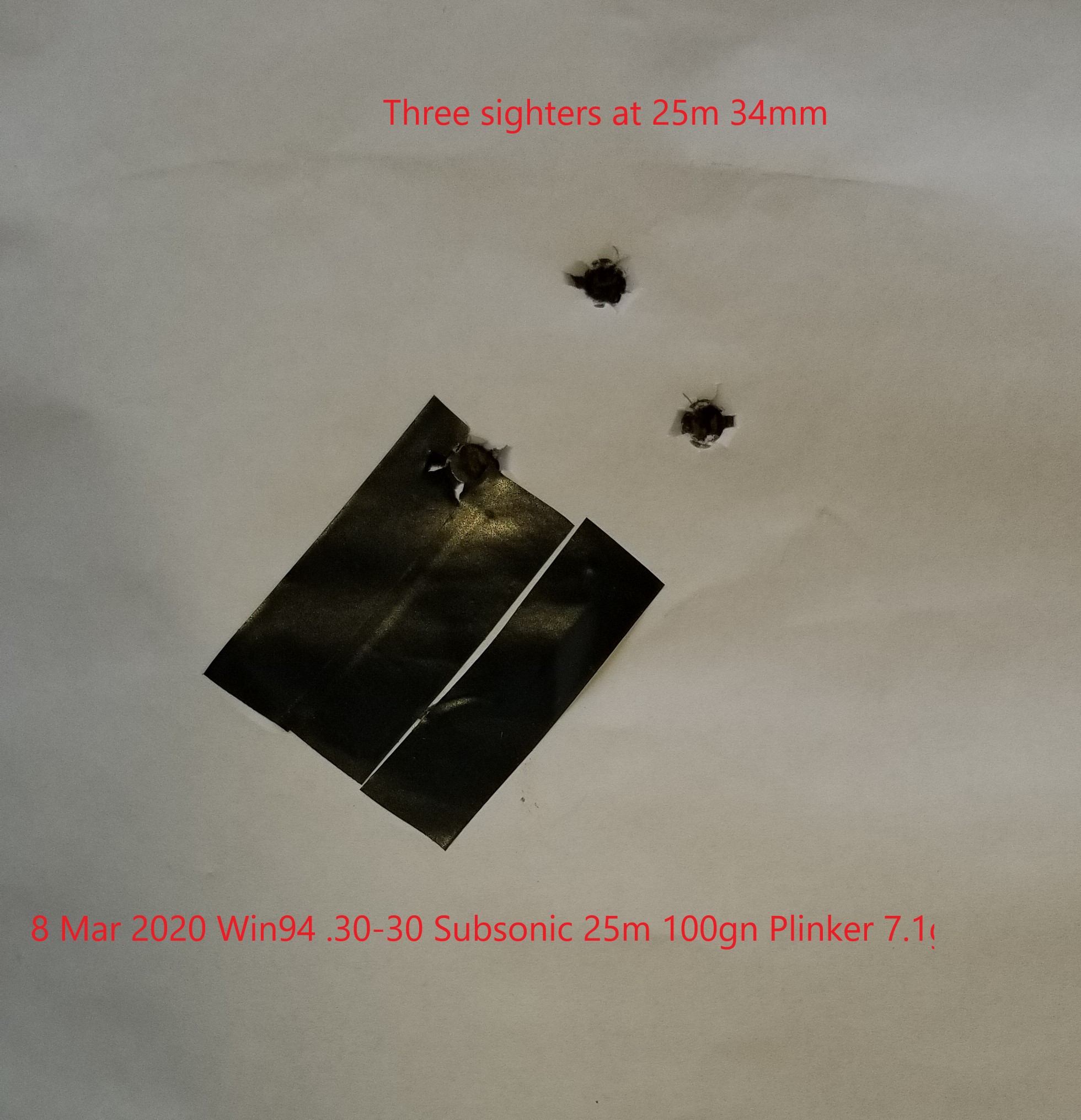

I didn't feel well enough to go right down the paddock, or to shoot optimal groups so I just fired ten rounds at 25m leaning on the fence.

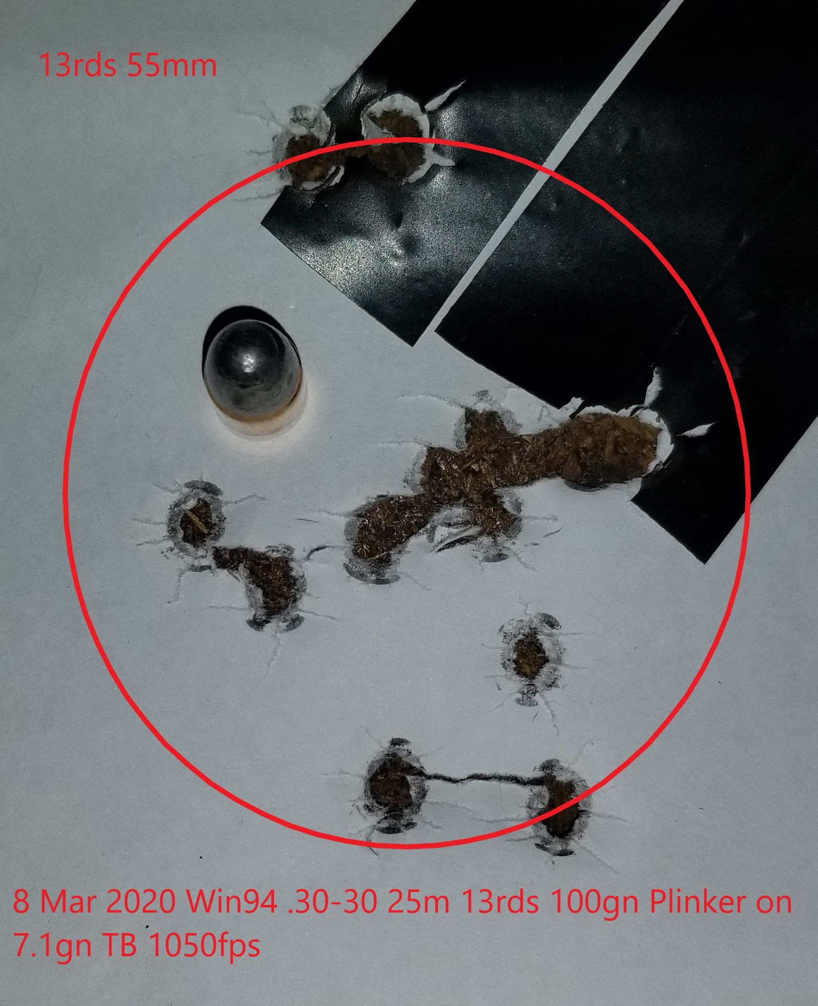

I calculated that I need to lift the rear sight 4.3mm to zero at 50m, so I adjusted the Lyman peep last night. I fired three rounds just to confirm zero, then fired ten to get a group. I wanted to be about 45mm high at 25m for a 50m zero so that was pretty close. The three rounds were in a neat 34mm triangle. I dropped another ten on top to cover 55mm, which I'm pretty happy with for a 35-cent round.
I'll have to go up and shoot them at 50m off the bench though to see what they're really capable of, but I think 50m foxes are doable already.

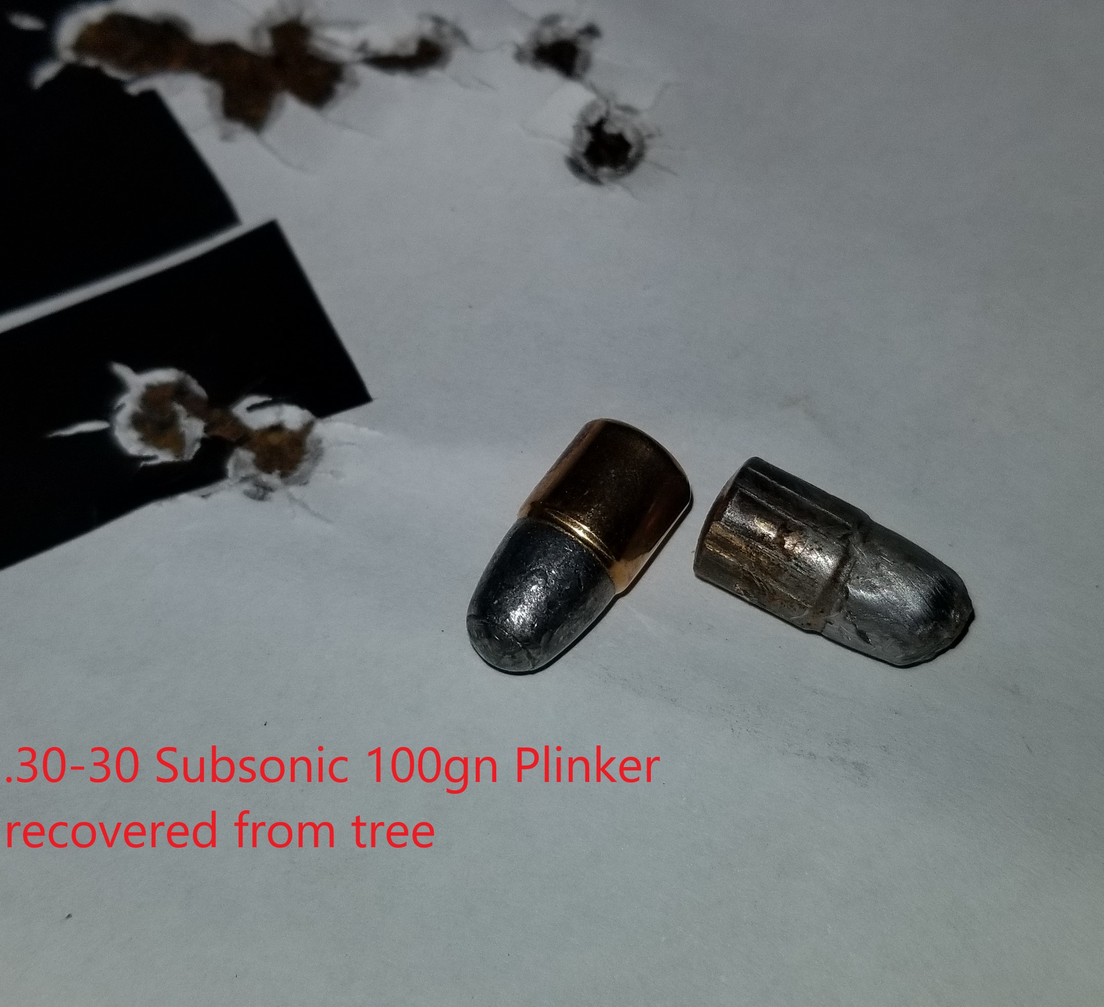

I took some chisels and managed to recover a bullet from the tree. It's a pine that's been dead since a lightning strike in 2014 blew most of the tree away, leaving just a 5m high stump for the possums to play on. The outer is rotten pulp to about 80mm deep, including the thick bark, then the inner part is still pretty solid timber - just like chiseling through a rough-sawn pine 90x90mm post. I finally found one of the thirteen bullets after chiseling in 175mm, amazing I reckon. I honestly expected to find it within the first 100mm.
Surprisingly little deformation though, so I don't think it's pure lead. Which means it offers no real advantage over the slightly cheaper Berry's 150gn, which I think might be a little more accurate.

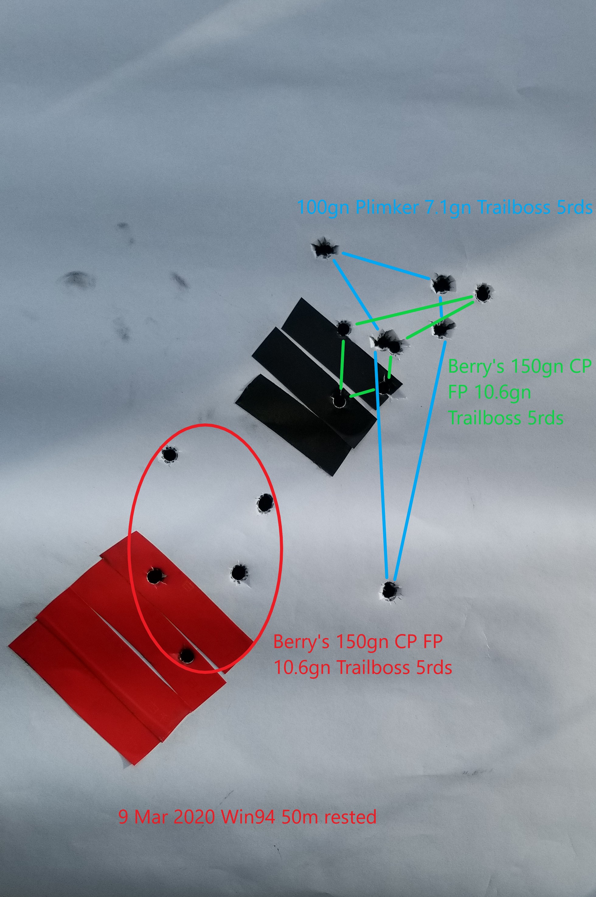

I did some testing just now with the 150gn Berry's Copper-Plated FN.
10.1gn of TB gave me 955fps but I forgot to crimp that one so it may have gone higher with a crimp.
11gn gave me 1156fps, 10.6gn gave me 1038fps.
I loaded up 25rds of these and wandered up the hill.
I fired five of the 100gn Plinker first, four of them dropping into 58mm, the fifth was way off, probably because I was struggling to see the diamond through the grass.
Then I fired five of the 150gn 10.6gn loads into 76mm, with four of them in 31mm.
I thought I could do better if I could see the 50mm black aiming point, so I made a red diamond of 70mm.
At this point I switched to the loads in brand new unsized brass, and a few of these definitely left a crack rolling down the valley. In my rifle the 10.6gn load may be right on the edge of subsonic, 10.5gn might be a safer bet to avoid the occasional cracks. These are burning more than ten times the volume of powder in a .22LR round, and are significantly more of a dull boom, but not at all unpleasant on the ear.

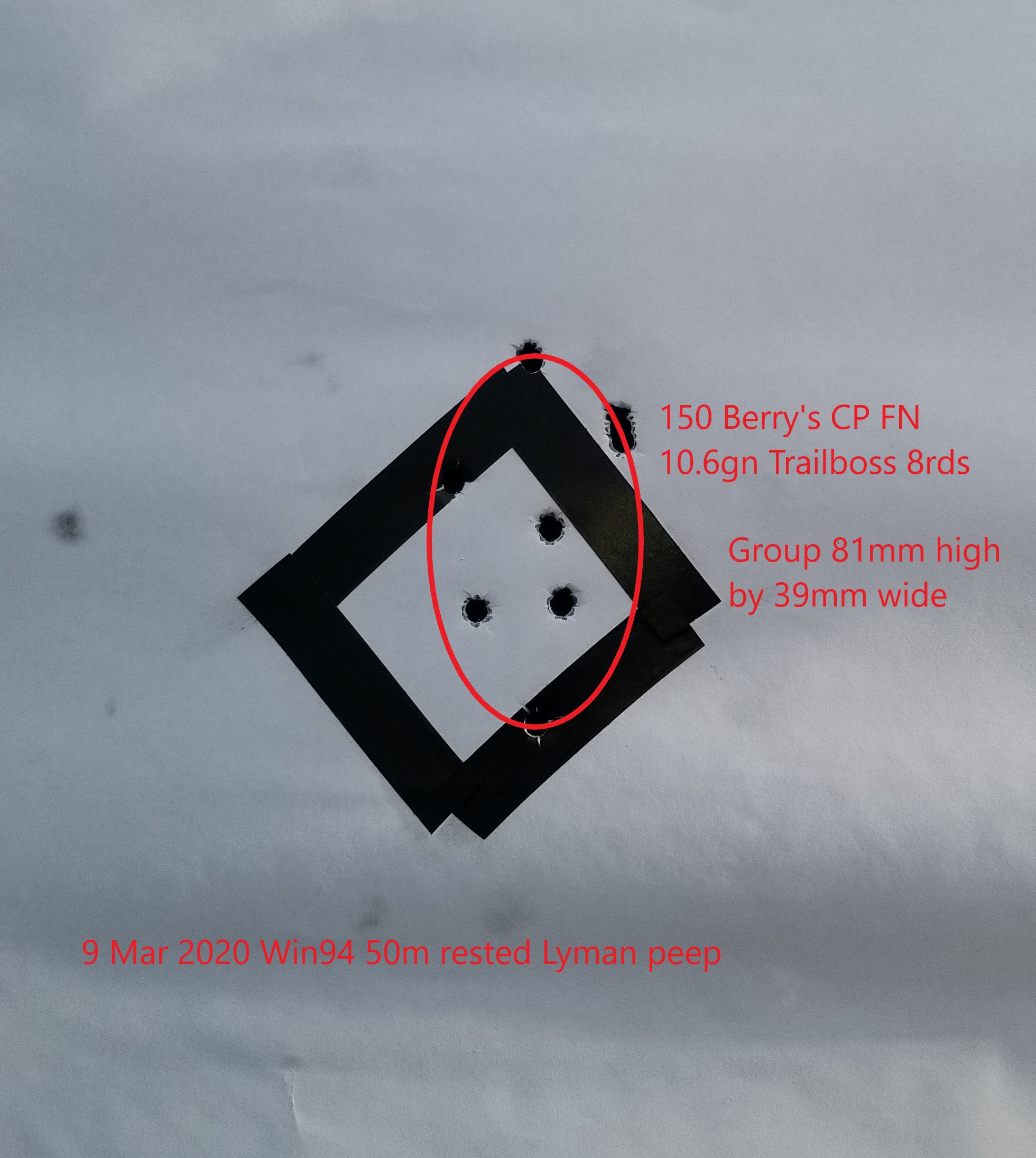

Five rounds of the 150gn gave me a group of 84mm tall but only 45mm wide, but I was still struggling to clearly see the target (why I really prefer to mount a scope for load development).
So I made a fresh 85mm aim point in black with a white centre, and put eight rounds into a group 82mm tall by 39mm wide.
I think sub-50mm 50m groups with both of these loads is certainly doable with iron sights, and some practice - definitely capable of taking a fox cleanly at 50m. With a scope I'd be surprised if 30mm groups were at all difficult. I noticed the front siight is badly rounded on the top right corner, causing reflection even after painting it black. I'll have to file it back to square for a consistent sight picture. And the peep is too big for precision shooting, more of a ghost ring for medium game. I should've grabbed the smaller aperture out of one of my Williams' sights. I also noticed that the front sight is mounted out of plumb with the action, sitting almost at one-o'clock. I thought the barrel might've come loose, but a straightedge on the rear sight dovetail sits level.
