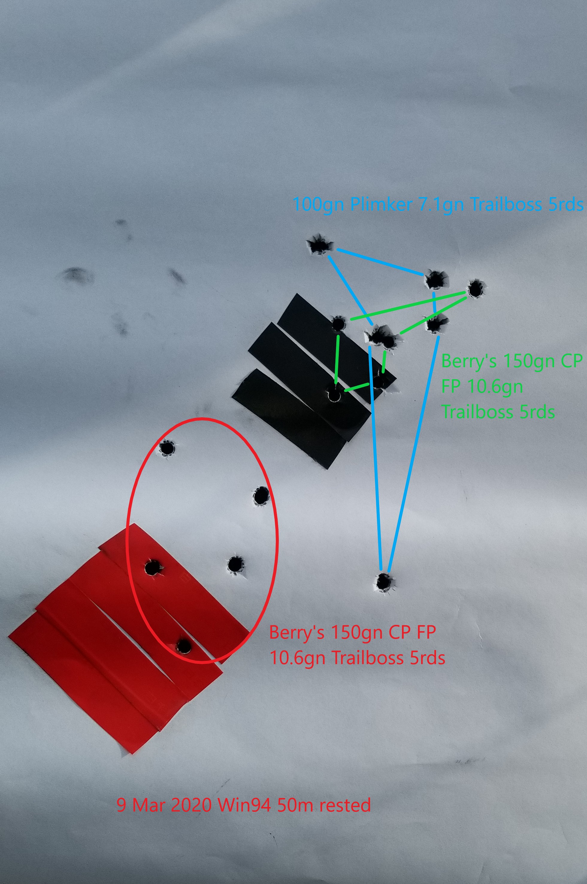

I fired five of the 100gn Plinker first, four of them dropping into 58mm, the fifth was way off, probably because I was struggling to see the diamond through the grass.
- 20200309_174730b.jpg (1.05 MiB) Viewed 4161 times
Then I fired five of the 150gn 10.6gn loads into 76mm, with four of them in 31mm.
I thought I could do better if I could see the 50mm black aiming point, so I made a red diamond of 70mm.
At this point I switched to the loads in brand new unsized brass, and a few of these definitely left a crack rolling down the valley. In my rifle the 10.6gn load may be right on the edge of subsonic, 10.5gn might be a safer bet to avoid the occasional cracks. These are burning more than ten times the volume of powder in a .22LR round, and are significantly more of a dull boom, but not at all unpleasant on the ear.

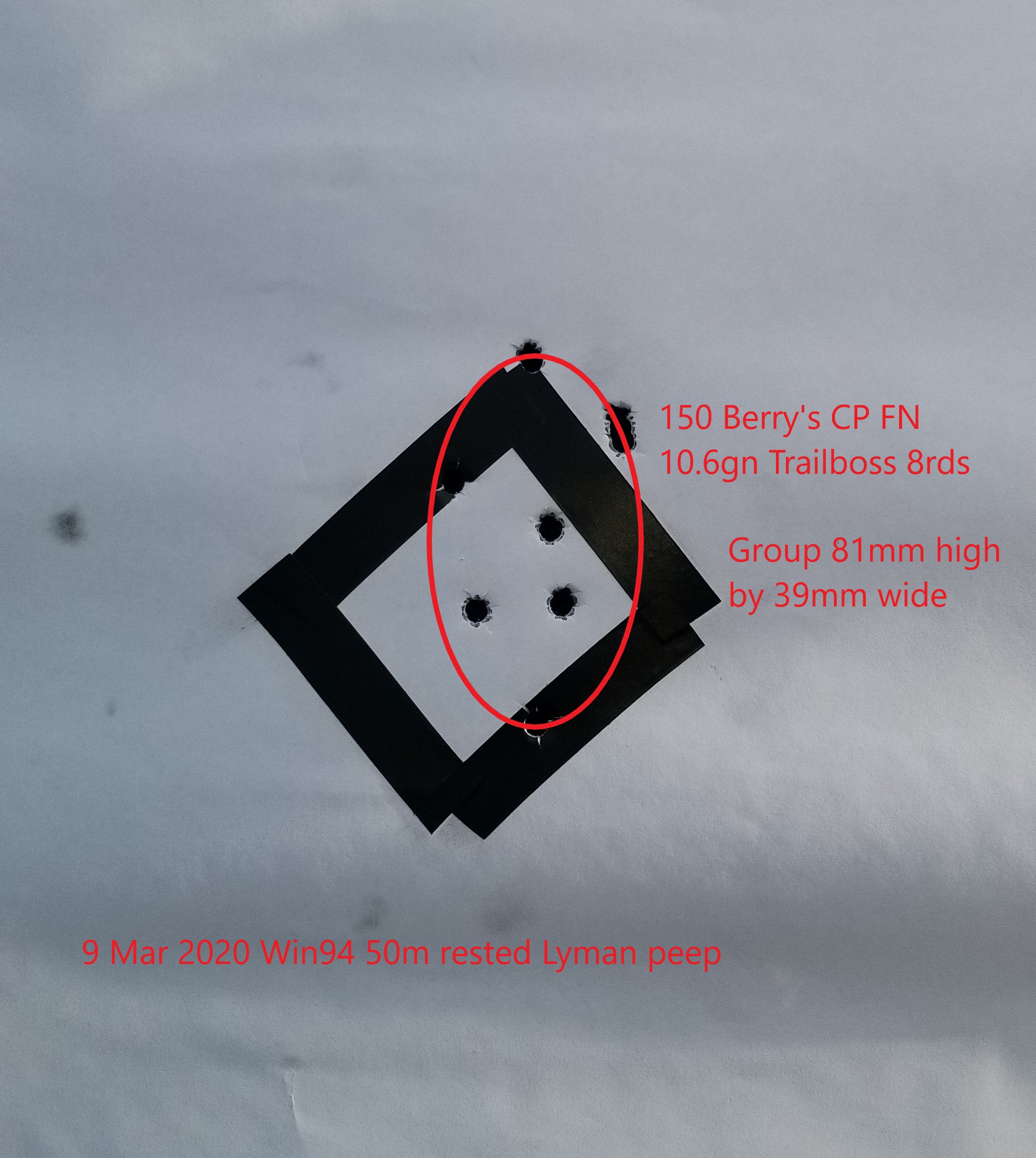

Five rounds of the 150gn gave me a group of 84mm tall but only 45mm wide, but I was still struggling to clearly see the target (why I really prefer to mount a scope for load development).
So I made a fresh 85mm aim point in black with a white centre, and put eight rounds into a group 82mm tall by 39mm wide.
- 20200309_175519b.jpg (823.92 KiB) Viewed 4161 times
I think sub-50mm 50m groups with both of these loads is certainly doable with iron sights, and some practice - definitely capable of taking a fox cleanly at 50m. With a scope I'd be surprised if 30mm groups were at all difficult. I noticed the front siight is badly rounded on the top right corner, causing reflection even after painting it black. I'll have to file it back to square for a consistent sight picture. And the peep is too big for precision shooting, more of a ghost ring for medium game. I should've grabbed the smaller aperture out of one of my Williams' sights. I also noticed that the front sight is mounted out of plumb with the action, sitting almost at one-o'clock. I thought the barrel might've come loose, but a straightedge on the rear sight dovetail sits level.
