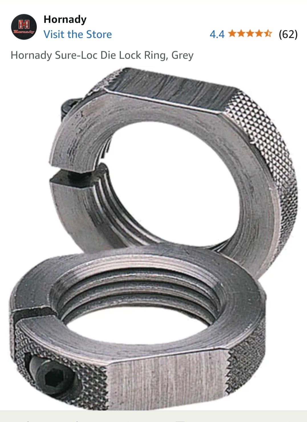

It's confusing. Lee seem to call both the portable and the little C press by same name. "Breech Lock"
I think Shayn is asking about the breech lock "quick change" fittings. (Will would need a new press.)
I did have issues with the Lee dies because the lock nut is crappy. I bought a couple of these:
A few brands about.

Oldbloke wrote:It's confusing. Lee seem to call bothe the portable and the little C press by same name. "Breech Lock"
I think wm is asking about the breech lock "quick change" fittings.
A few brands about.
Breechlock refers to the interrupted thread design as opposed to the old design that you have to screw the dies all the way into.
Those are good but I bought a pile of the Lee locking bushings out of the US years ago, need more of the bushings now though. Mine are the old style, not the new "spline drive" ones.

Post by bladeracer » 27 Dec 2024, 7:39 pm
GQshayne wrote:To Blade and OB,
I my experience with my equipment I have now, any die I put in the O frame press is not fully secure unless I re-tighten the lock ring. If I leave the lock ring in position to set the die seating depth in the press, I have seen them move and come loose. If I re-tighten the lock ring, then in a small way I have changed the adjustment. This is why I am looking at the Breech Lock and Lock N Load systems. The die is fitted into the holder, the lock ring set, and from then on is not touched again.
Oh, yours is the old-style screw-in, not the interrupted thread system? Have you tried using two lockrings against each other?

I do not even know what that is!!! My dies screw into the press (1980's Lyman), lock ring tightened, and then the grub screw done up tp prevent movement. In some way, not re-doing the grub screw each time means it is not secure. That means the die can move.
I have not tried two lock rings, but not sure how that would help the issue, as whichever one is against the press, would need to be tightened each time.
Yes using the allun key and lock ring.
I tried using two "lock nuts" but didn't work well as flats never seem to align.
What I'm using seems ok so far. Better at least.

The Breechlock system is an interrupted-thread bushing so it takes a third of a turn to remove the die from the press. Similar to the other interrupted thread systems used by other press manufacturers. The Breechlock system is in the O-Frame, C-Frame and the Handpress. I bought my first Breechlock press kit at the end of 2014 so they've been available for at least that long.
When I run short of locking bushings I just use two lockrings with the standard bushings. Two lockrings locked together do not move, the die position won't change. The locking bushings do away with the lockrings so I have a box full of them.

Oldbloke wrote:Yes using the allun key and lock ring.
I have e written down the distance to shoulder and check a couple now.
Another thing I discovered is if you change the sizing lube the amount of bump changes a tad,,, believe it or not.
The flats don't need to align, just lock them together. You're only screwing the die hand-tight into the press, you shouldn't need a spanner to remove it.

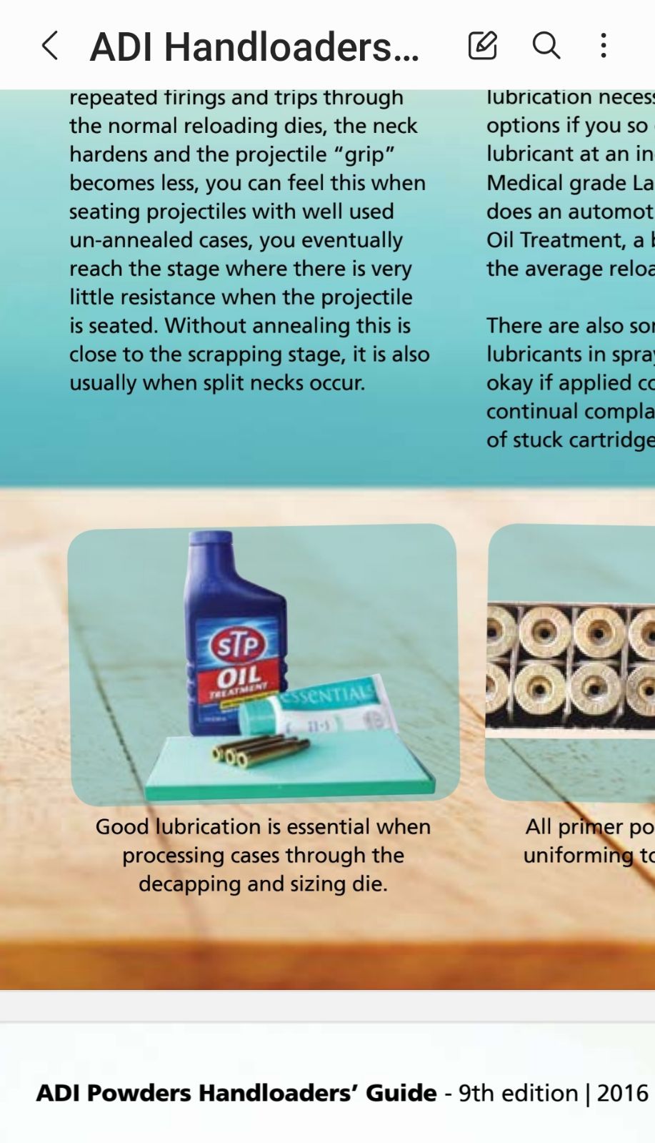

Post by Oldbloke » 27 Dec 2024, 10:43 pm
I found if I only hand tighten the dies they seem to work loose after a while. So,, I like to "nip" them up with a spanner.
Because I never really had a mentor it was learn by your mistakes. :unknown:
Yrs ago got told just use 90 diff oil. (FLS)
Well it works. All was well for 30yrs. About a year ago I was convinced to try coconut oil. It's great for your skin. Well it works too. No issues for some time. But I discovered few weeks ago it only works if its cool weather and solid. If you use it on a hot day it's a very thin oil and it's sh1t. Two stuck 223 cases later I realised what was going on.
Tried std engine oil, not much better.
Tried 90 diff oil, better, worked. :D
Soo, then tried some lanolin based grease I had. (Been thinking grease might work for some time)
Well, lanolin grease was great. 223 & 30.06 cases slipped in like a groom on his wedding night. (FLS) :thumbsup:
Later I did some measuring, seemed the bump increased a tad so had to adjust the die out.
So,, press must have been stretching a tiny tad using coconut oil. :violin:
It's a Simplex master "O" press, cast steel I think.
As an aside ADI suggest in one of their old manuals to use the old STP oil.
Re: Reloading press
Post by Oldbloke » 27 Dec 2024, 11:03 pm
Here it is. STP oil and a tube of hand cream.

Redding Imperial Sizing Wax, using very sparingly like the old cans state, it will last many years and if you just use One-shot or graphite for inside the necks, everything will go smooth and slick.
Also never get stuck cases.
Hrdy Oneshot is clean and convenient but you will end up with a stuck case sooner or later.
The press also feels like it's struggling and something could break.
I raced down to the chemist and bought a $10 tube of lanalon based cream and the press felt slick and smooth.
Sizing wax felt even smoother.

Fester wrote:Although you can set your dies up and just lock up the screw on the locking ring, then just screw the die down to the ring, the Hrdy quick change sleeves are just too easy, change die with 2 fingers in about 2 seconds.
I was going to keep my Hrdy press when I scored a Rockchucker but why, 2 presses a a big bench space loss and every die I use is adjusted and in a quick change sleeve.
So are you saying that RCBS have a similar system??? I could not find it.
Because most dies and presses have that same thread 7/8 or whatever, you just screw the Hrdy Q/C press fitting into the RCBS press, screw your diff brand dies into the Hrndy sleeves and put them into the press by hand.
Simplex use a hole different system so dies are not like Lee, Hrdy, Lyman, and RCBS etc.
As mentioned in a number of other threads in the past few months, SUPER Simplex, is different to the other presses commonly available.
Simplex Master presses use the same thread as the other commonly available presses(7/8"x14??).
Some people make adapters for using Super Simplex dies in a 7/8x14 thread press, but unless you are loading something out of the ordinary, it's usually simpler to buy the 7/8 dies.

Fester wrote:One of the best tricks I found was forget lube concoctions and just get the best.
I use the imperial Die Sizing wax; find it hard to beat.
And as mentioned; a tin lasts a freaking lifetime.
