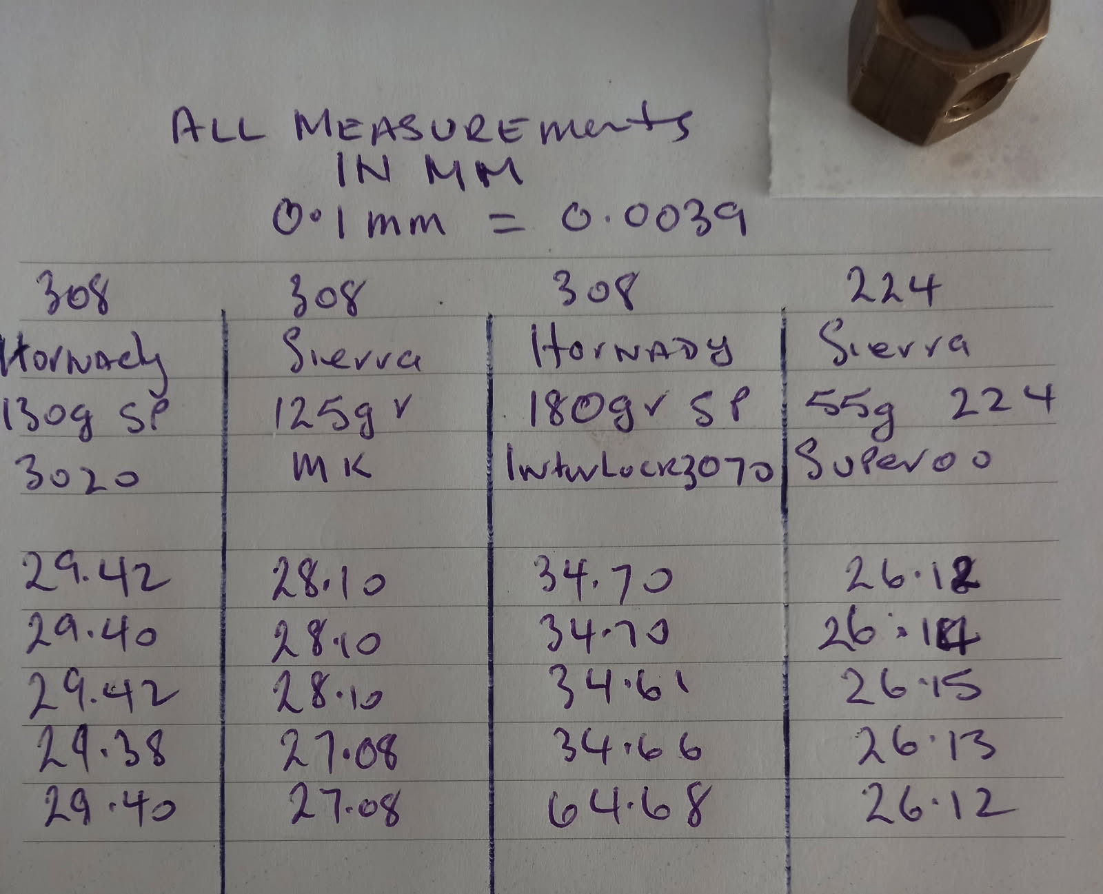

Oops, forgot to mention.
If your measuring OAL front the tip of the bullet keep in mind some vary in length a lot.
I measured a few samples of 3 diff bullets a while back. 3 were very consistant and within about 0.003". But one bullets had a vaiation of abt 0.010" IIRC.
To improve on that I made a bullet comparator. A copy of a bought one.
There are a few ways to do it tho.
viewtopic.php?f=3&t=13453

Oldbloke wrote:Oops, forgot to mention.
So True, NEVER (if you want consistency, which is how you get accuracy i.e. smallest groups without effort) measure OAL from the bullet tip.
Old mate is spot on, bullets vary in length from the tip to the base.
They even vary in length slightly from the point your bullet comparator gauge sits on the ogive when you measure them properly using that tool.
But that doesn't matter a toss, as because your bullet clearance from the lands will be exactly the same each cartridge despite this.

Post by Oldbloke » 10 Mar 2025, 6:04 pm
I just measured 4 different bullets. 5 of each.
Worst was about 0.004"
Just using my DIY comparator.
Experience tells me it's repeatable within abt 0.002"
I use same for both measurements
