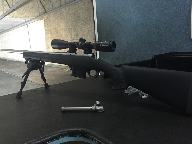

This is the little Howa 223 I picked up this morning, short action 20" varmint S/S barrel on Hogue synthetic stock. Should be a perfect first centre fire for the young fella, after I sight it in, do some load development and shoot some rabbits with :) The trigger is fantastic, reasonably light and breaks very crisp with no hint of creep. Paid $880 which included, bases, rings and a Nikko Panamax 3-9x40 scope so a fairly reasonable price. Grabbed 200 rounds of ammo whose brand escapes me, packs of 20 rounds in a clear plastic shrink wrap type bag with no name. Was cheap enough and according to Justin at HPGS shoots well in this rifle. Might follow Gwion's lead and see if I can develop a light load for the boy, I have a baggie of 22 Hornet projectiles my cousin gave me so might give them a shot.

Dopey me, I did get the mini action but just typed the description I found with the pic...
This is the one I got but imagine it in stainless, I'm quite impressed so far. Will see how it shoots during the week.

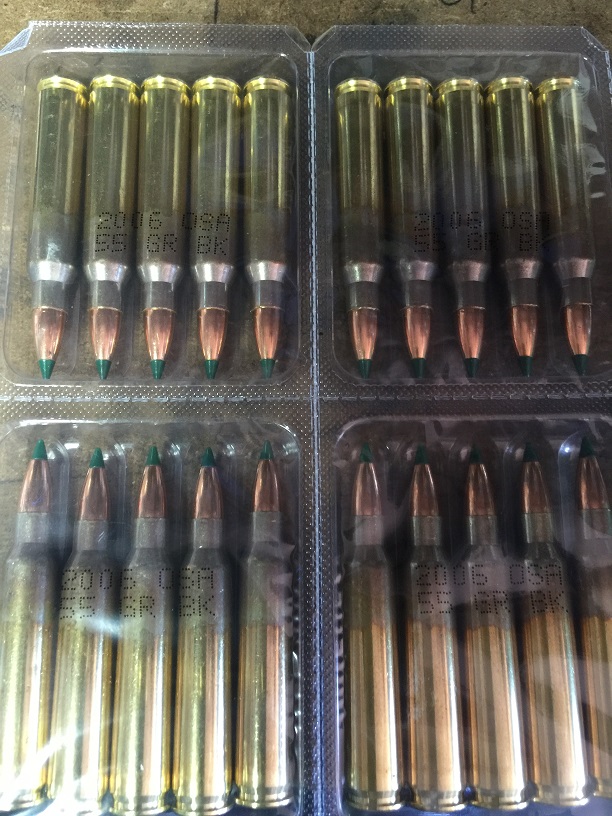

Checked the ammo I bought and it's 2006 OSA 55Gr BlitzKing using ADI brass and powder. I usually shoot Tuesday nights but I have a meeting with my solicitor and a QC that can't be missed. I'll try and hit the range tomorrow night and see how they perform and I'll get some chronograph data as a base to compare Gwion's numbers against.

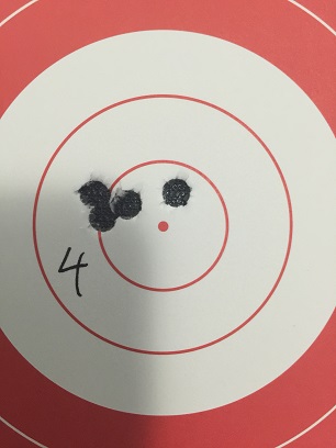

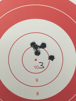

Post by brett1868 » 21 Dec 2015, 6:54 pm

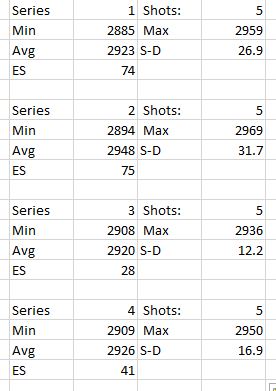

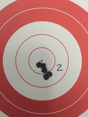

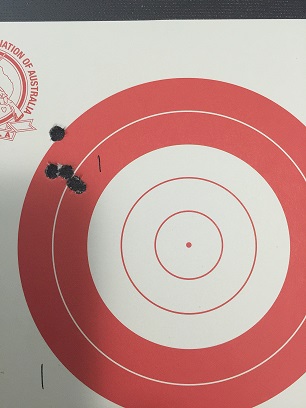

Made it to the range this afternoon and put 30 rounds through the Howa 223 Mini Action. Below is the chronograph series summary followed by he groups. First 2 groups were @ 25M so I could zero the scope, 3 & 4 were @ 50M. I removed the bayonet sensor and shot 2 more groups of 5 with the best being the 5th group. I've got the chronograph packed up and Gwion should hopefully have it by Thursday. Will be interesting to see how the lighter loads compare for velocity & accuracy.
Series 1
Series 2
Series 3
Series 4

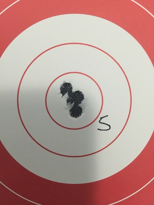

Best group
Howa 1500 Mini Action .223

Post by Gwion » 21 Dec 2015, 8:18 pm
Looking good, Brett. Interesting that the velocities are under 3000fps. Also notice the ES is all over the place as well. Never heard of that ammo, wonder how it compares to the current OSA stuff.

Post by brett1868 » 22 Dec 2015, 7:08 am
The 20" barrel will drop the velocity a bit compared to a 24" but as this rifle won't be used past 200m it doesn't matter. I'm very impressed with group 5 considering it's factory ammo from a 20" $850 rifle package, proof positive you don't have to spend a fortune to achieve accuracy. I'm sure with a little load development this thing will shoot just as good as my Sako's / Weatherby's and was 1/3 their cost. I think Howa have found a new fan :)
The S-D is the critical number I look at and this ammo isn't bad but it's not perfect, I try to get a S-D of 10 or less. For general hunting / plinking this ammo is perfectly fine and reasonably good value and great value if buying in bulk with the added bonus of being made in Australia.
