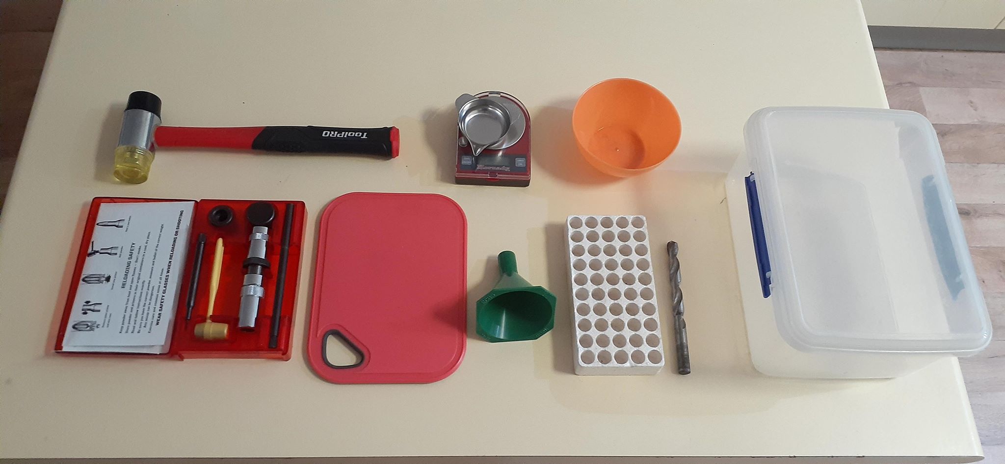

Post by CAVEMAN » 18 May 2020, 1:37 pm
Afternoon all
I have recently had a bit of a play with a Lee Loader, its old school and slow but it still makes a round. I've fluffed it out with a few pieces that make it a bit more user friendly.
The price break down follows
*308 Lee Loader $60
*Hornady Digital scales $70
*Powder funnel $15
*Soft faced hammer $13 (first batch i used a 2x4 that the manual says is an option)
And a few household items i stole from the kitchen or shed
*A cheap small cutting board to hammer on
*A small bowl to pour powder into
*A large clip lock container i use for storage and also cleaning brass (using hot water, dish soap and salt)
*A 10mm drill bit for chamfering the case mouth (not anything special just an old one from the tool box)
*A 50 round foam tray from some cheap rounds (used as a loading tray)
*And a few old 20 round ammo inserts for drying the rounds after cleaning
So for $158 plus some household recycling i have a basic yet usable reloading kit. I have reloaded a round or two with just the kit which is doable but the add on's just makes it a tad tidier. The lee loader doesn't seem to need case lube, has worked dry fine so far. And the cases i am using are being fired by and reloaded for the same rifle.
It is a bit of effort but once in a pattern it works pretty well, the worst part for me is measuring out the powder with just the scales and a dipper. I'm no bench rest shooter, but i'm happy with the product and its a bit of fun and a new skill. And so far my face is still fully intact.

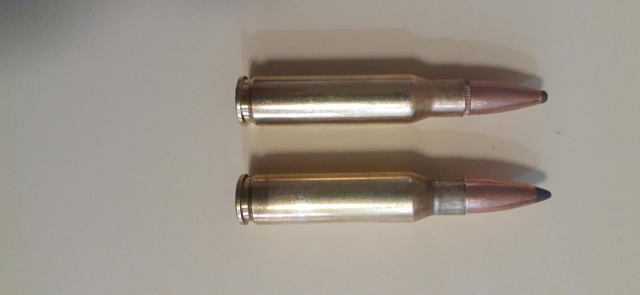

With the picture of the rounds, top is a factory Remington 308 150gn Core-Lokt. And bottom is a reload with a 150gn Sierra.

Post by Oldbloke » 18 May 2020, 1:52 pm
Many started like you. I did.
FYI, your loader only neck sizes & should lube the necks. Diff oil works. Lol
Here is a reloading DIY thread I started.
viewtopic.php?f=3&t=13453
Initially I just used a sharp knife to debure the necks and fine file for the outer edge. Sound rough but works.

Post by RoginaJack » 18 May 2020, 2:57 pm
nothing wrong with that, after-all you'r hunting so not firing 100 rounds. A bit of light grease on the necks too.
I hunted around a found a pistol case that held just under the listed powder load, a bit of copper wire around the rim and away i went, just topped up on the scales...
Simple, eh?

Post by CAVEMAN » 18 May 2020, 3:47 pm
Oldbloke wrote:But there is always used kits about
Thing is he can try at every low cost. If you like it buy a lot or add to his gear later.
Cheap kits here.
https://www.ozgunmart.com.au/
Ill probably never go any further than this, more of an interest than a need. But i will steal your dipper idea to speed things up. As long as its around the mark i'm happy.

Post by CAVEMAN » 18 May 2020, 3:49 pm
RoginaJack wrote:nothing wrong with that, after-all you'r hunting so not firing 100 rounds. A bit of light grease on the necks too.
Simple, eh?
I might try something i've got lying around, let my inner bogan come out for a bit of lube.
