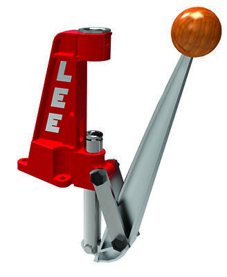

Post by Oldbloke » 19 May 2020, 11:46 am
These are incredibly cheap. Were common donky years ago. But I think only good for FLSizing like up to say 223 or pistol.
Press Lee breech lock.jpg (24.74 KiB) Viewed 8722 times
