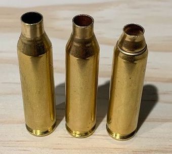

I was resizing some brand new Starline Brass from 308 to 243 and some shoulder/necks collapsed in as per the picture.
Reading online some people say a light load of trail boss can fireform them back to normal with a light projectile or wad.
Anyone ever done this or know if there could be any safety issues?
I was wondering why they collapsed so easily too, I removed the decapper/Expander, about 1 in 5 collapsed with case lube and going nice and slow. Any tips anyone has to avoid this would be appreciated.

l have found this happening when using a die with an expander that moves
eg.. forster FLD where the expander will push the neck down collapsing it instead of sliding through the neck if the expander starts in the up position
if l lower the expander it does not happen :unknown:
maybe doing it in steps would be better, bring it down to 26 cal then 24 :unknown:
l have a feeling it would be just simpler to buy some good 243 cases :drinks:

Ive caved one case in like that...but with a collet die...id seen pics & so i just wanted one :lol:
I didnt try blow it out with a load in the gun...i put it on the 'reloading fuk-up' trophy shelf... :)
Personally i wouldnt try blow it out with a load of powder & a bullet...
I dont know what would happen, but the fact Headspace isnt within the realms of being anywhere near that considered safe is enough to scare me away...
I have no way of knowing what might happen to that brass & bullet as it all jams up in the narrow neck of the chamber--i cant help but think there would be even a little bit of a pressure spike...but ive never done it so wouldnt know.
For me, if anyone tells you its ok, let them fire it with their face next to the action & directly behind the bolt... :thumbsup:
Also maybe beware of the thickness of the 308 brass in a 243 neck...if the brass is thick enough to even slightly impede the bullet release in the narrower necked 243 chamber, you could have some pressure issues.
You might be able to check this by measuring a loaded round with both new & already safely used brass, then comparing any difference with a fired case of the proven brass.
If you dont have atleast 2 thou difference (space in the chamber for thicker brass neck to expand), you'll have to turn the necks or deal with inconsistant velocities from random pressure spikes...
So aside from repeating marksmans suggestion of buying the right brass, :thumbsup: hats about the best i got...

I regularly resize Winchester once fired brass to 243 and I have done many hundreds of cases for myself and for friends.
With good lube it can be done in one pass.
If your lube isn't quite up to the task then try sizing the case in incremental stages. First say 1mm of the neck and then relube just the neck. Then a little more and relube the neck. You will soon get the feel for how it has to be done in order not to collapse the shoulder.
Also if you start with a dry die then things will improve as lube spreads through the die but you will also get shoulder dents if there is too much lube.
If that batch of cases just happen to have thicker necks or a little more anneal on the shoulder then they will collapse.
Cases with collapsed shoulders can't be rehabilitated.

Your cases are stuffed and you can never reform the collapsed shoulder. Throw them away.
For your other cases I would try some better lube, I use Imperial Sizing wax. I push the case in a little and then withdraw it, turn the case and push it up again and keep doing that until the neck starts to size down. It helps to have a large chamfer on the case mouth to prevent it catching on the die.
Remember that the case neck is now thicker and longer, I would neck turn and trim.
Start experimenting with some range scrap, you can pick up discarded 308 brass at the range any day of the week.
