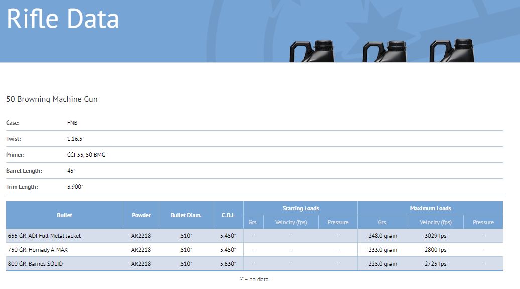

Hi all, wanting to load for the Barrett 99 50 BMG with adi 2218 but can’t find info on start loads! Is there any gurus out there that can help please????

Nevy78 wrote:Hi all, wanting to load for the Barrett 99 50 BMG with adi 2218 but can’t find info on start loads! Is there any gurus out there that can help please????
50 BMG Adi.JPG (59.1 KiB) Viewed 3605 times

Post by bladeracer » 25 Jun 2020, 6:00 pm
I thought I had seen on the website what to do when there is no listed starting load, but I can't find anything. Maybe it's in the Handloading magazine but I haven't seen one of those for years.
I Googled it.
Vihtavuori suggest starting 15% below the max loads listed.
https://www.vihtavuori.com/reloading-data/
Alliant suggest 10%.
http://www.alliantpowder.com/reloaders/

Thanks for the heads up gents, always happy to help out another lover of the half inch browning.
First up - Don't follow the ADI data, the COAL is wrong and you'll risk damaging the rifle or yourself. I reached out to them to correct the problem but apparently I'm not qualified to critique their data.
The M99 Barrett is a very nice rifle and I'm guessing was purchased from Magnum Sports.
If you can tell me what projectiles and primers you are using then I'm happy to get you started.
