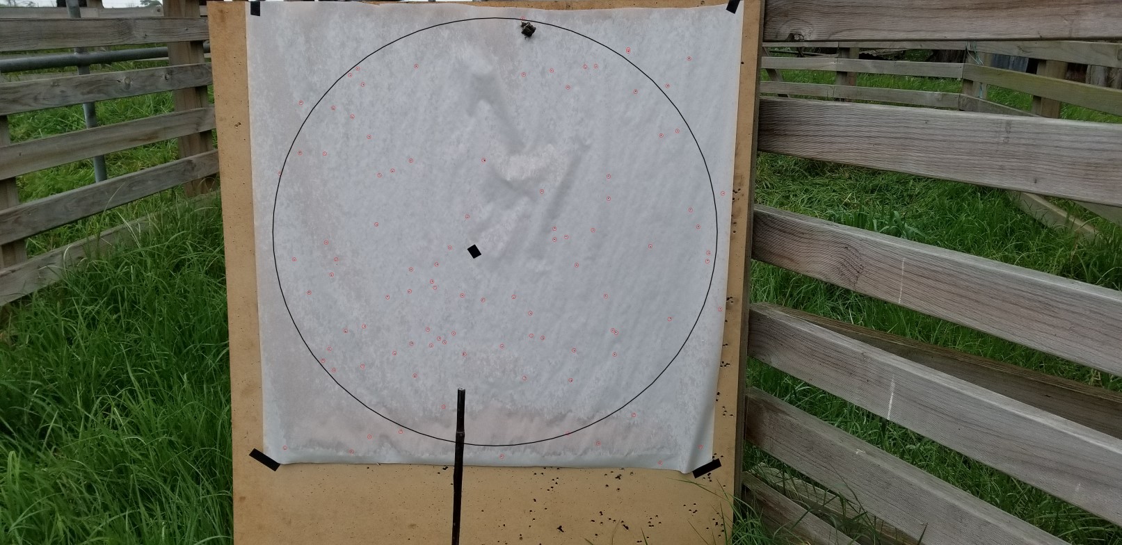

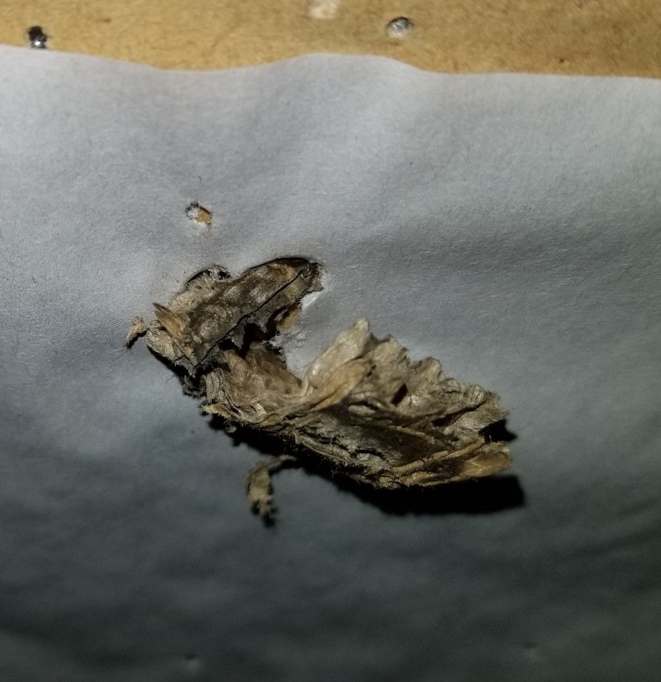

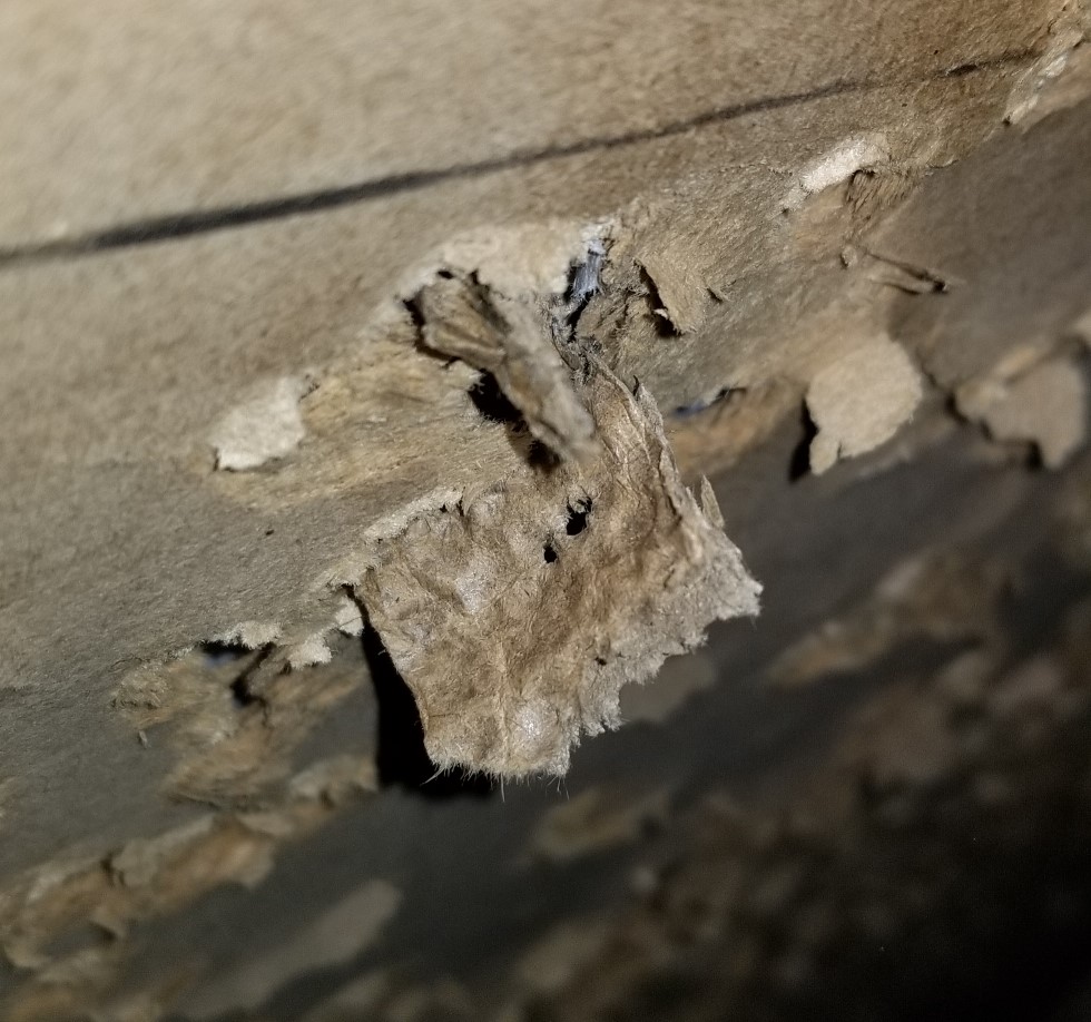

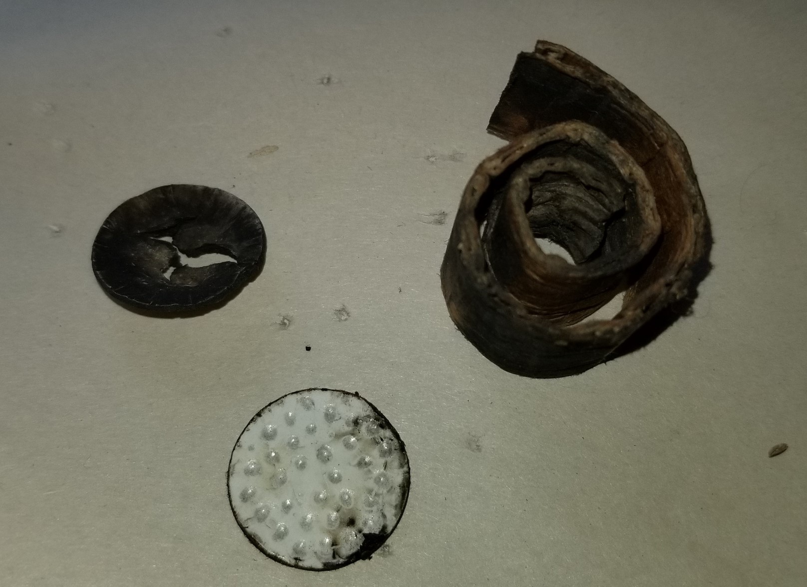

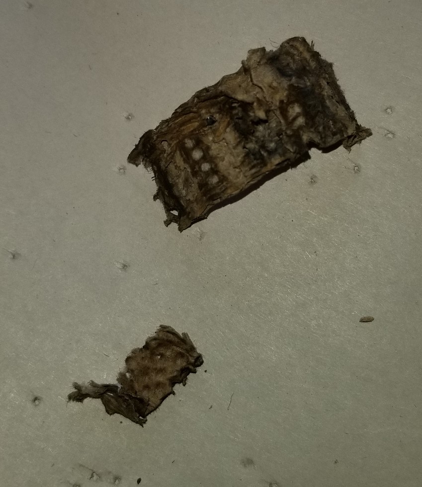

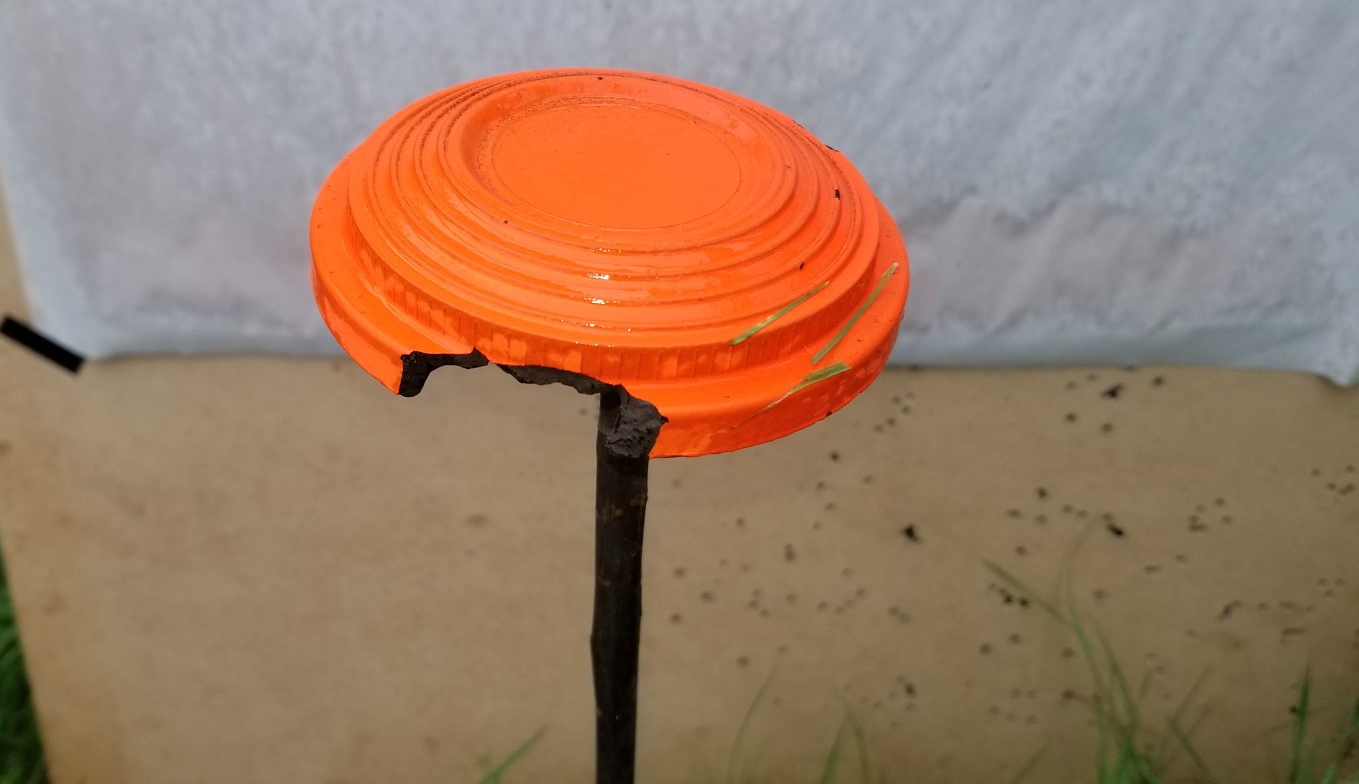

Managed a couple of experimental shots yesterday, in the rain.
I charged a hull with 21gn of AP70N, and seated an over-powder card on that. Then I tightly rolled a 140mm-long strip of 2.2mm corrugated cardboard into a 20mm-tall cylinder for a wad, and seated that on the charge, with another card on top of that. Then I rolled a 55mm-long piece into a 20mm-tall tube, cut five slits three-quarters down it, and seated that, then poured 330gn of #7-1/2 into interior, put an over-shot card on top, and crimped it.
It made a "fffftttt", registered 72fps on the chrono, and I saw the pellets scattering the grass perhaps 10m ahead of me. The wad was still in the bore, having only traveled about 100mm :-) I pushed it out and it was obvious that the charge had blown through the centre of the over-powder card, then through the hollow-core "wad". It had just enough punch to get the pellets (and the tube they were in) to the muzzle. The hull still had at least half the powder charge sitting in it, unburned. Clearly not making enough pressure.
So next I punched out a pile of corrugated cardboard discs and used a compressed stack of those to make the 20mm-tall wad. Everything else was the same, except that I didn't bother cutting the slits in the tube as I didn't expect it to work any better than the previous attempt. This one made 647fps, took a piece out of the clay at 30m, scattered a few pellets across the paper, and punched the cardboard strip I'd used for the tube, through the 3mm MDF target backing. Not bad. An awful lot of burned powder left in the barrel, but it looks like it has potential at least. There should've been about 275 pellets in the load, and I count about 80 within the circle, and another 18 on the paper, with some very large gaps in the pattern. The pellets penetrated the MDF but are just below flush with the surface. This with the .685" extended turkey-choke still.
Worth playing with some shot-cup designs with this I think. And making cork wads instead of cardboard.

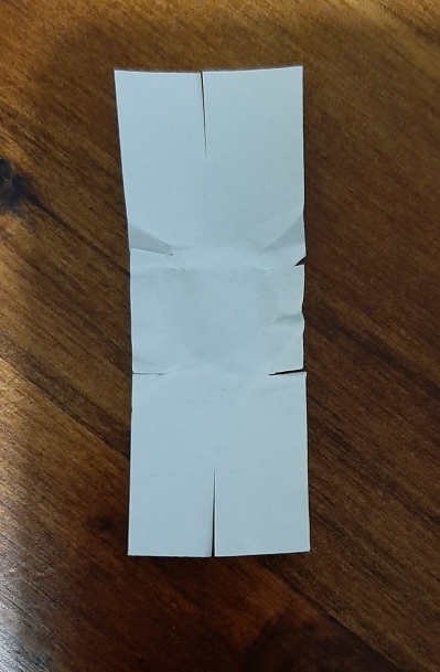

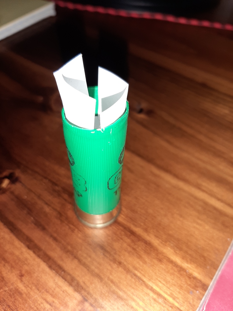

Edit: pic below. This is just paper but basic design seems to work. Just needs some refinement to get a reasonable cardboard cup.
Paper wad 2.jpg (153.07 KiB) Viewed 10459 times
Paper wad 1.jpeg (205.45 KiB) Viewed 10459 times
Wad pressure is important. If its low the powder will not burn well. Solution is to add wads under the shot wad. In your case trial and error till u get a good crimp.
Edit. Your trying to duplicate a factory crimp. If it is not firm you need more wads under the shot.

Gadge wrote:G'day all,
What Eley in the UK do, is to 'turn back the clock', and revert to an old-time [as used from the blackpowder days, until the 1960s] multi-component punched wad column, for their 'bio friendly' loads.
This basically consists of a hard cardboard overpowder wad, sized to grip the case walls, then a felt/fibre/cork cushion wad, then the shot charge.
Then, if a roll crimp is used, a thin overshot wad - this is necessary for 12ga 2.5" Black Powder loadings, as required for older Brit made guns.
Commercial 'Circle Fly' wads are available from Forbes Wholesale in Vic, but just buy an 18mm wad punch, and you're set to make your own!
Wad Materials:
Overpowder: 2.5mm+/= hard cardboard
Cushion: wool felt, carpet underlay felt, or cork floor tiles, also that heavy waxed corrugated cardboard used for fruit/veg boxes. I 'edge lube' mine using 1+1 Lard/Beeswax hard setting lube, and the tool shown below. It's just two 2c pieces soft soldered to the tips of a large pair of lab forceps.
Overshot: If roll crimping, wine [or port!] cask box cardboard. If you get star crimps that are 'leaky', a square of paper on top of the shot charge will stop the leakage.
The attached ASJ article on Black Powder Shotgun explains all this concisely...
