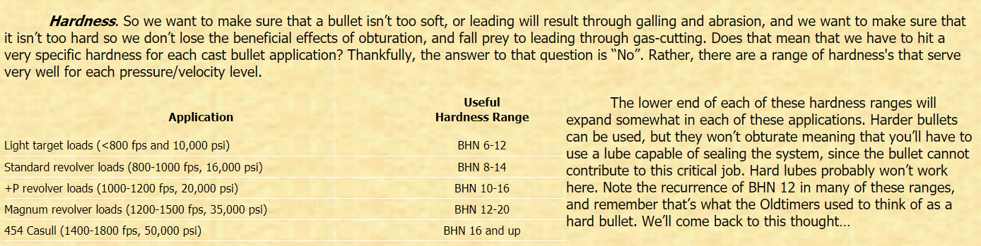

Post by flashman » 14 Dec 2024, 8:15 am
Hi a mate has just dropped off a bucket of old wheel weights ,have read there is a formula Ex amount of wheel weights to pure lead to make the hardness im looking for ,iI still need to read Lymans cast book yet,,,,,,,,,,,,,,,Im excited
flashman
Posts: 414
Re: What can i Add to my melt pot for hard cast bullets ?
Post by Oldbloke » 14 Dec 2024, 9:44 am
Cast bullet harness guide.png (573.64 KiB) Viewed 1553 times

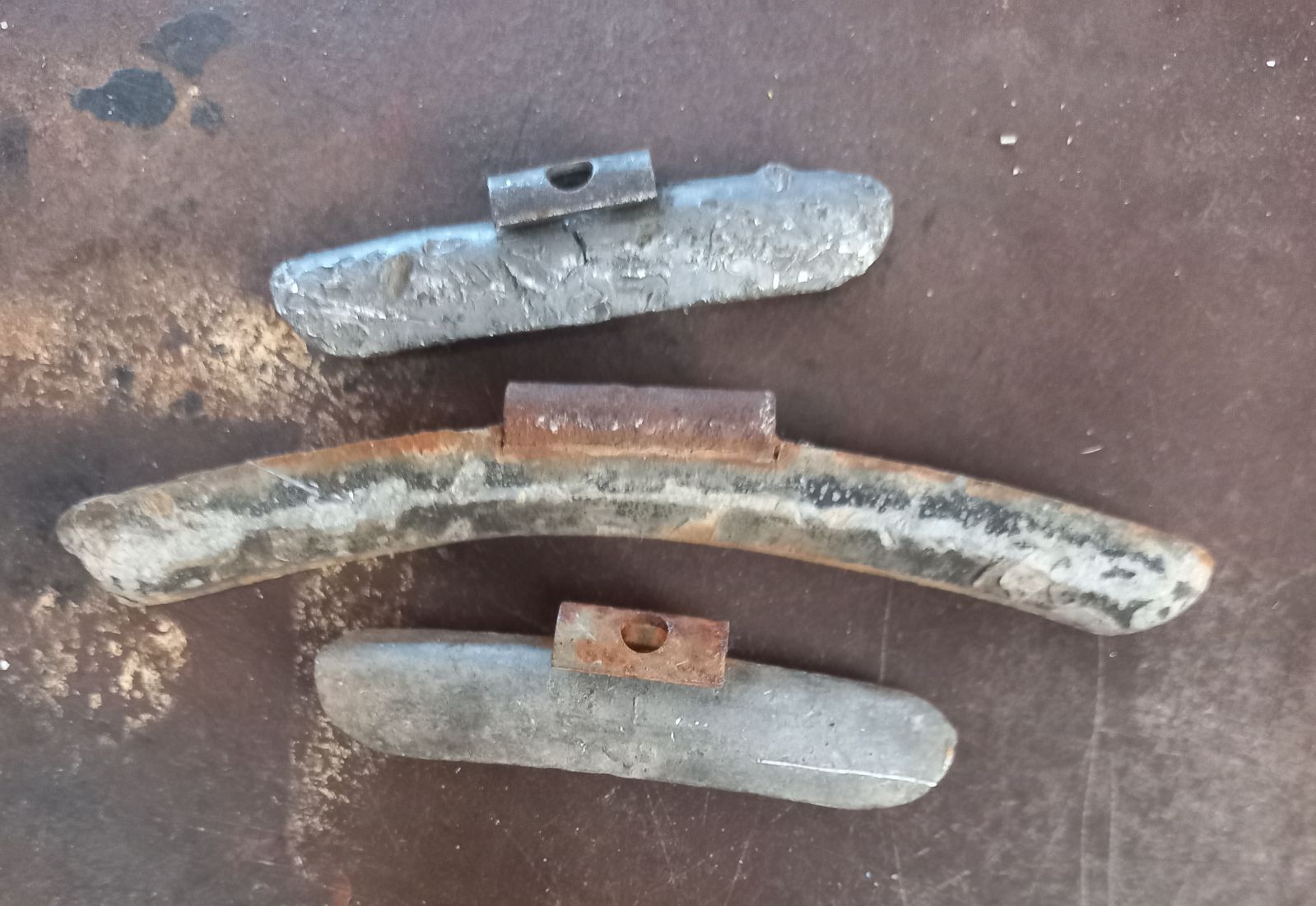

You may need to sort out any zinc weights and toss them
Posts: 13398

Thanks OB for that Zinc weights ??? though they were all lead , ok how do i tell the difference between them all look the same......or is there a weight difference. Still learning............. :)
flashman
Posts: 414
Post by bladeracer » 15 Dec 2024, 7:41 am
flashman wrote:Thanks OB for that Zinc weights ??? though they were all lead , ok how do i tell the difference between them all look the same......or is there a weight difference. Still learning............. :)
Nowadays a lot of wheel weights are zinc or steel. Try sidecutters and you should be able to determine what they're made of.

Post by Oldbloke » 15 Dec 2024, 2:53 pm
I think all this type will be ok.
Anything else will be suspect.
Posts: 13398
Post by bladeracer » 15 Dec 2024, 4:23 pm
Oldbloke wrote:I think all this type will be ok.
Those are lead but I haven't seen many around for years. They do stick-on ones as well.
Posts: 13769
Post by Oldbloke » 15 Dec 2024, 5:07 pm
I know.
Just for OPs info
Posts: 13398
Post by stihl88 » 15 Dec 2024, 5:21 pm
Scrap yard buys lead about $1.80 clean, they'll sell it back to you for $3 ~ $5 p/kg on memory.
Otherwise lead flashing (speak to roofers), batteries (if your game dump em stright on the fire, burn the crap off, pick up lead puddle next morning), diveweights and even boat keels are a good bulk source of lead if you can find it.
As mentioned wheel weights will/may be zinc now, my local tyre repair used to have 1/2 a 44gallon drum full of the real mcoy weights. I think he'd cash it in for beer money at the end of the year.
About 2% max zinc is considered acceptable for your bullet castings.
