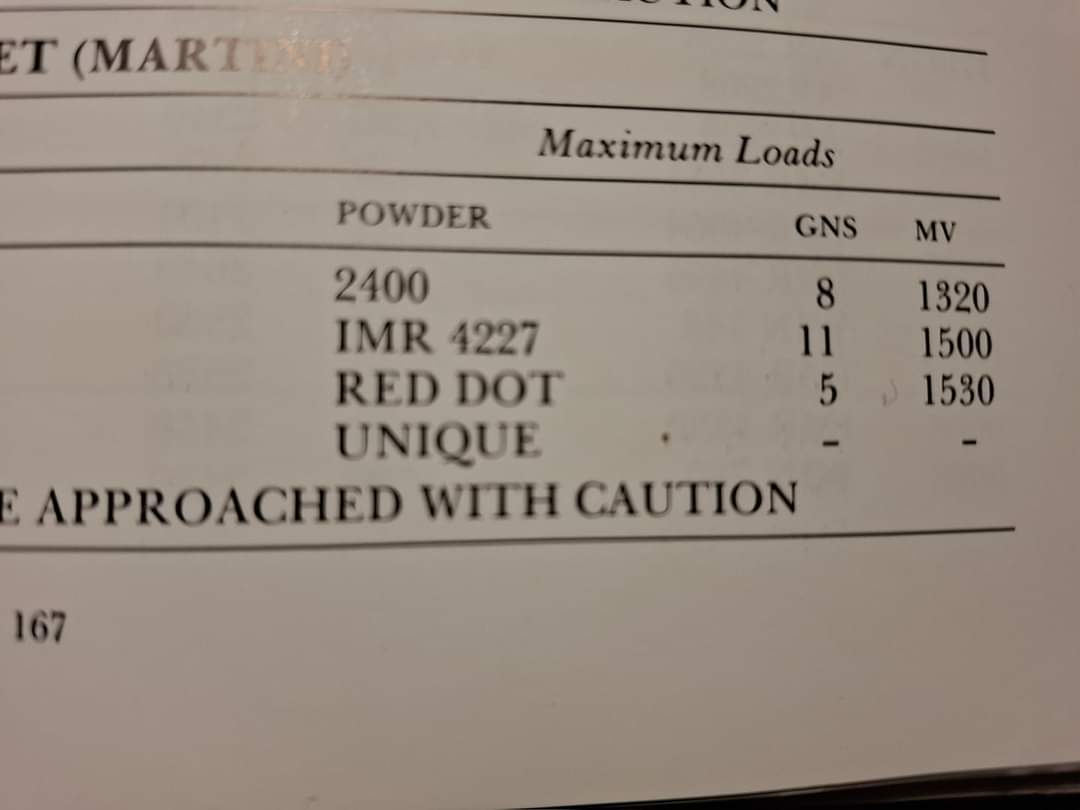

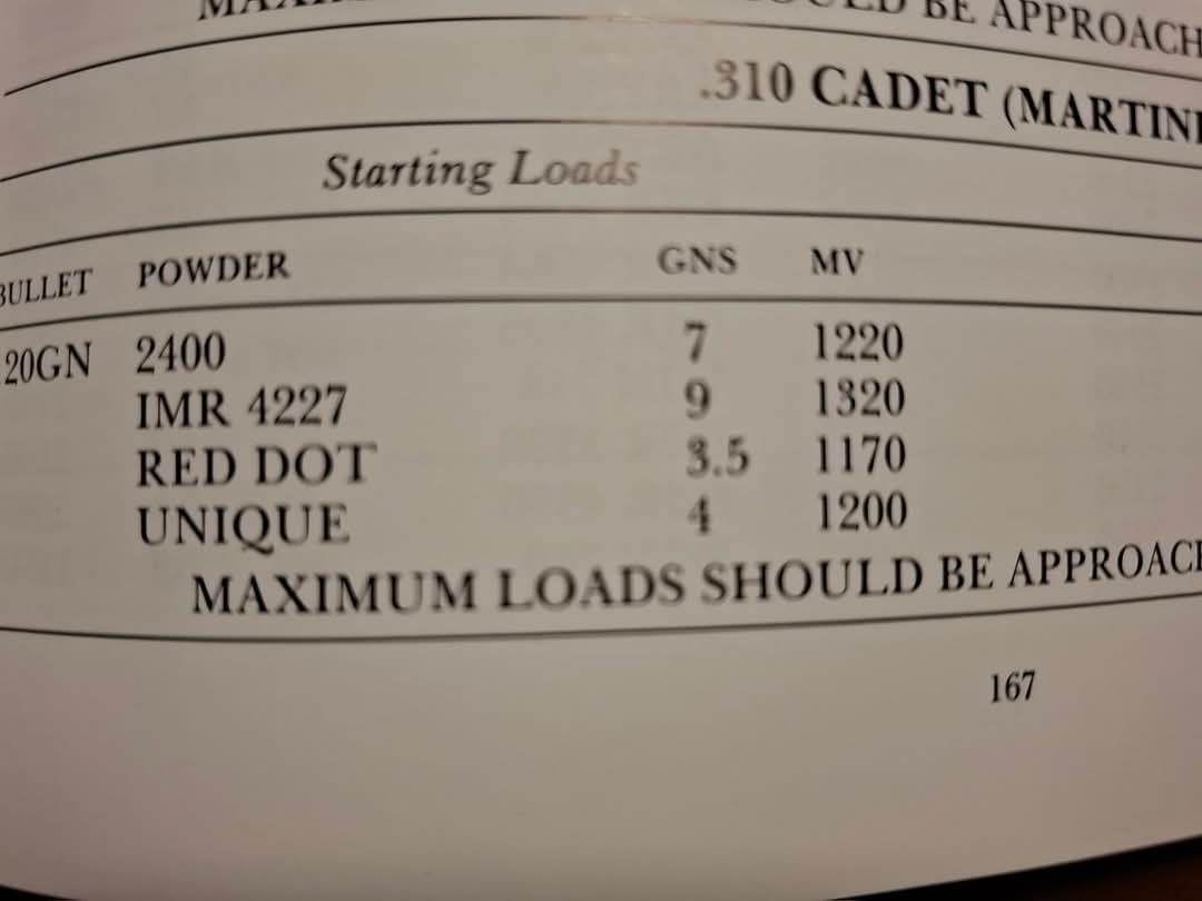

Yeah that's stupid its very much alive and well from where I sit. I have added some of Nick Harveys data from his 5th Edition reload manual 1993.
Its been a very handy reference for me.
120gn maximum loads
120gn starting loads
310 start.jpg (34.73 KiB) Viewed 5569 times

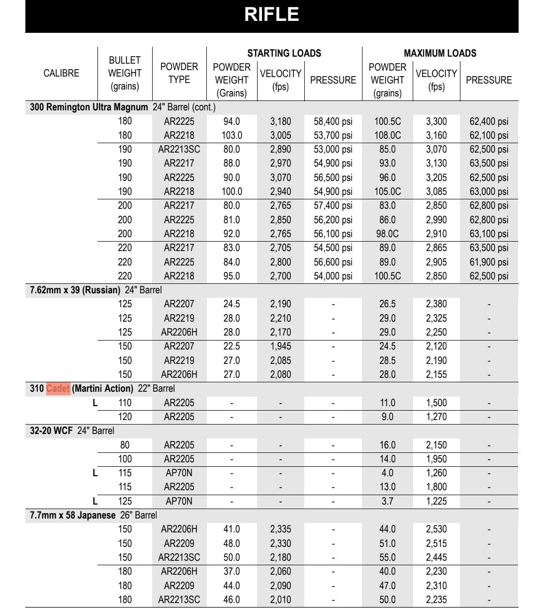

Post by Oldbloke » 25 Jan 2025, 5:00 am
From the 2010 ADI Manual
