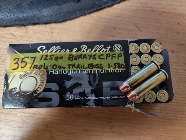

I gave up trying to track case life very early on. If I want to know how long they're likely to last I set aside ten and shoot those as warmers every time I go out until they start to fail. It still isn't very helpful though unless you have some way of keeping your brass all separated. If I were only reloading for one firearm I could probably keep a bunch of tubs with brass that's been loaded once, twice, three times, and so on up to 50+ tubs in some chamberings, and a pile of ammo boxes with loaded ammo that's been fired once, twice, etc. But it really isn't viable as it would fill a wardrobe for each chambering. Now, if I were shooting competition and fired the same amount of ammo every time I went (like a 65rd Centrefire handgun match every week) it is viable that I could load a little more than I need (to allow for failures and losses), and fire any left overs at the end, then just load the same complete batch every week. But even then it starts to fall apart eventually. Say I'm loading 70rds every week, and I'm up to my tenth load, but at this point I've lost six cases (lost in the grass, somebody else picked mine up, I crushed one during loading, etc) and only have 64 left. Do I put them in a tub and start another batch and when they're up to ten firings then I combine both batches into a 134rd batch? Do I add six new pieces to the tenth-fired batch? Or do I simply load 2000rds, toss the fired brass into a bucket and reload them when I have enough to warrant a reloading session without worrying about how many times they've been fired?
I loaded 100rds for my mate last night. On the boxes I just record the bullet, the charge and powder, and COAL, that's really all I need to know when I'm getting ammo out to shoot. With this batch I did 50rds with the FCD and 50rds using the seating die to crimp so I can compare the finished results, so I noted "FCD" on the box. For what it's worth, it does save some time crimping with the seating die and the ammo looks just fine, we'll leave a couple of the seating-die-crimped rounds in the magazine tube and see if the bullets stay in place after being in there for forty shots.
In the logbook for the firearm I record the brass, primer, bullet details, powder and charge, COAL, and for precision loads the jump and ogive length. When I test them I add further details: the range I'm zeroed, the range I'm shooting, how many in the group, group size, group position (how far high/low, left/right of the zeroed load), velocity, ES, SD, and notes about what I was actually doing and anything unusual that happened - scoped or irons, shooting position, environment, etc.

"I gave up trying to track case life very early on."
Same here. Just too hard.
Just box them up in lots of 20-25.
I sort brands and have weighed a small sample of each brand. If a box is short 1 or 2 I'll use cases that are close in weight.
Not trying to head shoot rabbits at 300 yard tho.

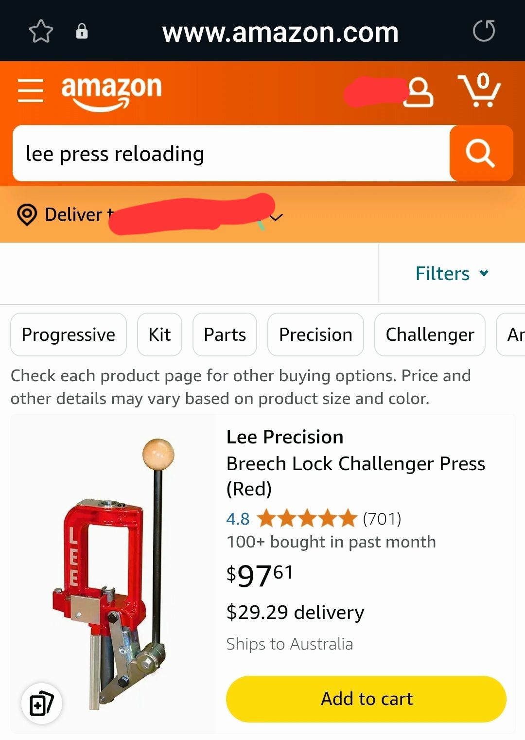

Post by Oldbloke » 19 Dec 2024, 1:25 pm
Robin,
This looks like an exceptional deal on Amazon. AUD too I think as I was logged in.
I think RRP is about $230
Re: Reloading press

Oldbloke wrote:Robin,
Too be honest, I didn't even think of Amazon, will have a look.
Robin

Re: Reloading press
Post by Oldbloke » 19 Dec 2024, 8:27 pm
:thumbsup: bloody bargain
